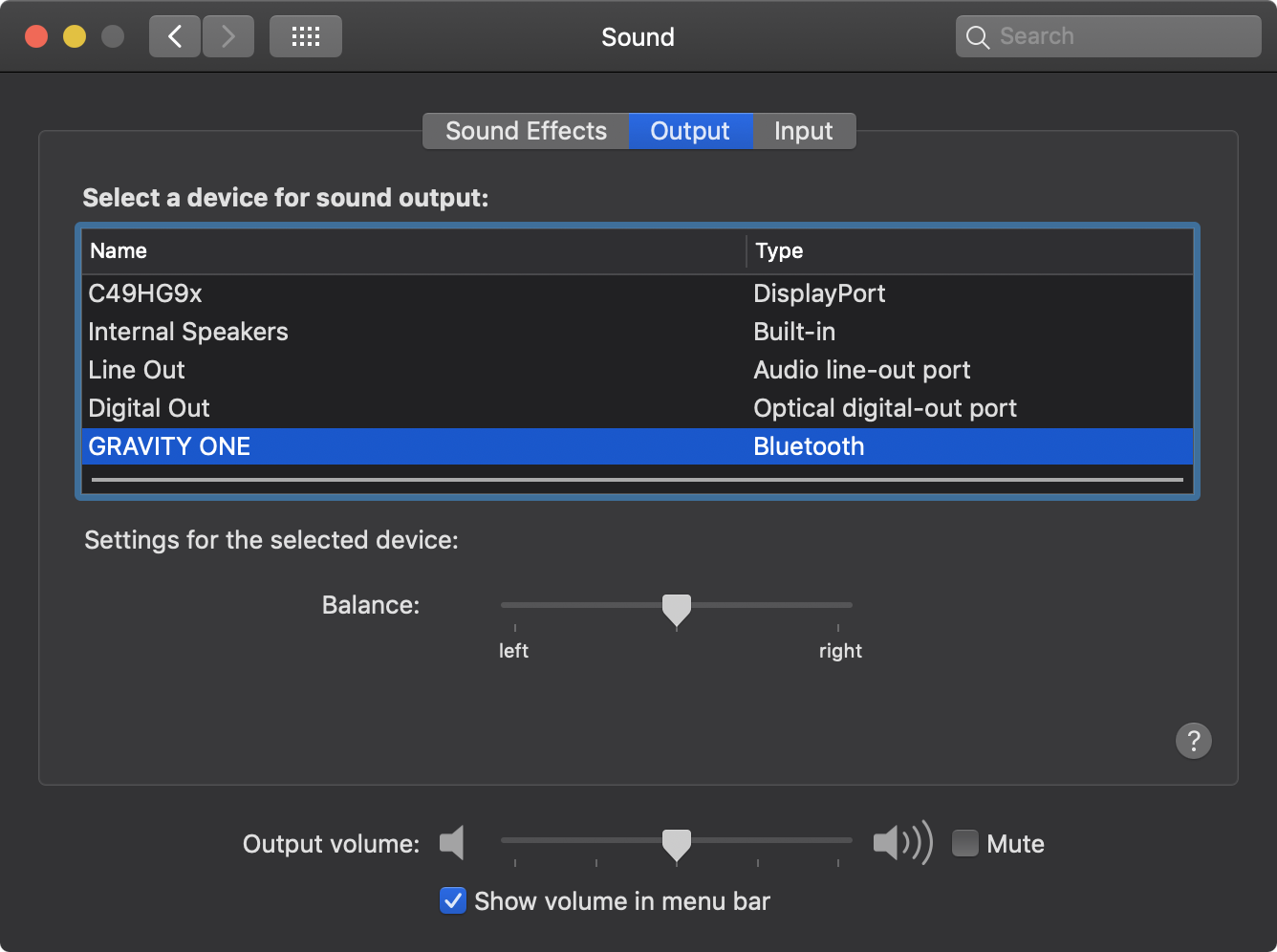

Wait, so you're saying with analog one channel is louder than the other. Isn't that the same problem you said is happening with the digital out? Maybe the problem is your speakers or amp? Have you tried connecting a different set of speakers or just a set of headphones to the analog output to see if the audio is still affected? If it is then you should check the "Balance" setting in Sound Preferences.
The problem is I intermittently lose stereo sound (i.e. one speaker is a lot loader than the other) with standard line out.

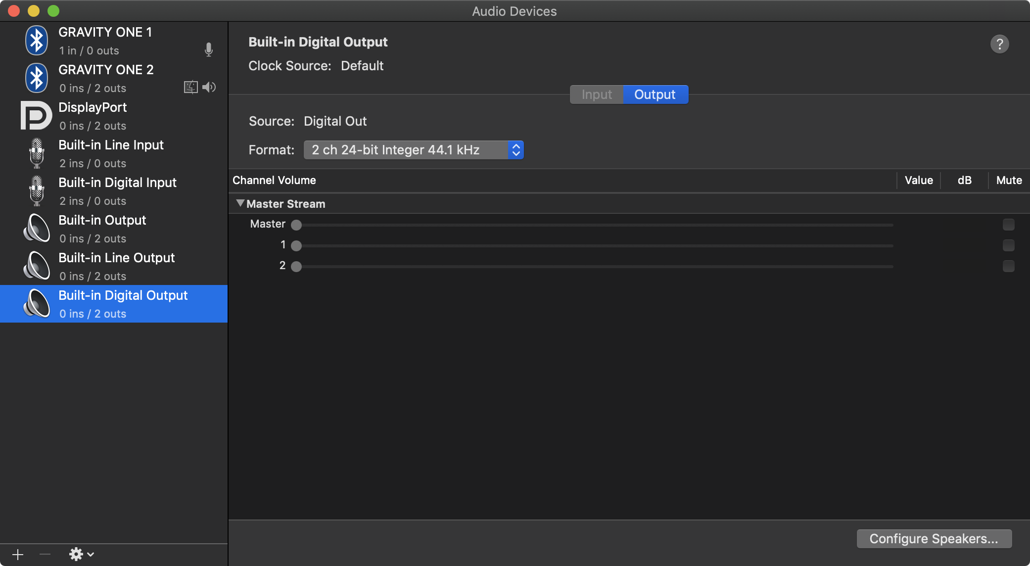

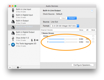

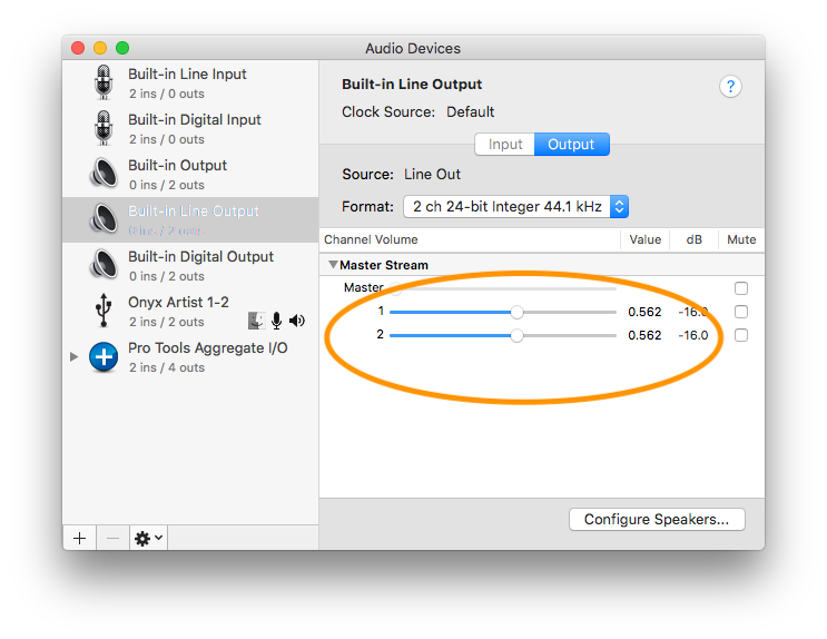

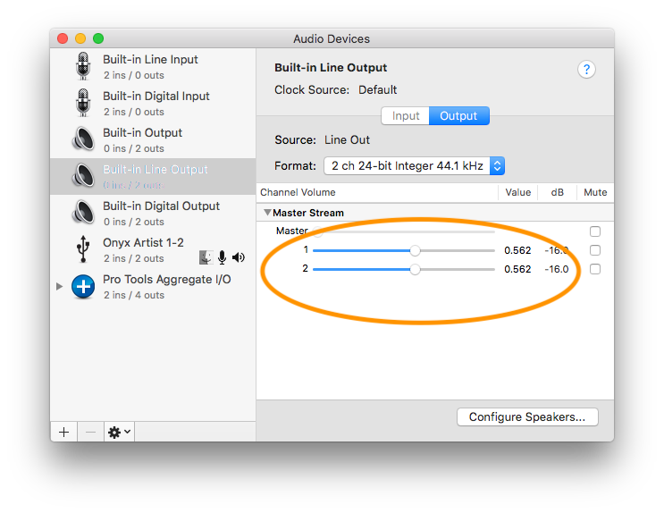

Have you checked if both outputs are set at the same volume in Audio/MIDI Settings?
