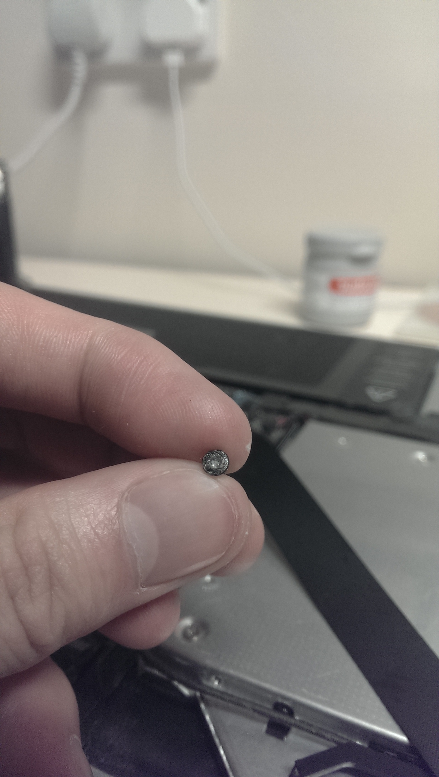

I've also stripped the two screws as labeled above on my late MBP 2011 17 inch.

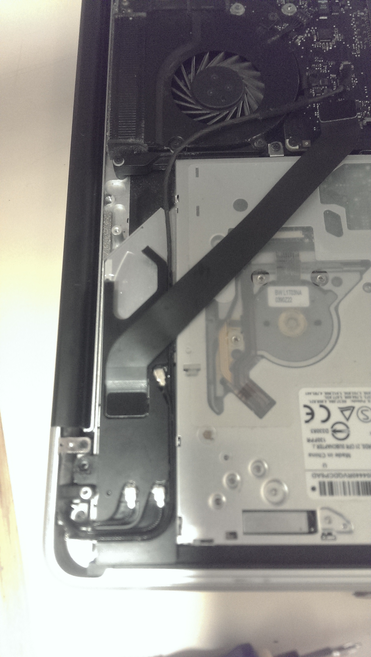

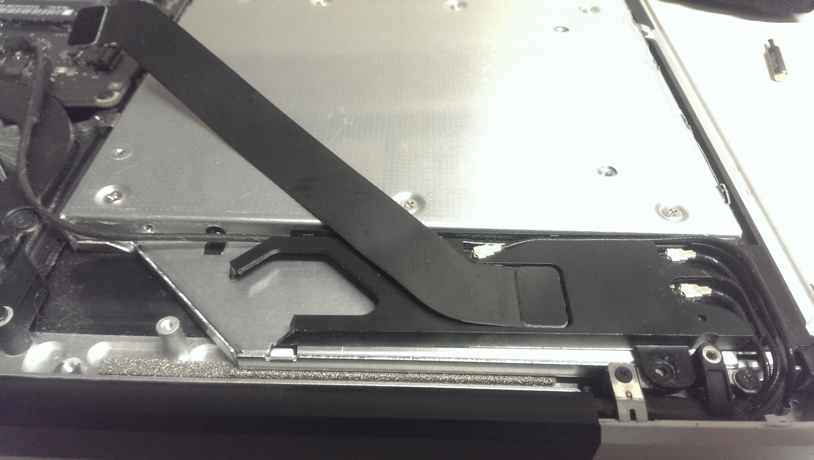

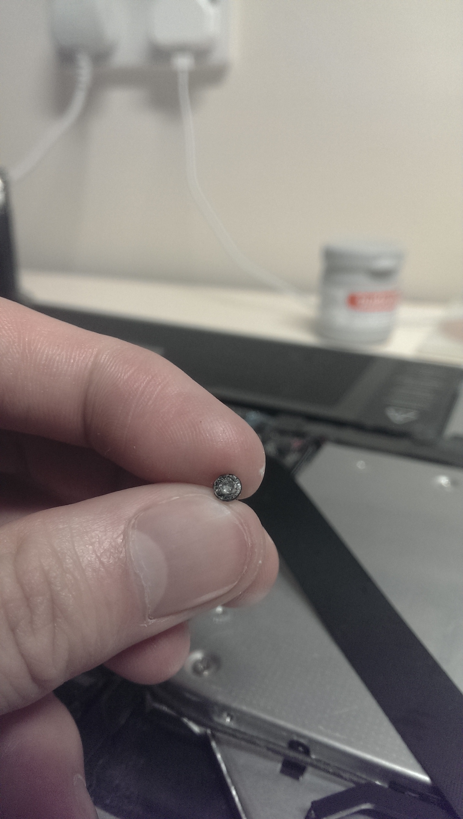

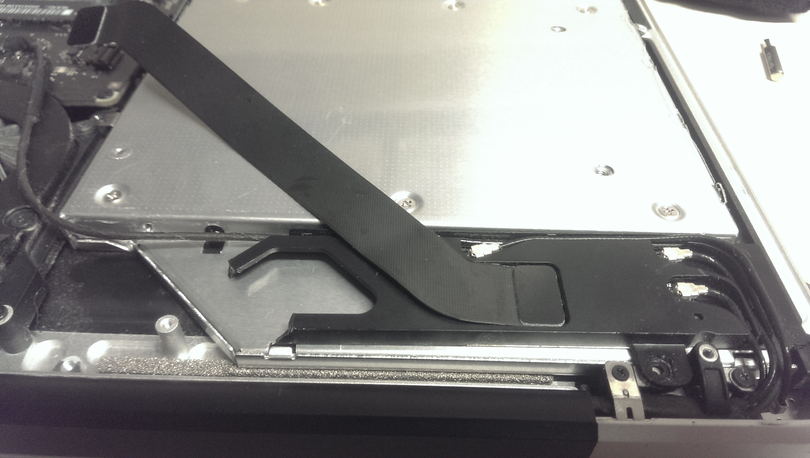

New Solution

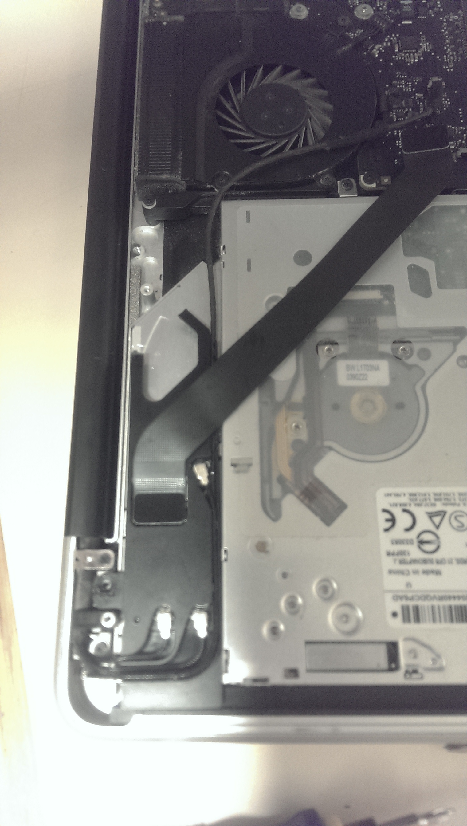

I was helping a friend recently and in his case both of the screws were stripped to the point of no return. I found that if you snapped the part of the bracket where no antennae were then swung the bracket round the screws could be removed. Just be careful swinging the bracket round because the airport and bluetooth run through the plastic part as well.
I hope this helps people.
