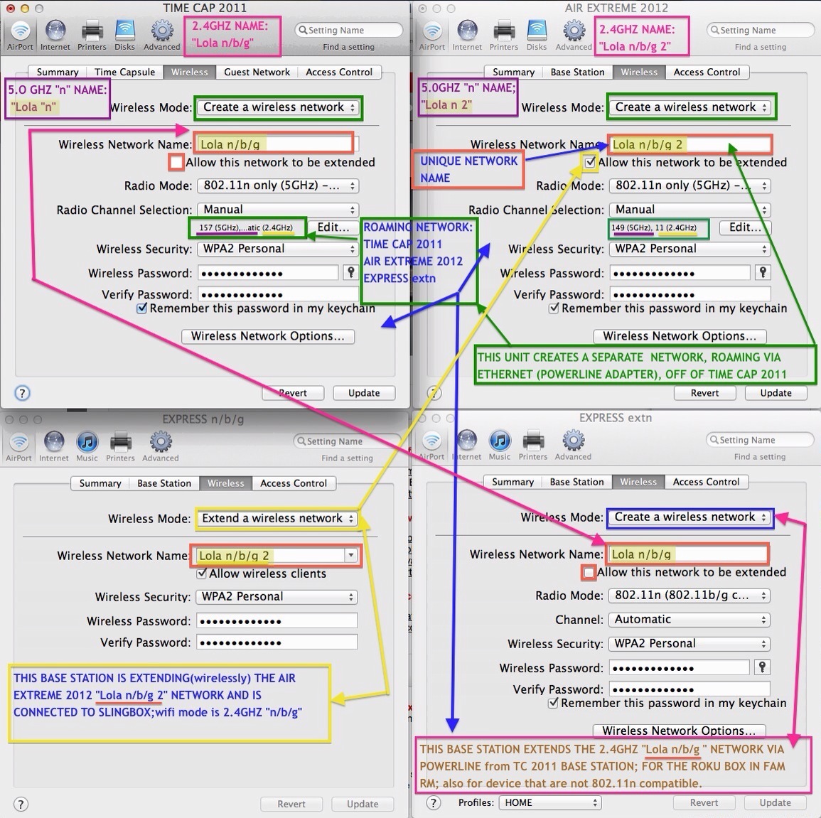

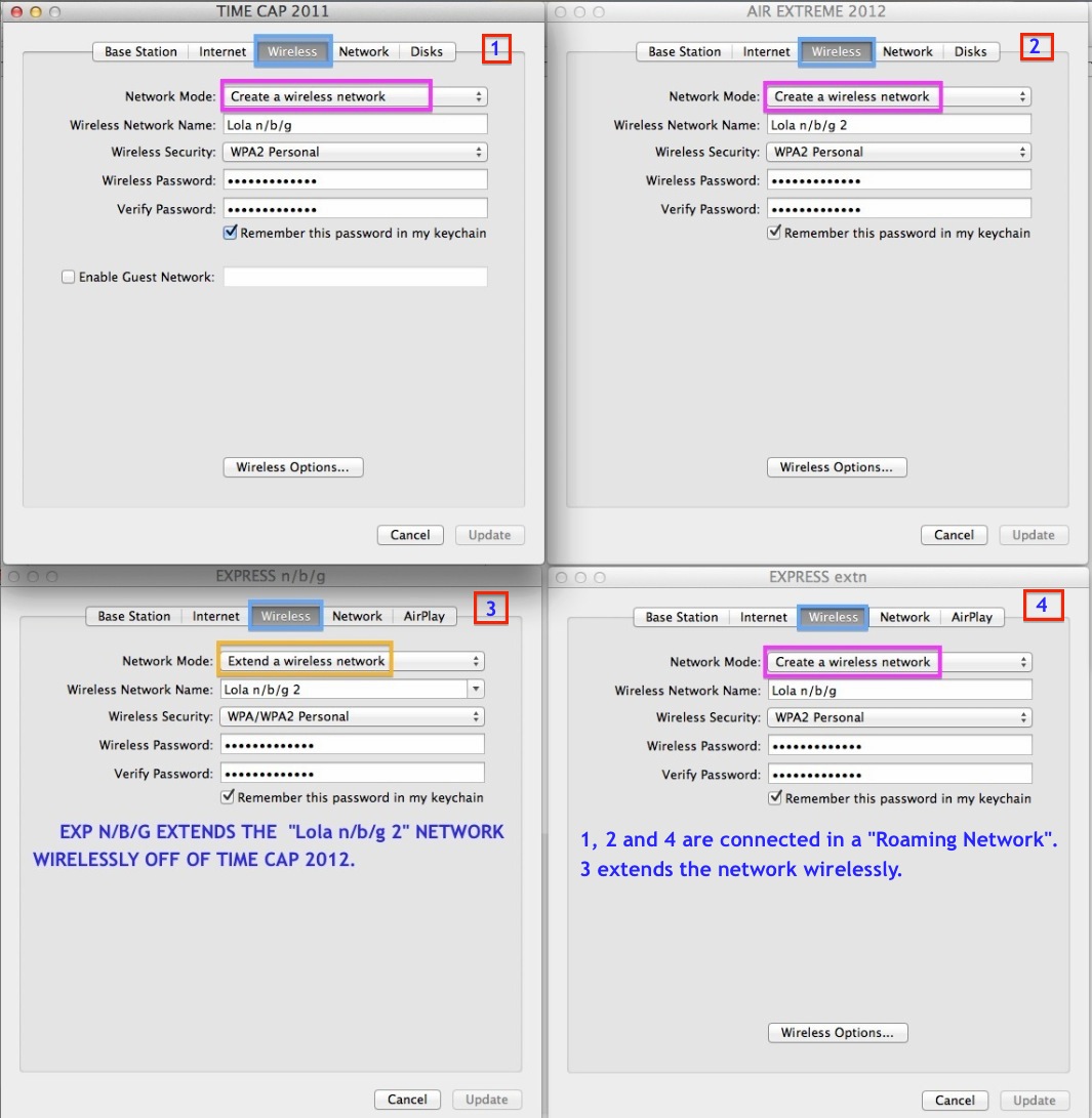

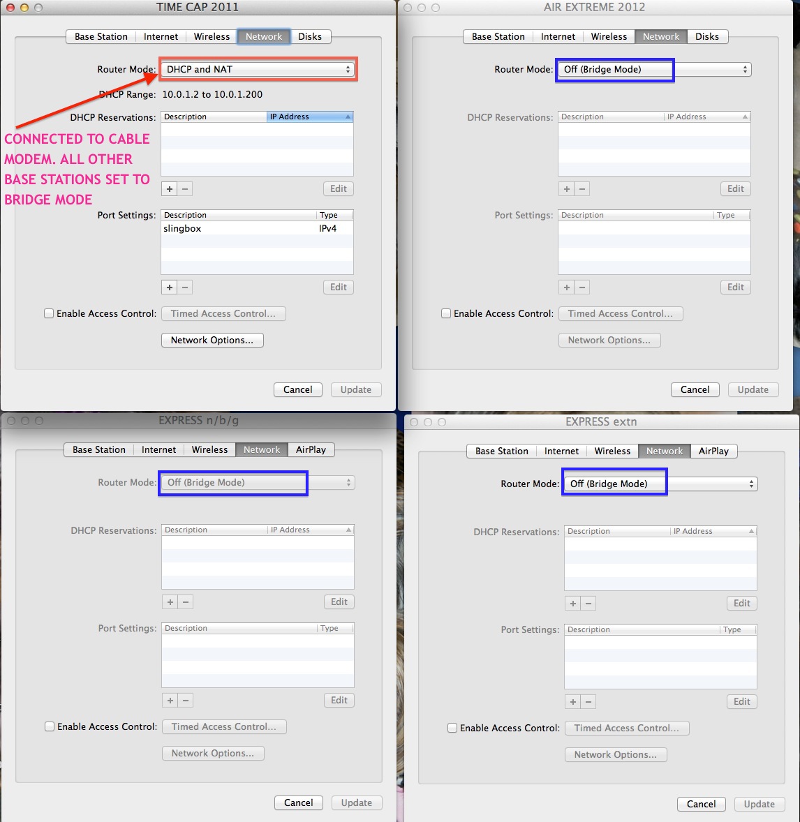

With my setup, I actually disabled "NAPT" in the Moto SB. You can find instructions to accomplish this here:
http://broadband.custhelp.com/app/answers/detail/a_id/20836/kw/disable%20NAPT/session/L3RpbWUvMTMwNDk3NzYzMy9zaWQvVVZqVnh5dGs=
My Airport Extreme'S NETWORK settings are "DHCP and NAT" (it's connected to the Moto SB), and I have 3 other base stations set to bridge mode. Note: I need to include "NAT" for my slingbox, but you could set yours to just "DHCP". My setup would be different from yours (because I need 2 different networks), but the method is the same. You can either extend wirelessly, or via ethernet, in a "Roaming Network". Roaming provides far less degradation of signal. Mine is a combination of the two (view each image in a separate tab to see clearly):
Network settings:
NETWORK:BRIDGE MODE.jpg
Hope that's clear. It really works for me, as I find the Moto Surfboards wireless range was much shorter than the Apple base station.
Edit: I must stress that the hard-lined method, even if you use Powerline Ethernet Adapters, is the way to go, especially if you want that stronger signal for your neighbors - see my link to an older post above.

I just found this detailed diagram/screenshot I made for another person I was assisting with a similar setup. Note that in the Wireless setup, the base stations must be set to different channels, if "Automatic" mode is not selected, preferably a min of 5 numbers apart for "n/b/g, or further for "n"/5.0 GHZ :
attachment.php
edit: "Allow this network to be extended" is only checked when the network is extended wirelessly. With the "Roaming" setup, it is left unchecked.
