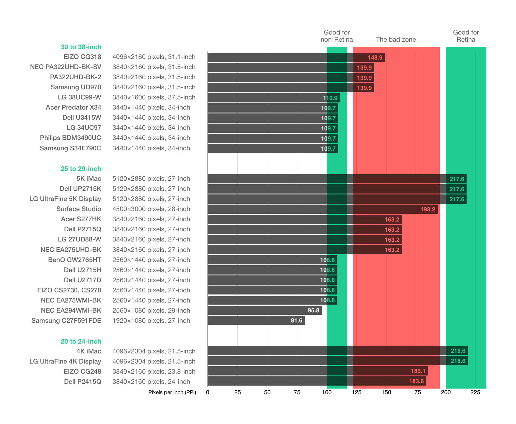

I'm also looking for an external monitor for my new MBA M1. This is my first MacOS device, coming from Windows and the monitor still will also be used with Windows (beside the MBA M1), I was used to higher DPI gives you better results, 4K should be better than QHD. 🙂
I can't go bigger than 27" on my table, thus if I get the picture in the original post right, I should avoid 4K and go with QHD?

I would buy a 4k monitor. That's 163 ppi which is still quite sharp. There used to be some noticeable performance hit when doing non-integer scaling, however with M1 that's not really of major concern for most uses. QHD will look terrible in comparison to the extremely subtle softening of edges when scaling at other than 2x.
Personally I find my 4K (3840x2560) 28" display works very when 2x scaled (1920x1280), although at 165 ppi it's in the theoretical bad zone.

That bad zone only matters if you’re concerned about having “like on a 110 ppi monitor” size of UI elements, which would necessitate scaling unless your display is 220 ppi.

Thanks guys. So this means for me targeting a 27" screen: Let's go 4K and basically ignore the bad zone thingy if I'm not concerned about the size of UI elements? If so, this helped me a lot to not make a wrong decision. As I want to have USB-C PD,currently targeting a Dell U2720Q or Dell P2721Q, with I guess the U2720Q being the better "technical" product.
What happens if I don't scale by 200% but non-integer e.g. 150% to have more screen real estate towards 2560x1440 with a 4K monitor and a MBA M1? Scaling issues resulting in really visible font blurriness?

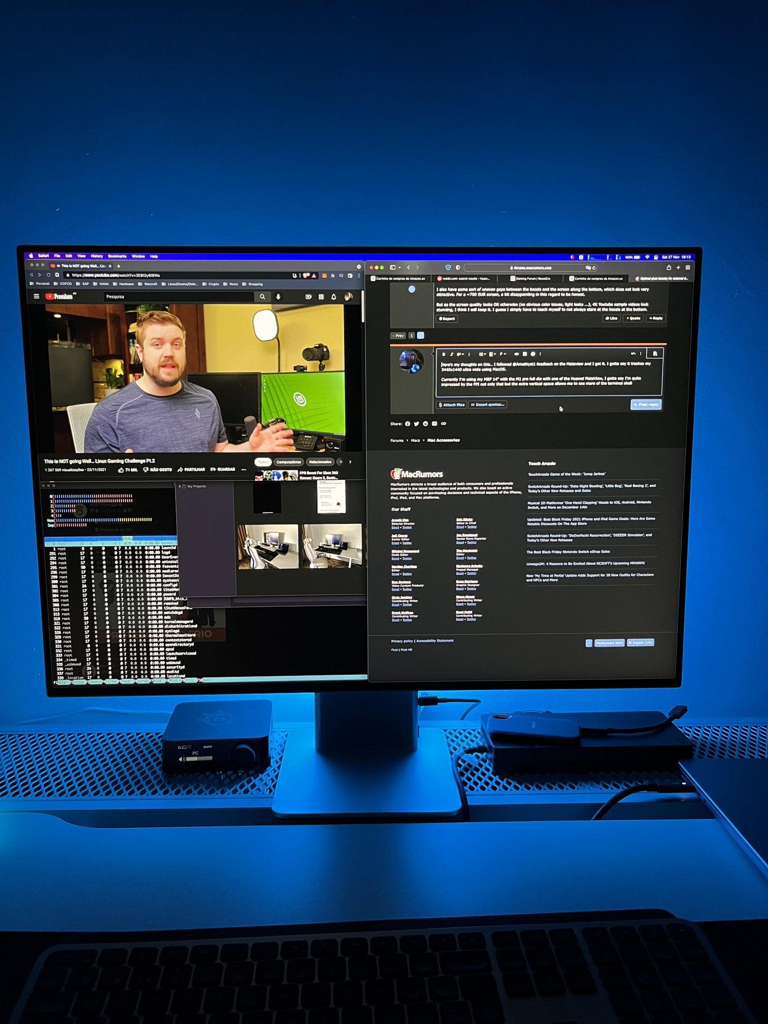

Here's my thoughts on this.. I followed @Amethyst1 feedback on the Mateview and I got it. I gotta say it trashes my 3440x1440 ultra wide using MacOS.
Currently I'm using my MBP 14" with the M1 pro full die with one of the Huawei MateView, I gotta say I'm quite impressed by the PPI not only that but the extra vertical space allows me to see more of the terminal shell.
Ok so thoughts about this? I upgraded to one of these to try it out I wanted a 4K screen but tons of people complained about issues with the LG and Philips monitors so I went ahead and got it.
I really like it and bought a 2nd Huawei MateView to put next to this one.
Honestly I'm gonna stick with these until Apple releases their own displays whenever that is.

I guess it pretty much boils down to whether you are dead set on running pixel-perfect (in that case, the 220 ppi ballpark is where it’s at) or okay with scaling and its “peculiarities.”
In any case, 164 ppi still beats the crap out of 110 ppi as you’ve noticed. 🙂

Apple’s interface design in macOS is set up so it is comfortable for most people at a density of about 110 pixels per inch for non-Retina, and about 220 pixels per inch for Retina — text is readable and button targets are easy to hit at a normal viewing distance. Using a display that isn’t close to 110PPI or 220PPI means text and interface elements will either be too big, or too small.
is this thing still relevant today?
This table is not the most accurate thing in the world.
As you are well aware, the screens of new Macs are around 255ppi (128ppi in hidpi), and according to this table, they would be in the "bad zone", which is simply ridiculous and belies the theory that the default scaling of macOS is 110ppi. Macs have been using resolutions for years that result in far above 110ppi.
The point is, 163ppi/2 ~= 82ppi can be extremely comfortable for the eyes, which 110ppi might not be (depends on the user's vision).
Just like 110ppi can be too low on screen real state, but 140ppi can be a lot. Depends of your needs.
Don't prey on those tables and numbers, test the thing for yourself.
Having a 27" 4K scaled to 1440p or 1600p is much better than having those native resolutions.
The “switch” to 255 ppi only happened recently and this table hasn’t (yet) been updated. Best to never take any info on the web at face value anyway.
Was it ever really? The rule is once you see the individual pixels, you have either too low resolution or sit too close to the monitor. Usually anything above 130ppi should be okay as you can scale the UI however you like with 3rd party software.
That chart of yours doesn't make sense, 109ppi looks bad on modern macOS and definitely isn't "good for non-Retina" as the whole UI is deliberately designed to look bad on non-Retina displays.
This is true for the last couple versions of macOS. Before that, it used a subpixel smoothing system that could be tweaked from the system preferences panel to improve appearance to taste. This no longer exists, so we're pretty much stuck with high-DPI displays. Granted, in 2023, that's not really much of an issue any more, but there are some instances where people would prefer not to use a high-DPI display (like some of these ultrawide displays that have vertical resolutions of only 1440 or 1600)
