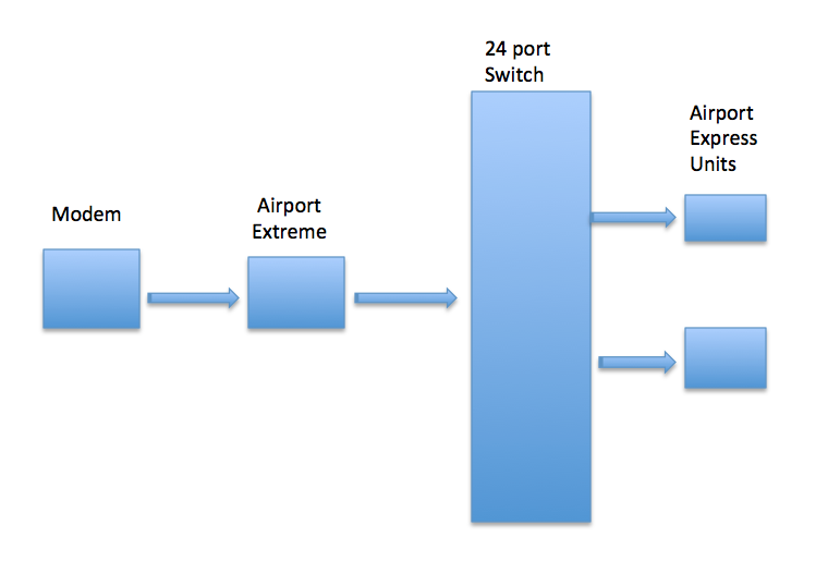

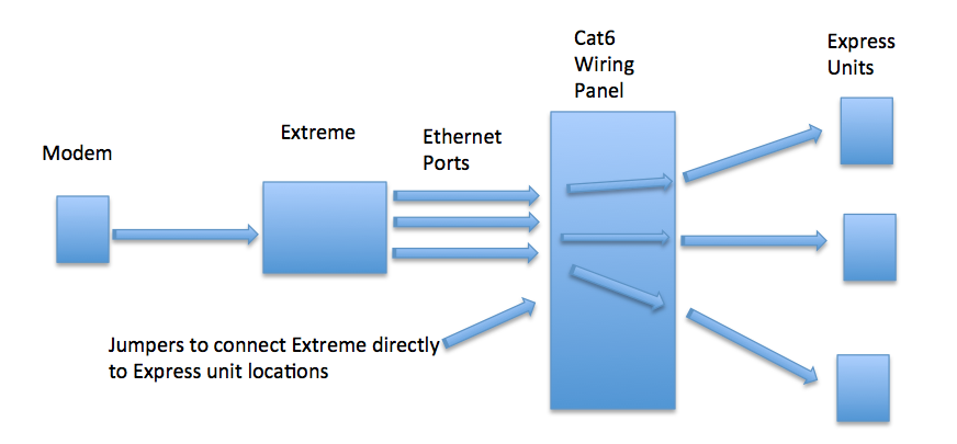

Just to be clear, do I run the Express units off their own (separate) wired connection or off one of the ethernet ports on the back of the Extreme? I can do either as the Extreme is on the top floor in the A/V closet right next to a 24 port switch and wiring panel. I have both examples below.

I'm not a fan of daisy-chaining unless absolutely necessary. I always try and give WiFi access points their own individual LAN connection back to a switch.
I also would put the modem behind one of the AE units, not directly connected to the switch. Which one of the AE units is doing the actual routing ? Use that one.

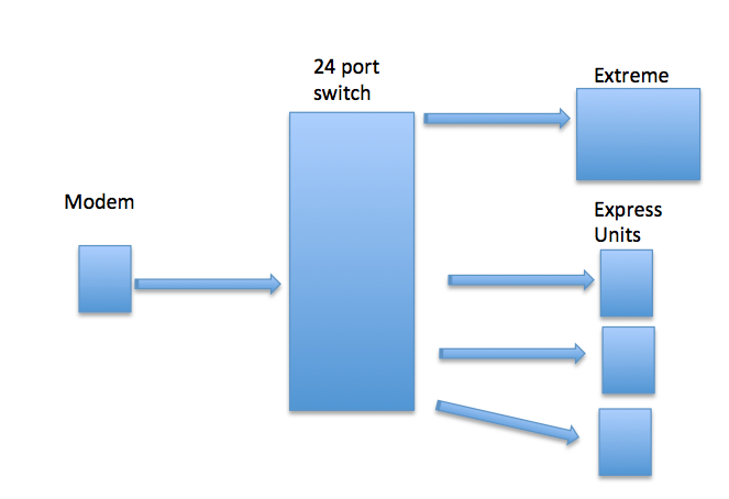

Sounds like the best way is to free up the ports on the Extreme and just run each Express wired to the switch directly at each location. Basically, the Extreme and all Express units are connected to the network independently instead of the Express unit tied into the back of the Extreme.

Yes, pic1 is fine.
Did you edit your post or was that an IM? My apologies if it was an IM and I am responding here. Regarding your question.....the question about wiring the express units to the switch. I assume the express units located throughout the home directly wired to the switch would be best instead of trying to extend wirelessly.
Now that I gave it more thought, I think I might have been a little vague in my original posting. I have a 24 port switch in the A/V closet on the top floor installed in the control panel. From there, every Cat6 outlet in the home is connected in that panel to the switch. That allows me to have a live connection at every wall plate throughout the home. If I connect the express units at those wired outlets at strategic locations throughout the home, theoretically I would have the best signal everywhere, no?

Connecting the AEs to the switch so that they have individual direct links is indeed the best option.
Regarding the mode of setup, you need to create a WiFi network at each AE but create the SAME network at each. The same SSD, security etc. That way you will have a roaming network that allows you to wander around with a WiFi device and always connect. Don't extend the network as that will involve reduced data rates and from other forum threads might give you setup problems.

Your first image isn't going to work if the AE is your router. If your AE is going to be in Bridge mode it would be OK. If the AE is in Router mode, then the AE needs to plug directly into the modem (via the WAN port on the AE). Everything else needs to come off the AE's LAN ports - including your Ethernet switch if you need more ports than the AE provides directly.

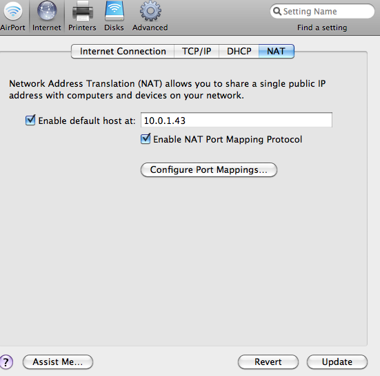

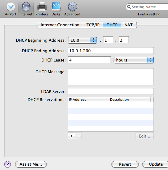

FYI...here's what the two options currently look like. **again, thanks for your patience 🙂 **

ps. just re-read your post and I'm not entirely clear what DHCP/NAT mode is. On my unit they are separate and the settings within I am not educated enough on to know what I'm doing :0
right now it's on the "internet connection" option
Airport Utility>Network>Router Mode>DHCP and NAT. Select this for the main unit. Then set a network address type (e.g. 192.168.123.X) in Network Options. The main unit will assign itself 192.168.123.1. Set a range of addresses (e.g 192.168.123.2 to 192.168.123.50) and a lease time (1 day). Make sure Enable NAT Port Mapping Protocol is checked.
You beat me to it. My Airport Utility looks different on OSX - it's V 6.2, but covers the same stuff. I don't have < Enable default host at > checked. What do you have at 10.0.1.43 ?
If it was me I would want to find out why it was enabled in the first place. Did you do that or did some automatic setup process do it ?
From what I can remember, that IP address was used for one of the Directv boxes. They each have their own IP address on the network. I think the spread was .2 to .50 which is where that .43 came from. But honestly, not sure.
