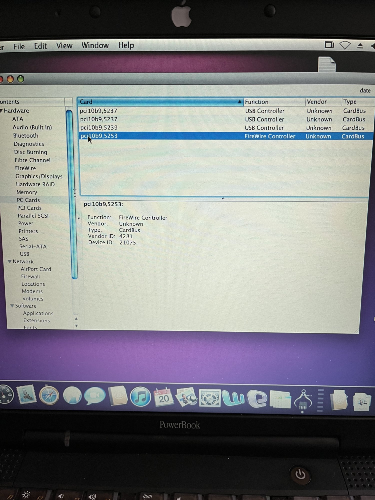

Since you are very knowledgable, I was wondering if there is a way to bring better FireWire compatibility to 10.2.
I have a FW/USB card that I bought to use with my PDQ and hopefully a future Lombard. The card works fine in 10.4 and 10.5. I have not been able to get it to work in OS 9.2.2 (though I think I am going to keep playing with extensions) and 10.2.
I am not a hacker by any means, but is there a way to bring 10.4/10.5 FW drivers over to OS 10.2? Or maybe there is a third party program that improves FW compatibility. I have been searching on Google with no luck so far.

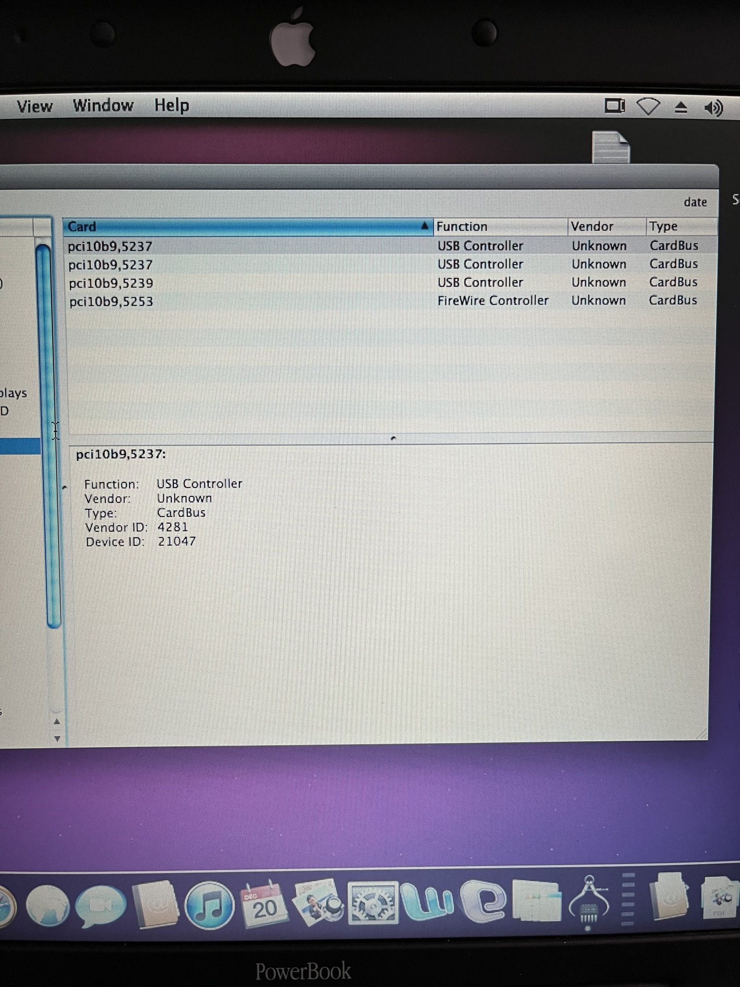

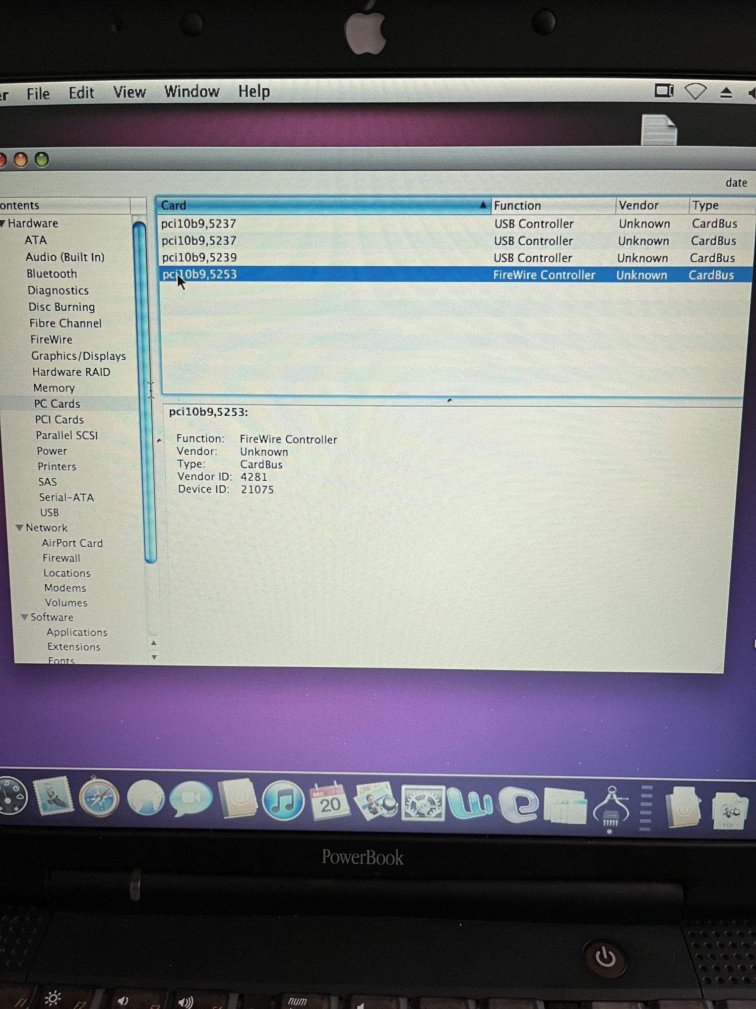

What chipset is your FireWire card using? Plug it in while running 10.4 or 10.5, fire up System Profiler and then look under either the Cardbus (if there is one, can't remember) or PCI Cards section. The vendor and device ID allow identifying the chipset and checking if drivers for 10.2 exist.
Simply copying over the FireWire kexts from 10.4 or 10.5 is unlikely to work because they may well depend on other kexts or kernel functions not present in 10.2, and the more you simply copy over, the exponentially higher the chance of something blowing up. 🙂

Here is the info
https://pci-ids.ucw.cz/read/PC/10b9/5253 <- This is the FireWire chip, an ULi M5253 P1394.
https://pci-ids.ucw.cz/read/PC/10b9/5237 <- This is the USB 1.1 chip.
https://pci-ids.ucw.cz/read/PC/10b9/5239 <- This is the USB 2.0 chip.
Thanks, I used the info to find some old discussion posts on Apple. It looks like it might work in 10.3. I can put 10.3 on my PDQ using XPostFacto, but I don't know if that is a good idea considering it is such a low spec machine to begin with. I am looking for RAM that will work with this computer. Maybe that would make 10.3 tolerable. I only wanted to put OS X on here to try and get this PC Card to work.
