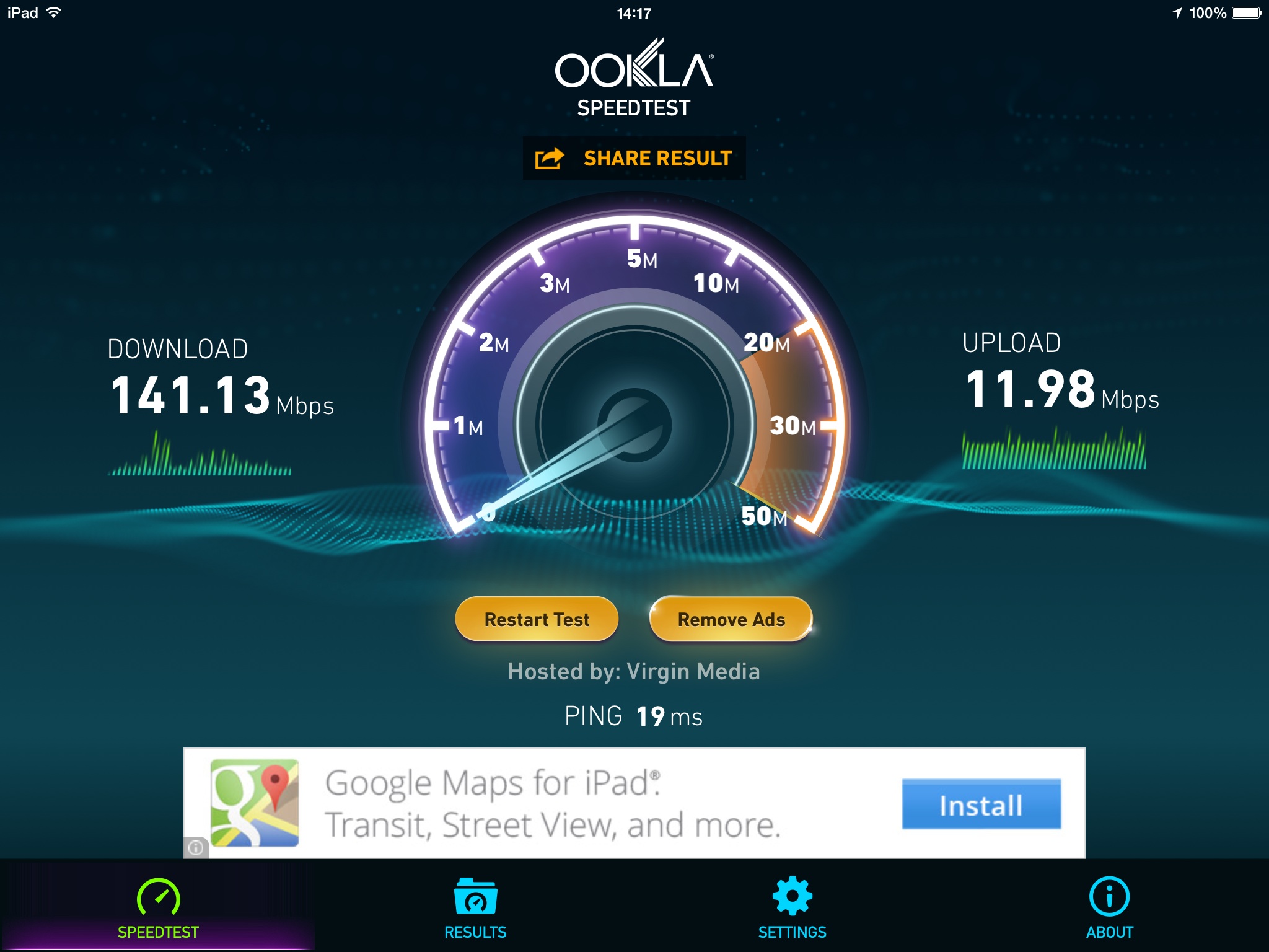

I'm using the last generation TC and a generation 5 AirPort Extreme. I have a very fast BB connection, but found that by changing channels on the TC's broadcast made one heck of a speed difference.
Set to auto, my 2.4 GHZ speeds ( which I only actually use for an internet radio that can't see 5GHZ) we're around 49MBPS
Setting to channel 6 on the TC now gives me wifi speeds almost exactly the 160 I get over Ethernet on my iMac....
The 5GHZ channel runs on 44.
It's worth changing until you find the best traffic free channel for your area...the SS is from my iPad Air.
