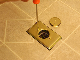

If put in discreet locations the holes are not a problem. Ever see the brass outlet plates set I to floors with screw on caps why not in use? Look very nice on hardware floors. I used one of them behind my entertainment center to run coax and cat5 to the basement. Saved me from messing with the insulation in the outside wall. If we move things all that's left is a nice brass plate.

Can you show me a picture of what you are referring to when talking about brass plate?
This is similar to what I used:
Just Google "brass floor outlet" and you will get a bunch of images and references.
