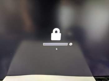

I'm running a MacBook Air (mid-2012) with the latest OS X. I have my hard drive partitioned to run Windows 7 in BootCamp, which I access on occasion by holding the Option key when booting up, allowing me to choose the startup volume. Recently, I used Find My Mac to Password Lock my computer (this was to test the functionality, not out of necessity). The computer froze and became unresponsive, so I performed a hard reset, after which it continued to run without a problem.
Now whenever I Option-Boot, I am greeted with a Password Lock screen, which the four digit PIN that I set from Find My Mac opens. There are no other options, it is just a plain grey screen with a password lock.
I have no idea how to remove this, and it only happens when booting using the Option key.

Yep I have successfully entered the PIN many times (every time I Option-Boot), yet it keeps coming back. I also tried remote locking again through iCloud and re-authenticating, yet the issue persists.
This passcode lock is different than the standard iCloud lock, as there are no other options on screen and it only occurs when Option-Booting.
FYI - this is the screen that I get

That looks like a firmware lock. Remove/Replace your RAM to see if that old trick works to clear the lock.

With that said, that's definitely the EFI password screen. You can enable/disable it from the recovery partition, using the Firmware Password Utility found under the Utilities menu.
The problem though is that if you don't know the EFI password you can't hold "R" or use "option" when booting to get to the recovery partition. If you're comfortable using the Terminal you can use a few simple commands to tell your MacBook Air to boot to the recovery partition on only the next boot....

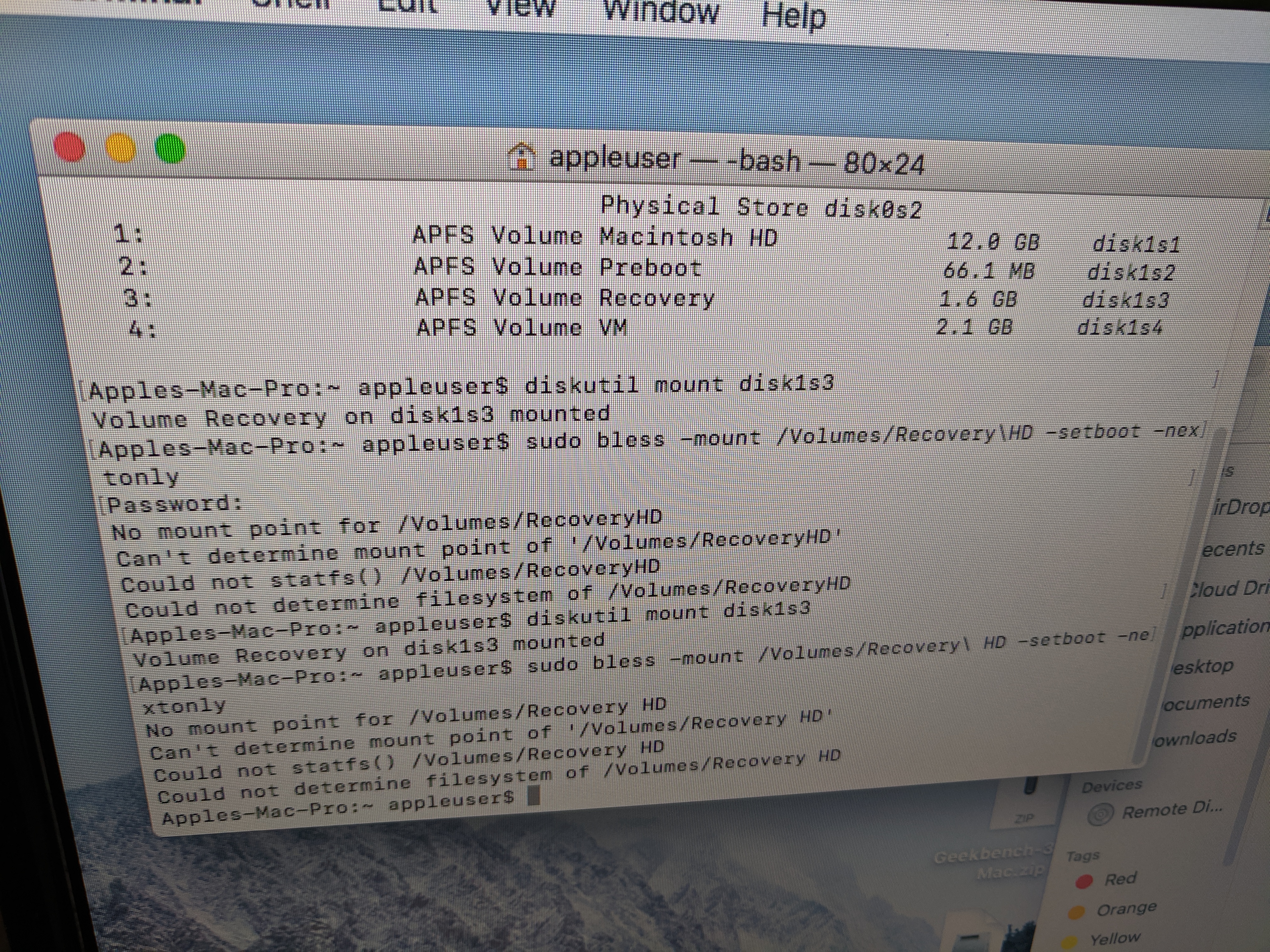

I have a mac pro 2013 with an AFPS flash and on it a High Siearra, when I try these steps it says as pictured.
Any other way to clean out this boot option lock?
I bought it on eBay and got it with a lock...

Next you'll want to actually mount the Recovery partition, using the disk identifier you found above, in this example it is disk0s3.
Code:
diskutil mount disk0s3
You should now see your Recovery HD partition mounted on your Desktop or in Finder.
Now we'll tell the Mac to boot to the Recovery partition, which should allow you to go in and remove the EFI password. Again, in the example the partition name is Recovery HD but yours may be different.
Code:
sudo bless -mount /Volumes/Recovery\ HD -setboot -nextonly
The bless command is enabling the Recovery HD volume to be used as a boot drive, the setboot flag tells your Mac to use it as the startup volume and the nextonly flag tells your Mac to only apply this command for the next boot, subsequent boots will revert to the original startup disk. You'll be asked to enter your password, once you do so and hit enter the change will be made.
You can now shutdown your Mac, power it back on and it should boot directly to the Recovery partition, where you can find the Firmware Password utility under the Utilities menu in the menu bar.
Hello bro, plz help me too i dont know if u still on this platform or not but i have the same issue on my imac 2012. I did bootcamp for window 10 and got this lock screen plz help me too
