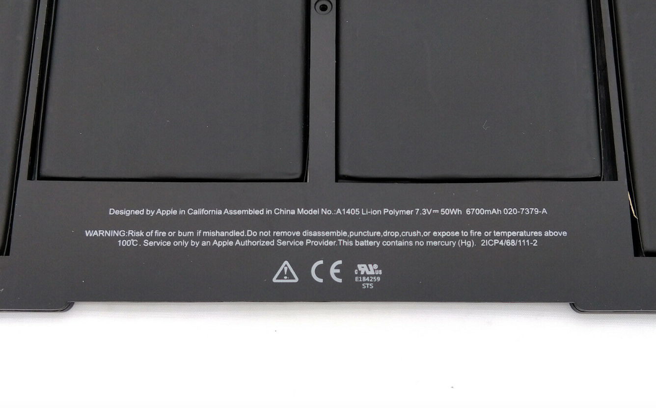

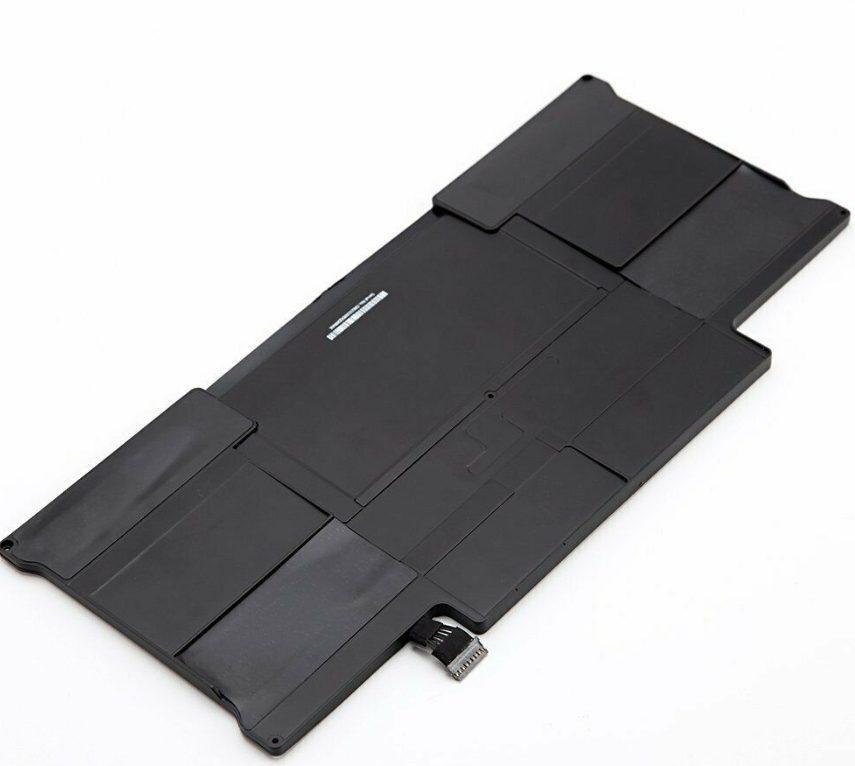

The eBay seller has this so called genuine battery:

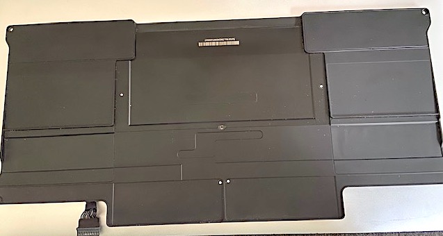

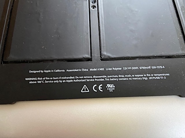

But the original laptop battery pulled from the lot of 25 MBA looks like this:
They look very close - almost perfect like the original ?
Would you trust it ?
So if I can find batteries for them, how do you tell if they are legit or real ?
Close almost perfect like the original ?
Appears to be close to it as you say and it has the Apple specification on the label so could be it. Yes I would think it would be worth getting a few for testing it out. But then again I would be waiting for the perfectly usable batteries already there to start dying before thinking replacement.
Agreed. These look very close and might be the genuine item. Since you're getting 4-5 hrs the existing batteries still have enough left in them. I'd use them up completely.
