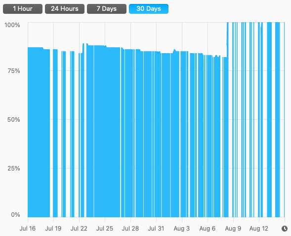

After several weeks continuously plugged in, I started to notice the indicator going from 'Charged' to 'Paused' and day by day, my charged level gradually fell to around 78%. I temporarily disconnected my MBP during a reorganization of my desk and it reverted back to the fully charged mode. Been plugged in for ~6 days now, and still maintaining the 100% level. Considering my last MBP (Late 2013 13") was plugged in most of its life, its battery health was still above 90% when I gave it to its new owner. So, not very worried about the weeks long span at 100%, but it would be nice to have a little control over the sensitivity and timing of Optimized Charging. Might look into AlDente if it starts to bother me.

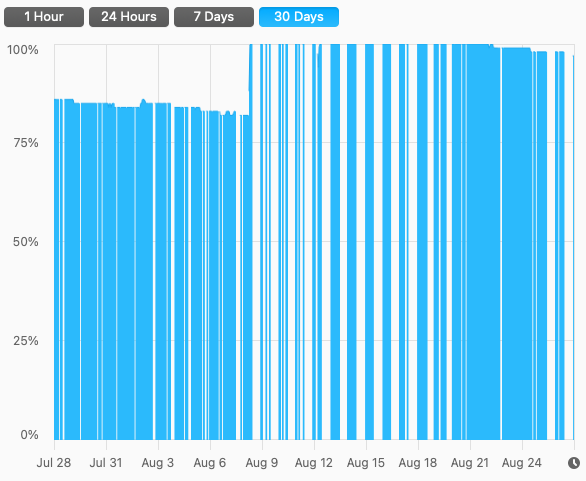

And suddenly Optimized battery charging on my M1 MBA is working again. It took 4 days of being plugged in after the Monterey Beta 5 update for it reduce my charge to 80% (76.1% based on full charge ÷ design capacity). Like I said, the algorithm is very opaque. It should have had months of data to work with so why did it need to wait 4 days after the latest update to decide my usage wasn't changing? Weird.

Just wanted to provide an update documenting the Optimized Charging behavior on my 13" 2020 MBP with Big Sur 11.15.2. It took just about 2 weeks of being continuously plugged in for the algorithm to start reducing the charge level from 100%.
