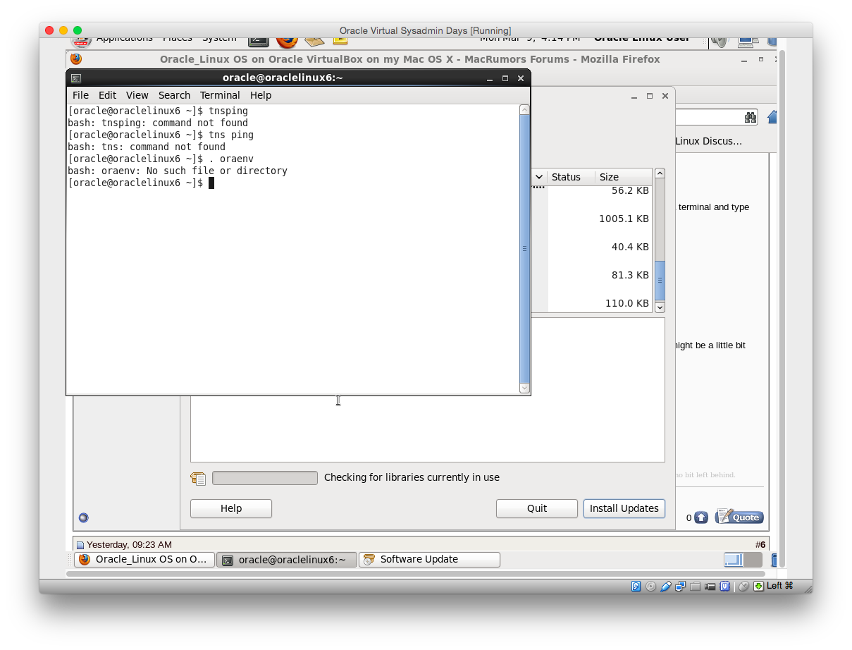

ThankYou for your reply and I am sorry for replying so Late here, Was busy with Projects and Stuff at Office,
But here again, I am attaching an Image File for all of you to see and guide me.

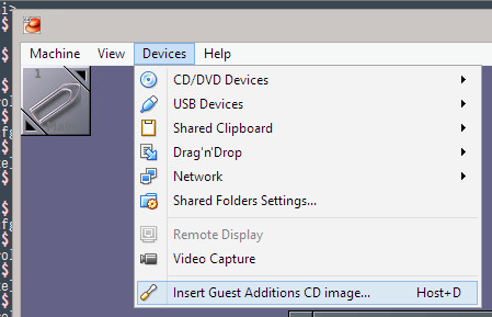

The Virtual Box Guest additions don't have to be downloaded. I'm using VMWare Fusion on my Mac, so I can only tell you how this is done with virtual box under windows. But the procedure should be rather similar.
In the menu of Virtual Box there should be something like "Devices". In this menu there is the Option "Insert Guest Additions CD image". At least on CentOS 7 the image is mounted to

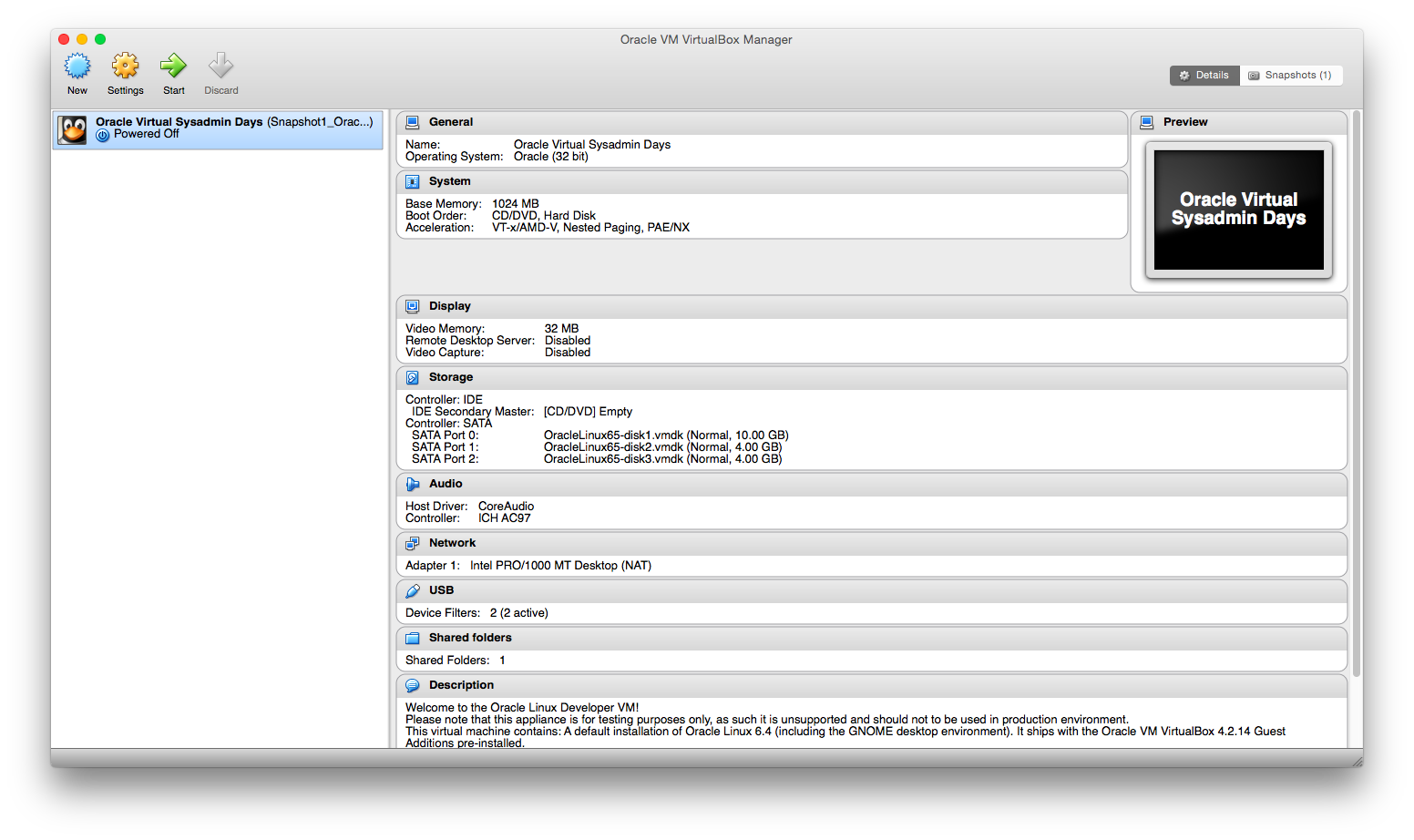

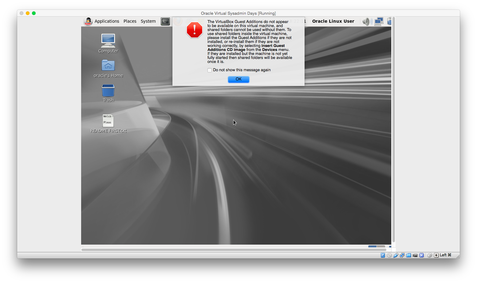

Thanks for the Reply, but this is getting rather too complicated, This is how my VirtualBox Looks like on my Mac (See the screenshot),
1.) Now where can I find the so-called "DEVICES" Menu ? 😕
2.) Coming back to my earlier post (How can I share folder(s) between my Host OS (Mac OS X Yosemite 10.10.2) and Guest OS (Oracle-Linux running under/in the Virtual Box software).

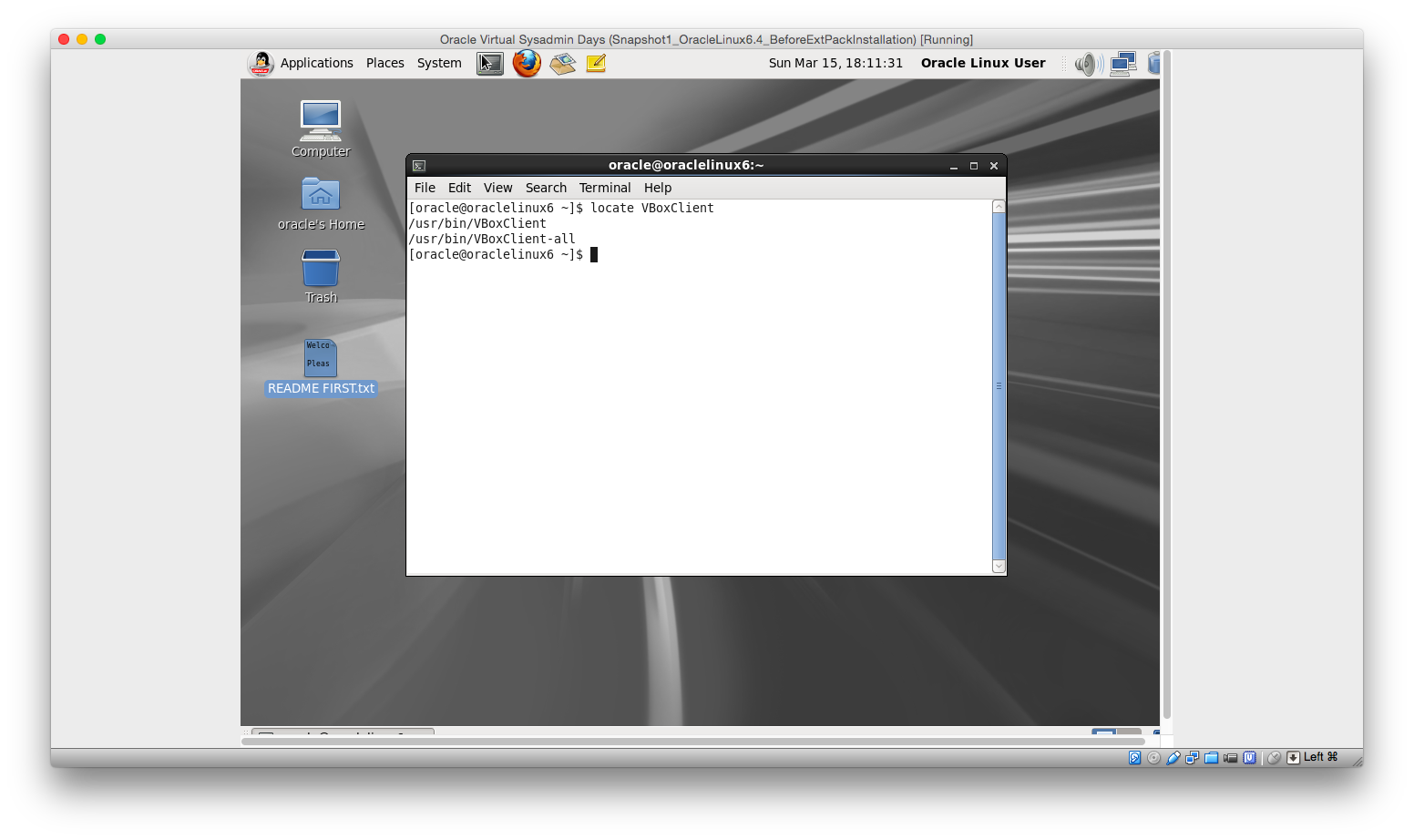

Looking at your screenshot I see in the description, that the VM already has the guest additions installed. Which may be true or not. Perhaps you can try this command:
Code:
locate VBoxClient
If it returns something like /usr/bin/VBoxClient then there is a good chance that the Guest Additions are already installed.

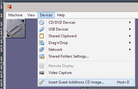

The menu item "Devices" should be in the Application menu bar. Compare this to the windows screenshot. On your Mac this menu should be in the usual Application menu bar of Virtual Box.
Oh, and the description in the says 32-bit. You should verify this with the
Code:
arch
command. If it does not say x86_64, then you need to download the 32-bit database software. Which would limit you to Oracle 11.2.0.1 (11gR2) because Oracle never bothered to build the 32-bit release of their 12c software.

I guess, I am on the Right Track Now, See the Img.. : D
So, Now I have:
1.) Guest Additions Pre-Installed (check)
2.) The 'arch' cmd returns 'x86_64' (check)
