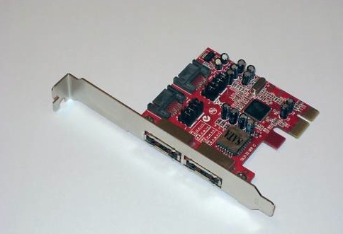

Ordered one of these for $25 off eBay. My current 1TB external drive has both USB and eSata connections and serves as my time machine for my Macpro1,1. Thought that for $25 it would speed things up a bit and give me some future eSata options for an external multidrive enclosure. Anyone used this one before? Did I waste $25 🙁
Ordered from HK so will probably be a few weeks before I can answer my own question....

They look like the two I bought over a year ago for like $7.95 each and free shipping from Hong Kong. At that time they used the SIL3132 chip, and drivers were a nightmare. Now that the driver issue is fixed (I think) I have gone to a Sonnet E4P. Works fine and even gives me port multiplication, but not sure about booting - never tried. External storage and time machine use only.
If yours are like mine, you can use external or internal, but not both simultaneously because of the jumpers.
Looks like a standard SIL3132 card.
I've got that very card (only difference I can see is a black PCB) in my Pro. It supports PM, can't boot OS X, works very well with Sonnet drivers, supports only two drives at once (2 external, 2 internal, or 1 each), and maxes out at about 115MB/s.
I guess that's pretty much everything to say about that card.
Thanks. The listing did say red or black PCB so I guess I could end up with either. I was only planning on using external so I am ok with not using internal at the same time. Should still be faster than USB to the drive anyways.
Will try downloading the Sonnet drivers when it arrives.
Just a quick update. I ended up getting the black PCB version (like it matters 🙂 I set the jumpers to use the 2 external eSATA ports, installed it, and ran the SIL3132_1.2.5.0 package. Added my Time Machine external drive and a disk dock (I use it for backing up on bare drives). It has been working flawlessly. And it solved 2 intermittent issues I was having. Once in a while my time machine disk would stop working (would get a complaint from TM and an exclamation mark on the TM icon). Ejecting the disk and restarting it would clear the issue. That hasn't happened once (touch wood) since I started using it on eSATA rather than USB. The other thing I noticed is that my bluetooth USB dongle (cheapo eBay one) would go insane once in a while and drop my bluetooth mouse and trackpad. I suspected maybe a conflict on the USB bus. Well that hasn't happened since the upgrade either.
So kinda glad to get the disks off the USB bus. Better transfer rates and solved two annoying issues.

I ordered this same black version you mention here, and just installed it with the driver package you mention. I did not do any jumpers on the card, nor did I use the red jumper cables. I cannot for the life of me get the card to see my Gtech 3TB external drive. I see the card in my hardware, but it shows it as driver: not installed. I have rebooted the machine, etc, nothing. I am on Lion 10.7.2, and have a 2009 Mac pro.
Any suggestions would be greatly appreciated.
I only ran that card on snow leopard. I never did update my Mac pro to lion because I use 3 displays on my flashed 5770 and lion breaks that :-(
So it sounds like you need lion drivers for the card.
OK, I seem to have gotten it working. Not sure if it will last, since reports say Lion may remove the .kext upon restarts and place it in the incompatible software folder. But here's what got it working for me:
1) Remove the card and move all 8 jumpers on the card to the 1-2 position (you'll see a marking for the #1 pin). It seems the cards ship with the two internal data ports active. Moving the jumpers deactivates those and activates the external esata channels.
2) Download and install the Sonnet E2P Driver from here http://www.sonnettech.com/support/downloads/software/DSKCD-E2PE342PE_NEW.dmg which should update the SI3132 kext
Bob's your uncle. Hope this helps.

It works. I bought from amazon a different one. Make sure chip set is right. You will get around 380 read and 280 write speed.
HOWEVER, THESE CARD WILL SLOW DOWN YOUR GRAPHICS. WHEN YOU LOAD WEB PAGE, YOU WILL FIND IT SHARED GRAPHIC CARD"S bandwidth with CPU. I FINALLY, pulled out and using two SSD for a on board raid 0. This give me about 500 read and 380 write speed on SATAIII SSDs.
In the end pcie 1x SATAIII card is not a good working solution for me. Again on board SATA II raid 0 gave me the best results and not slowing down graphics.
Also wanted to point out that I have 2 in my MP. One is a Dynex card from Best Buy and has worked just fine (but not bootable) since 10.5 through Lion.
The other one was a PC card (SIIG chip, I believe) but worked just fine. Got it free from a guy at work who was literally throwing out boxes of various PC parts and so on. Threw it in just to see if it would work and it did.
The Dynex one sells for like $20 or less, I believe for those of you looking to add eSATA.
On board SATA is better
