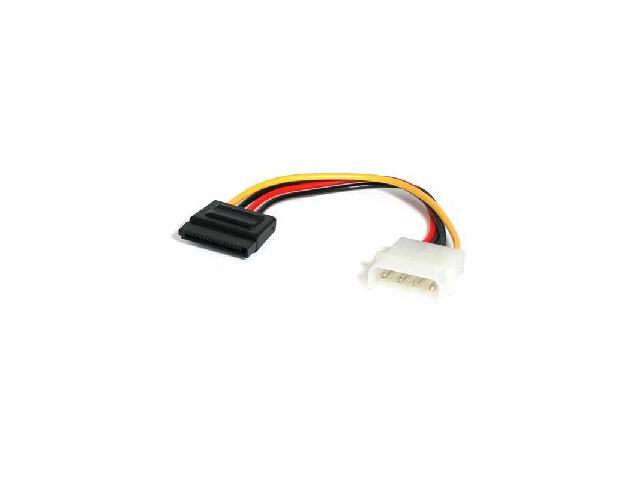

Hi guys i have Orico USB 3 Card with 4 usb ports for mac that come with power connection manual say that the card does not need extra power but its not working. I am looking to power the ccard with free HD bay will this cable work in my case
6" 4 Pin Molex to SATA Power Cable Adapter SATAPOWADAP
Thanks

The picture is not very clear, but doesn't looks like the correct one to me. The cable require a STAT port that same as the one that on the HDD / SSD (can see the golden pins).
The card should run flawlessly once you prosper it properly.

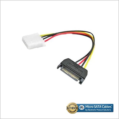

Hi guys card works fine i was using it in my pc with power cable but i think i might need power and no drivers wore used before on my mac for any usb 3.0 what about this cable.
15 Pin SATA Male to 4 Pin Female Power Cable

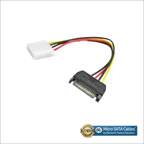

The SATA port on this cable looks good to me, but you have to cut the plastic latch by yourself, otherwise it can't fit in the logic board's SATA port.
Couldn't remember what the other side looks like (the Molex side), but you have the card on hand, so it can't go wrong.
And no driver required for this card.

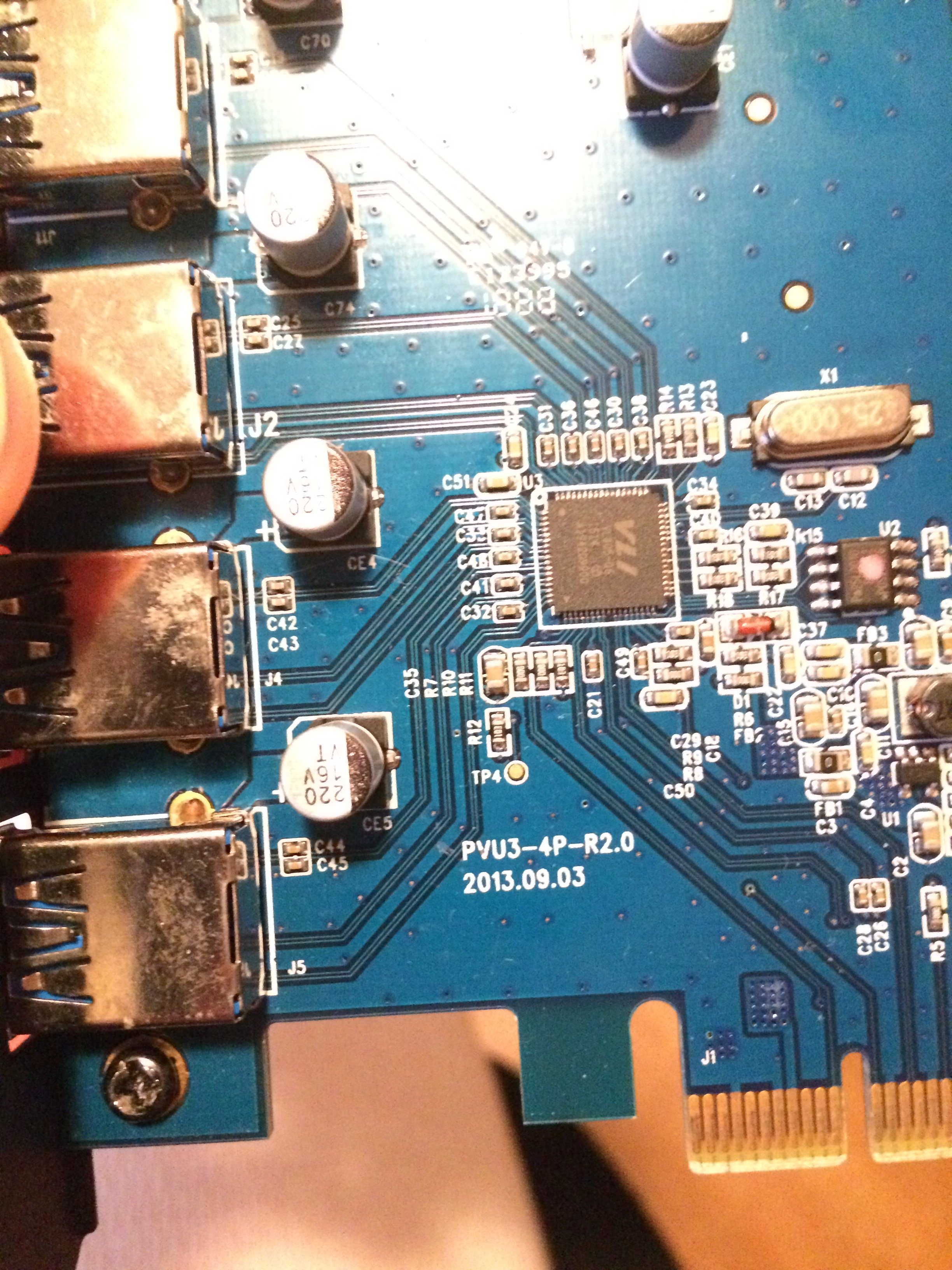

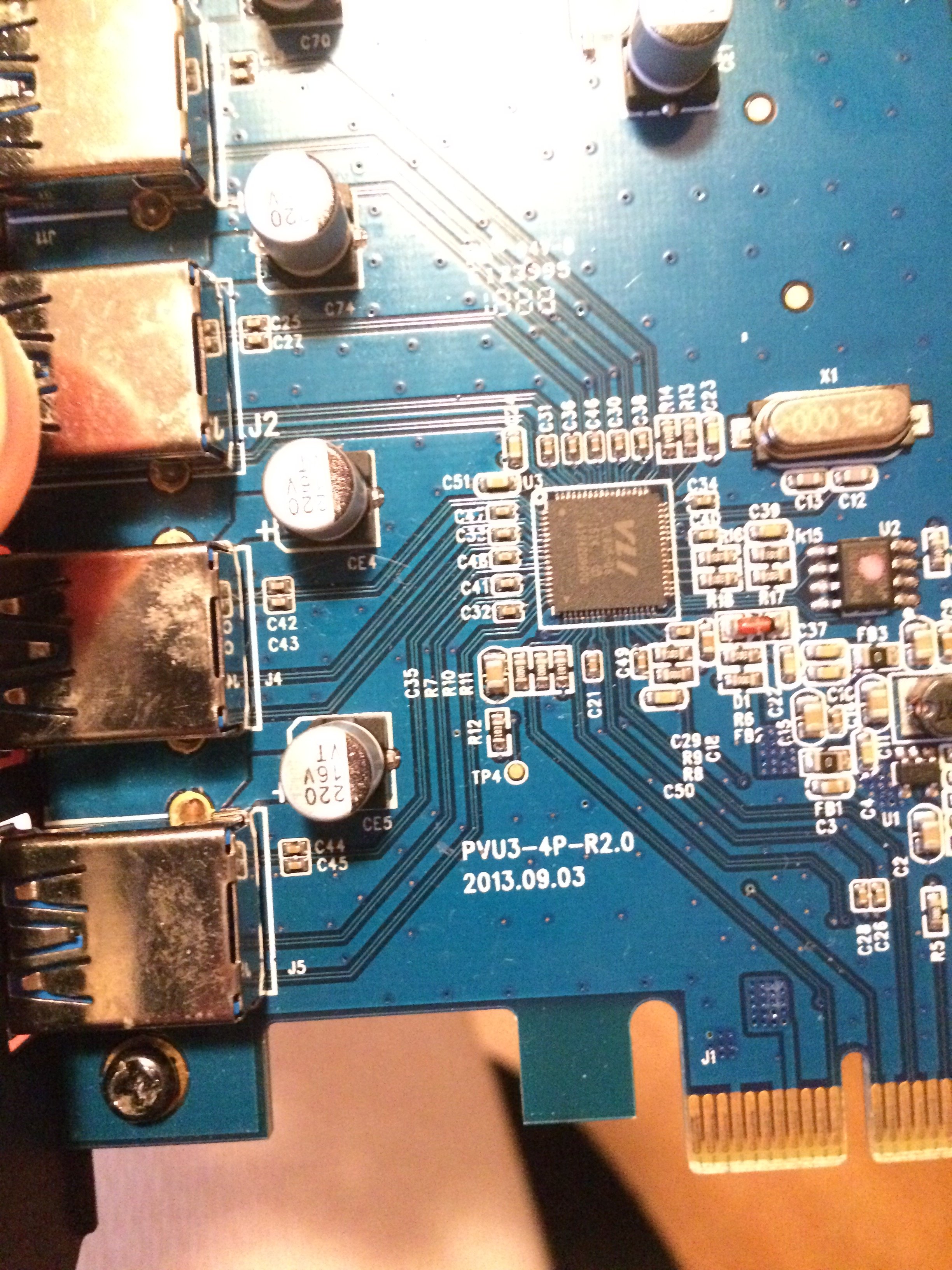

Hi guys this is the card i have PVU3-4P-R2.0
**** i don't think its supported. now i remember Me as morth i bought mac one but returned that one and got pc
Supported SystemWindows 10 / 8 / 7 / Vista / XP
http://orico.cc/goods.php?id=4785

Inateck Inateck 4 Ports PCI-E to Interface USB 3.0 Expansion Card for Mac Pro
That looks like it's a VIA controller. As far as I know, it's not supported by macOS.
That driver you found may make it work... But I don't know how good that driver is or if it causes problems with anything else.
You are probably much better off going with an FL1100 based card that doesn't need any hacked drivers.
