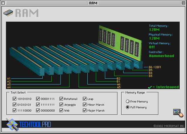

Odd problems often lead me to - bad RAM.
The best RAM test I found for old non-OSX machines was TechToolPro v3.0.9 with all RAM tests and "Full Memory" selected. (See pic).
It takes a long time, but I solved a few machines which passed even Apple's own MTP service memory tests.
Of course, you could try, deleting "Apple Menu Options Prefs" and "Appletalk Preferences", reboot whilst holding "Option" "Apple" "P" "R" keys (to zap the PRAM) - allowing it to chime 3 (YES Three) times, then release the keys allowing it to boot.
You could try taking out half the RAM, and/or removing the Level 2 Cache DIM (if it has one).
Remember, these machines can interleave RAM, by installing the same type/size of DIMM in A1 & B1, then A2 & B2 slots etc. Not having the same manufacturer or size of RAM in "A1" and it's corresponding "B1" bank may cause the machine to disable interleaving, or worse, running interleaving with RAM modules whose timing are slightly different, causing strange crashes, especially when you fit faster CPU cards and G3 upgrade cards.
Also, bear in mind that the sockets on the motherboard and the edgefingers of the DIMMs, CPU, Cache and PCI cards can intermittently break connection due to age, dust and tarnishing. These usually manifest as hard freezes where the mouse pointer 'locks' on screen and won't move.
I used to to a test, disconnecting the hard drive and booting from a CD. Once the OS had loaded, I'd rock the various cards, DIMMs and cache from side to side, and if the pointer froze, then that item needed cleaning.

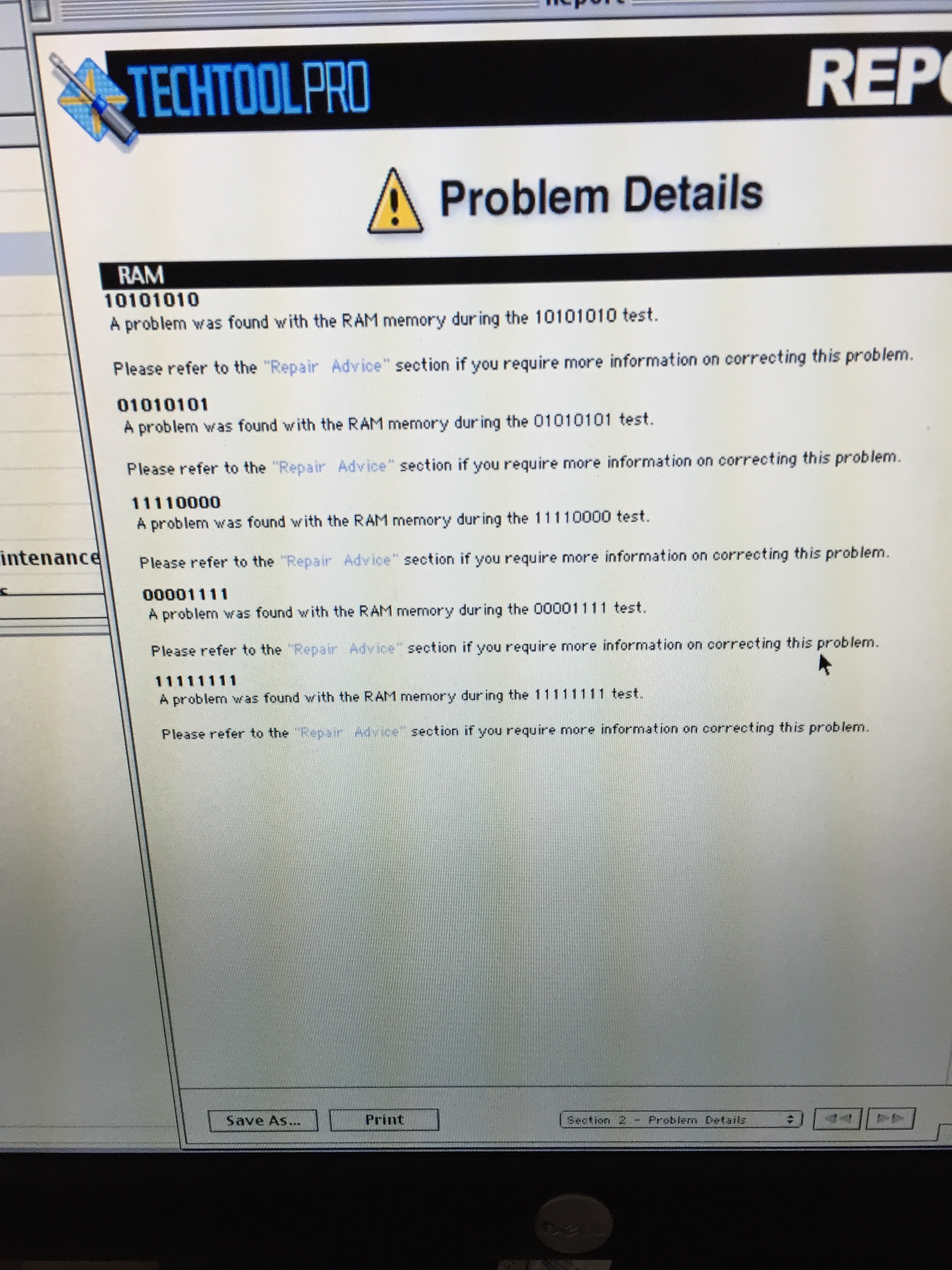

I ran TechToolsPro 3.0.9 this morning, and it reported numerous RAM errors, so it seems as though that's the source of my problem. I need to play with it and see if I can get the function MacTech shows above where it pinpoints problematic DIMMS.
Unfortunately, a little annoying thing called work got in the way, so I wasn't able to do anything else. Here's the report, though.
I may try the brute for "Wiggle" method mentioned above also.

I should point out that (sadly) TechToolPro doesn't tell you which module is faulty.
Use the "half at a time" method to find the bad module.
