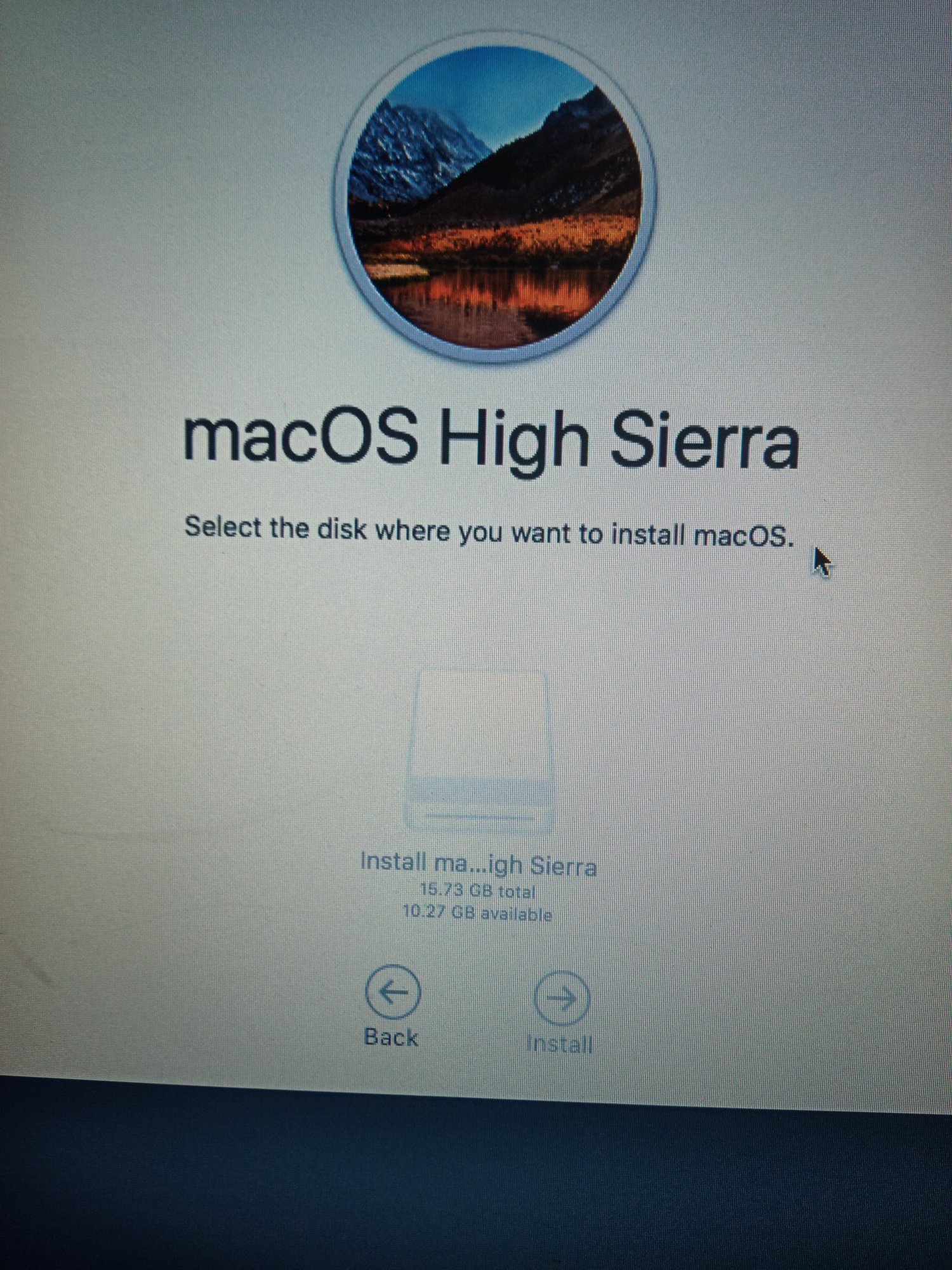

This is the install page that I eventually navigate to. I thought this was the SSD...but thats 700MB not GB lol. So, it is not showing up here.

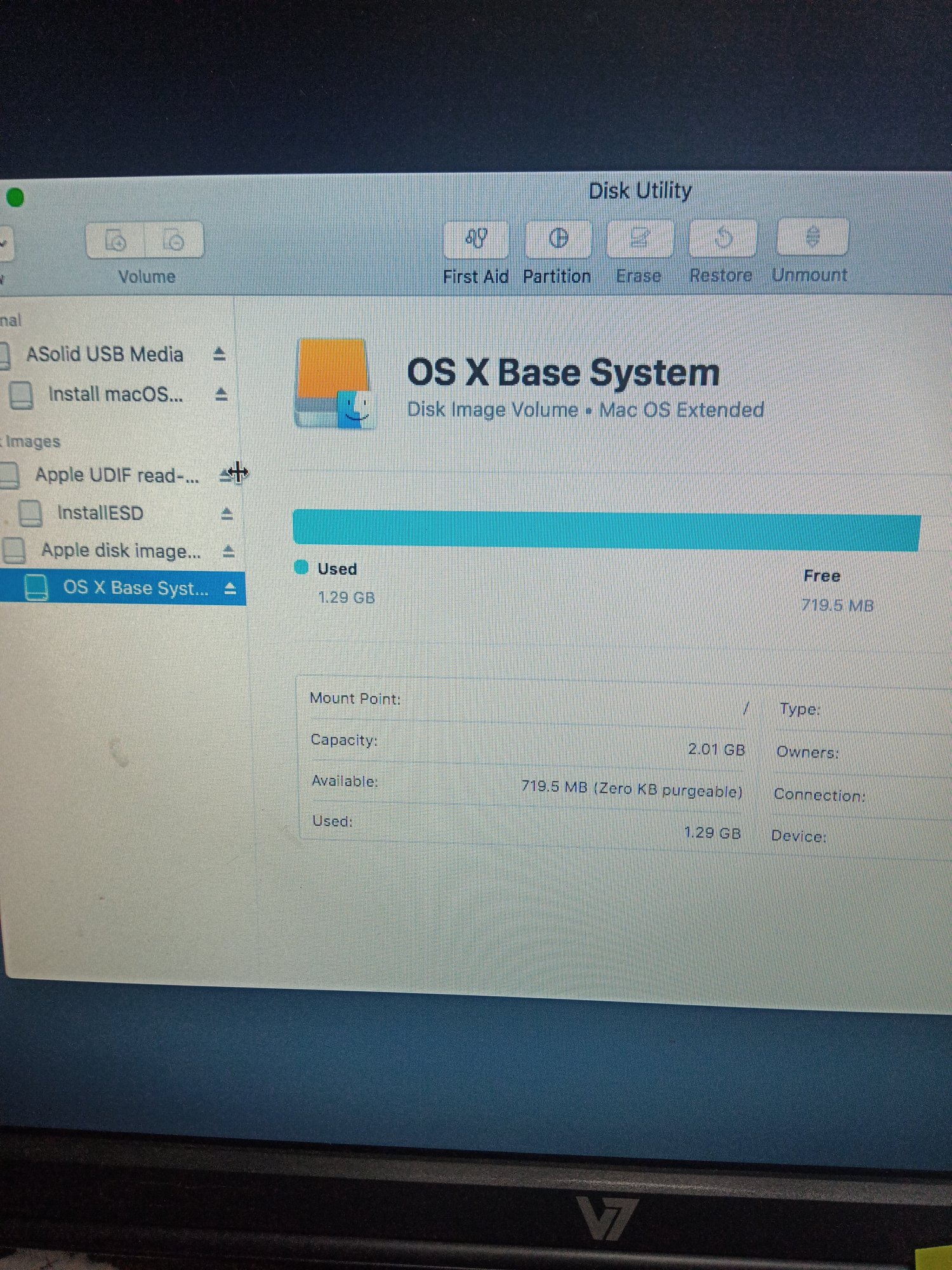

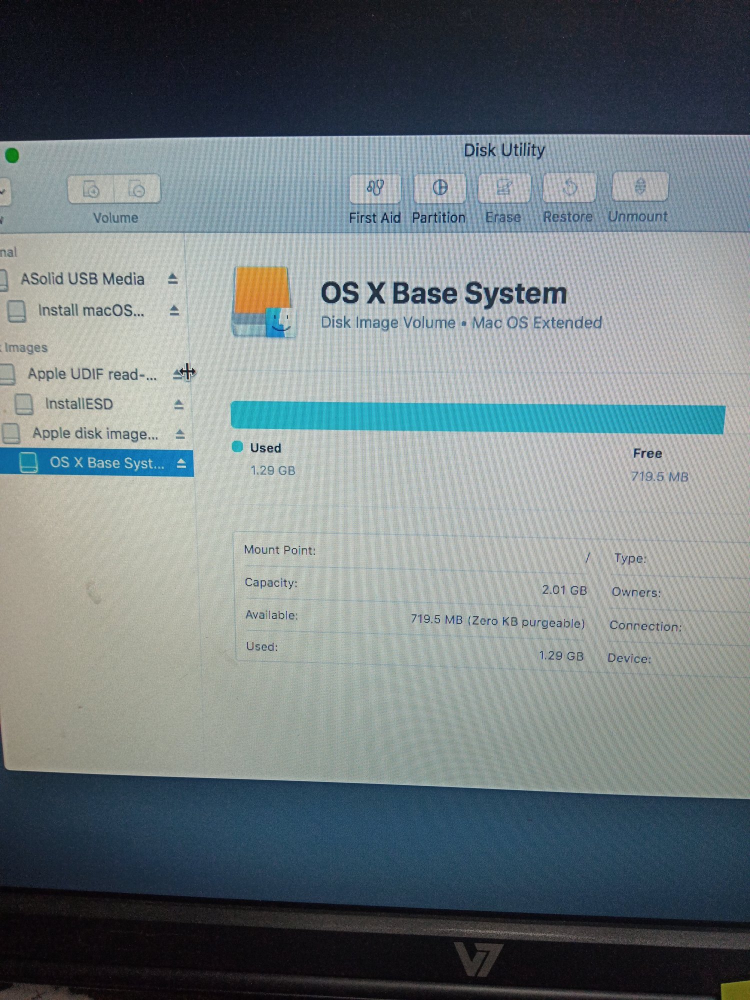

Here is another image: only the install usb drive is showing for target install options it looks like.
It looks like the SSD isn't being seen at all. Can you check if the SSD is working fine by testing it with another machine or in an external enclosure?

Here is another image: only the install usb drive is showing for target install options it looks like.View attachment 1811731
Yeah I second what @Amethyst1 said. From the looks of it your SSD is not being read by your Mac. I would find a way to test it with another computer or external hard drive enclosure to make sure it works. Also, make sure “All Devices and Volumes” is selected on the top left when you’re choosing which devices are being shown in disk utility.
