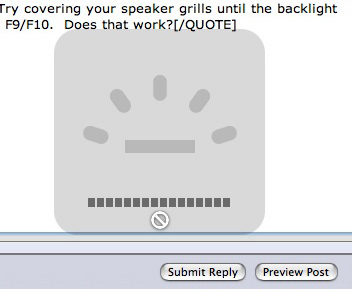

So all of you people complaining about your keyboard backlight not working...did you go into System Preferences and turn it back on? Yes, Apple updates sometimes change minor things...this one happened to turn my keyboard backlight off. It took me all of three seconds to fix it...I'll live. 🙄
I'm happy for you. The pref was still on for me. Toggling on and off (which is what F8 does anyway) has no effect. F9 or F10 do not work and show the "circle with a line through it" symbol.
That's what they'll show if the backlight isn't activated because it's too light. Try covering your speaker grills until the backlight comes on, and then try F9/F10. Does that work?
Hmm... not for me. If I pressed F10 to turn on/up the keyboard backlight, it would turn on the keyboard backlight, regardless of the ambient light. I have never seen the ol' "circle with a line through it" until now, post update, with my backlight dead. Here's a screenshot...
Nope, not for me.
This is the first time I've ever had an OSX update problem (3 of them with this update). Anyway, for this backlight thing is zapping pram or pmu something to try? I've always skimmed past those messages before, but this sounds like the sort of problem where this might help. Any thoughts?
Edit: Good news (for me at least). A reboot has fixed it. Weird! I noticed over on macfixit that someone reporting a font problem also saw that fixed by a reboot. Anyway, just adding some extra info since this point release was a bit special with its two reboots instead of the usual one (and in my case 3 reboots to at least get my backlight working again).
