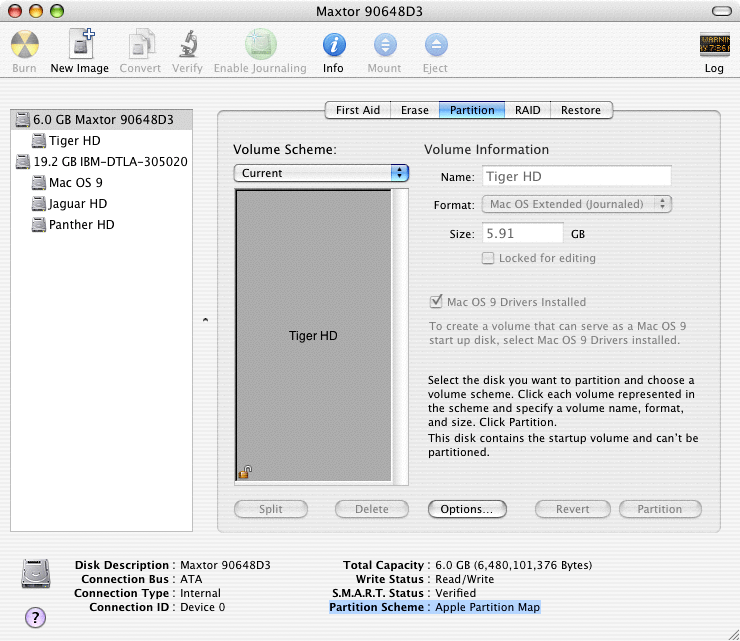

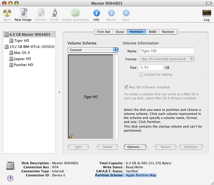

Can you boot the installer again and run Disk Utility from the installer menu to confirm the drive's partition scheme is set to "Apple Partition Map" (and not "GUID")?
For example:

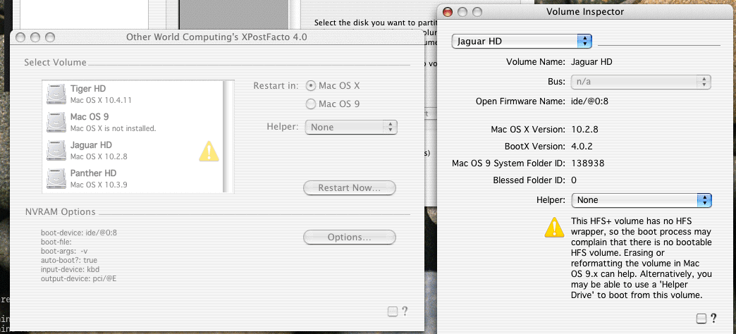

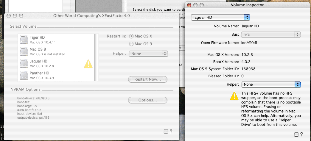

You could try booting back into Mac OS 9 and run XPostFacto 4 (here). Although not required for running Tiger on your iMac, there are some checks XPF will do which might point you in the right direction if there are potential problems with the drive configuration.
See this screenshot example of a Jaguar HD partition on my beige G3 which refuses to boot unless I use the "Helper" drive option due to a missing HFS wrapper (?).
I would give it a try at least to see if you can coax Tiger into booting using the Helper drive (your Mac OS 9 partition) as support. Otherwise, maybe a reinstall would do the trick?
