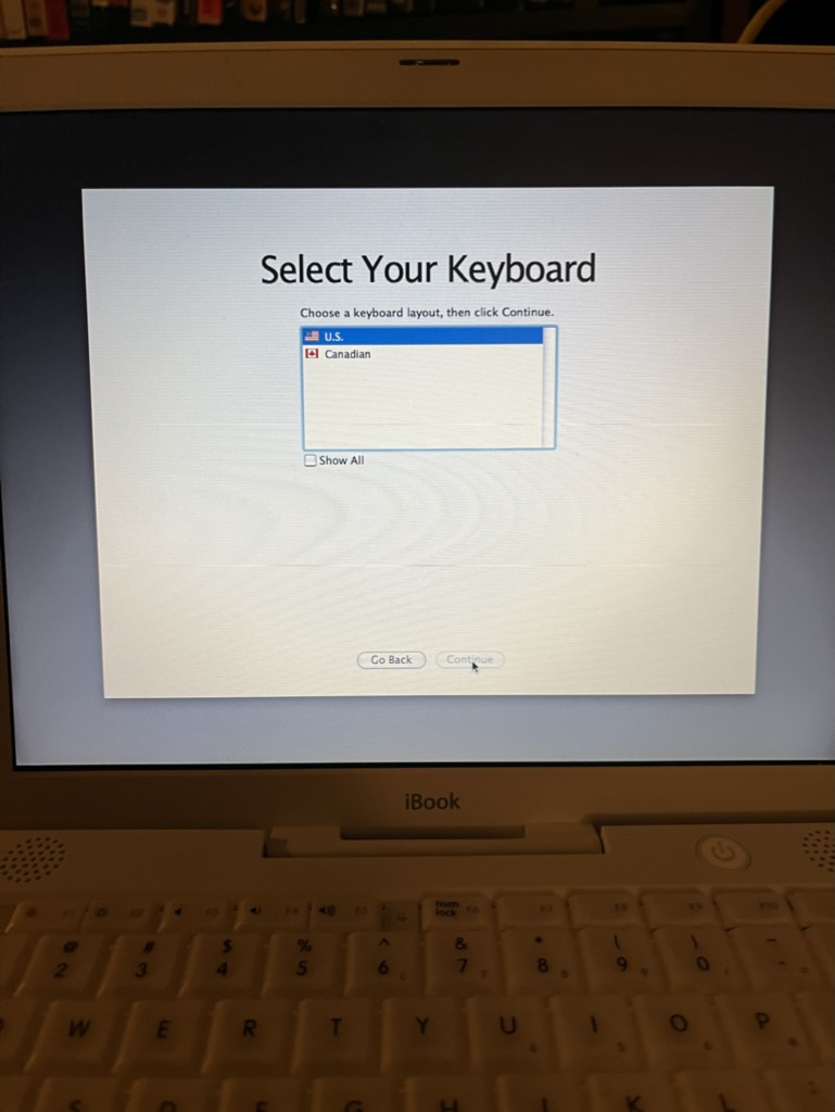

I installed 10.4 Tiger on an empty partition. During the registration process, I couldn't get past the part where you choose what country you keyboard is set up for. After I hit continue, the button grays out and I can’t continue. I tried two different install discs with the same issue. I also tried with a usb keyboard connected and that didn’t make a difference.

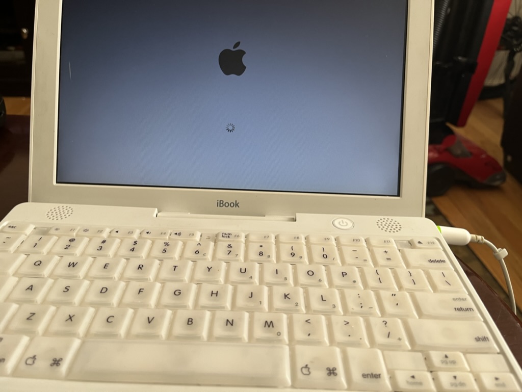

I decided to try 10.3 Panther instead. It installs but won’t boot into 10.3. Instead I’m stuck on the boot screen. It’s not frozen but it just doesn’t go anywhere. I stayed on the boot screen for over 20 minutes before giving up.

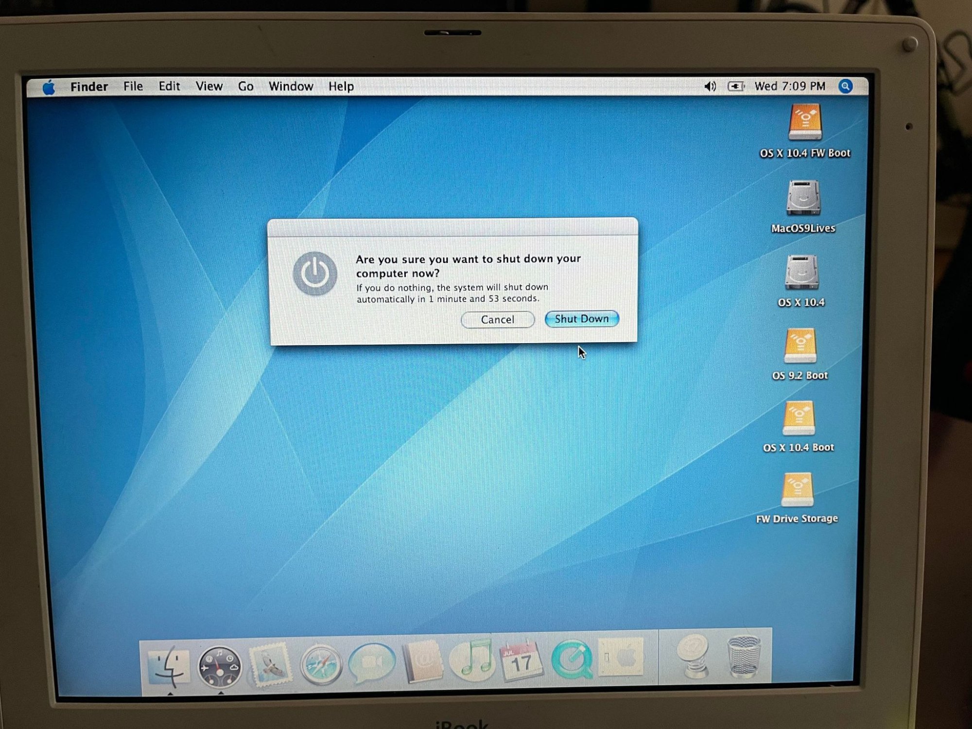

Later, I had an idea to install Tiger from the iBook but onto a partition on an external FireWire drive. For some reason I thought that might get me past the keyboard issue during set-up. It did! After I finished set up, I moved the drive to another computer and made an image of the install with Carbon Copy Cloner. Then I installed the image on the drive partition on the iBook.

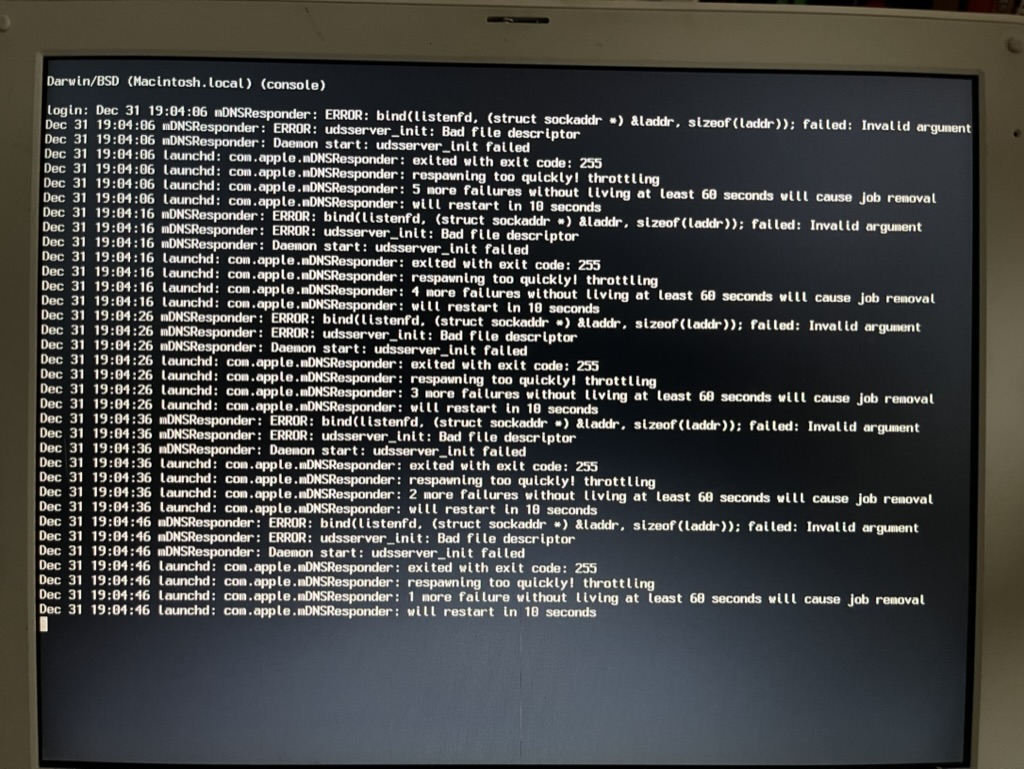

I keep getting this message in OF. I even tried booting with the computer connected to ethernet. That did not help.

The warning in OF seems to be related to networking. Is there anything I can delete, disable, or add to this install that might get it past this?

I installed OS X 10.4 but as I was going through the registration/ set-up process I got stuck at the keyboard part again. I shut the iBook down and put it in Target Disk Mode and connected it to my PowerBook. I went through the registration/ setup process and shut down. Then I booted the iBook and I got the same OF warnings.

I trying one more thing, though I really doubt it is going to work. I installed OS 9 and 10.4 on a partition on my FireWire Drive. The iBook boot from it just fine. I was able to get through set-up without any issues. Now I have the iBook in Target Disk Mode connected to my PM G5. I also have the FireWire drive connected to the G5 and I am using Disk Utility to restore the partition on the FW drive to the iBook.
