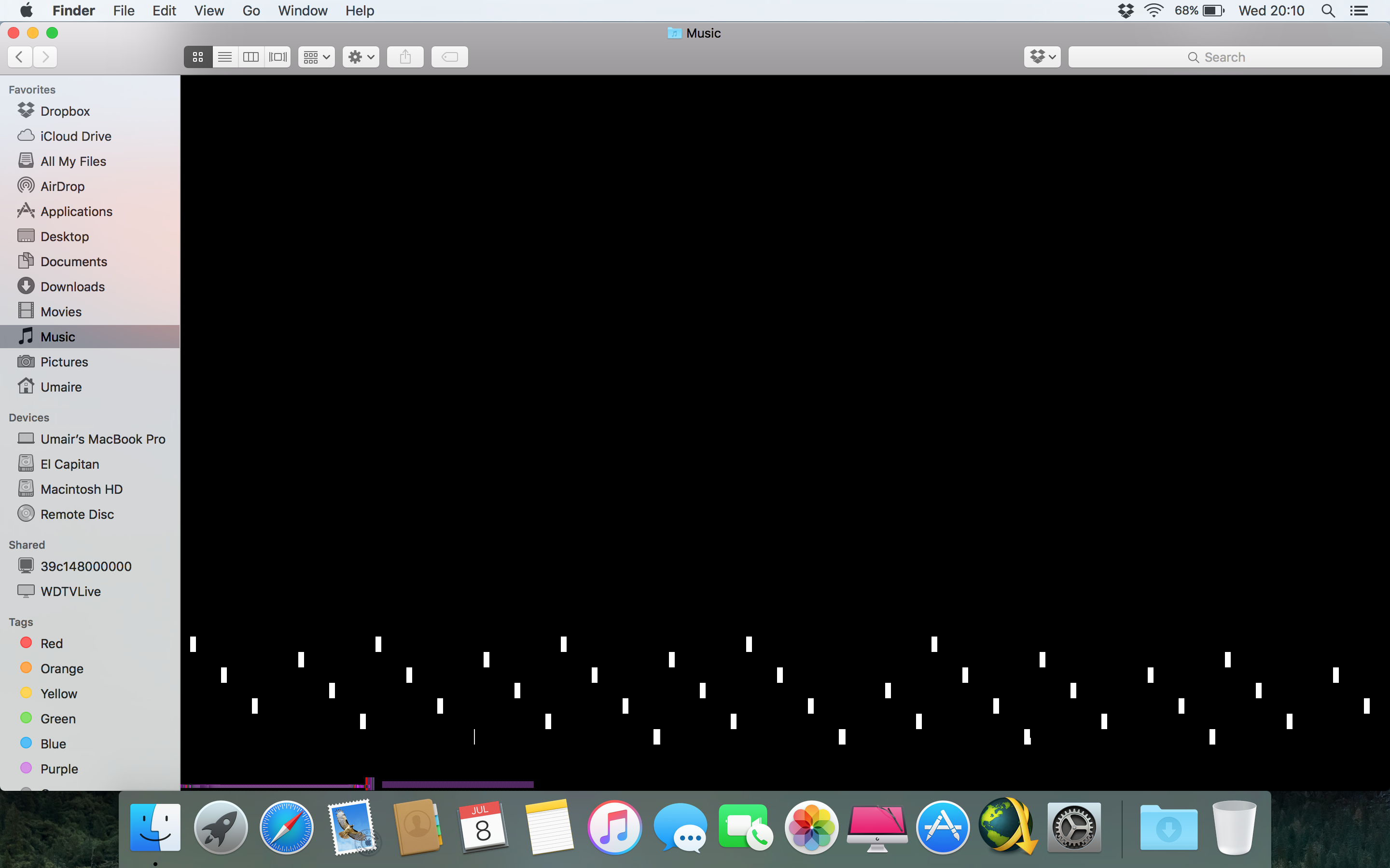

I have serious graphic corruption on my rmbp 15 with intel iris pro. It the screen goes black by click on library folders on the side bar in icon view. I have done a SMC and PRAM reset to rule out, but it seems to be a graphics bug. Here see the video and screenshot
Video Link:
This bug is introduced in DP 3 15A216g
