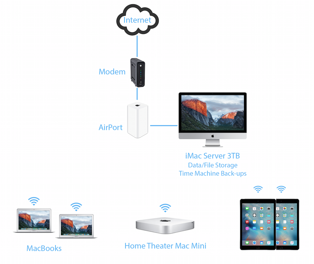

I have a chart with our devices, and I'll list the functionality we'd like to have with the OS X server:

• iMac 27-inch 3.3Ghz 3TB Fusion, 16GB RAM, wired to AirPort / Time Capsule
• OS X El Capitan + OS X Server
• AirPort Extreme + AirPort Time Capsule, not sure which we are going to use as the main Networking device
• 12TB RAID Pegasus Thunderbolt array for file storage
• Cable modem on standard internet account, not sure if Cable company supplies static IPs to residential users or if I need a business account

Access to the server from the outside - I would suggest you try the simple but effective VPN server in OSX Server. It requires a FQDN and a good router. Your architecture depicts an Airport extreme and a modem - I don't know which of those 2 you will use in bridge mode, I assume the modem is in bridge mode so the Airport will do DHCP, port forwarding (Apple provides a list of ports that need to be forwarded for all services, also for VPN) and VPN (IPSec) passthrough. Use L2TP, not PPTP.
Configuring the VPN on OSX Server is quite straightforward once the rest is OK. Do not use a .local FQDN but register a domain and point the domain to your (hopefully static) home IP. Your iMac needs a static IP in the router range (but outside the DHCP range of course otherwise you will encounter IP errors).
