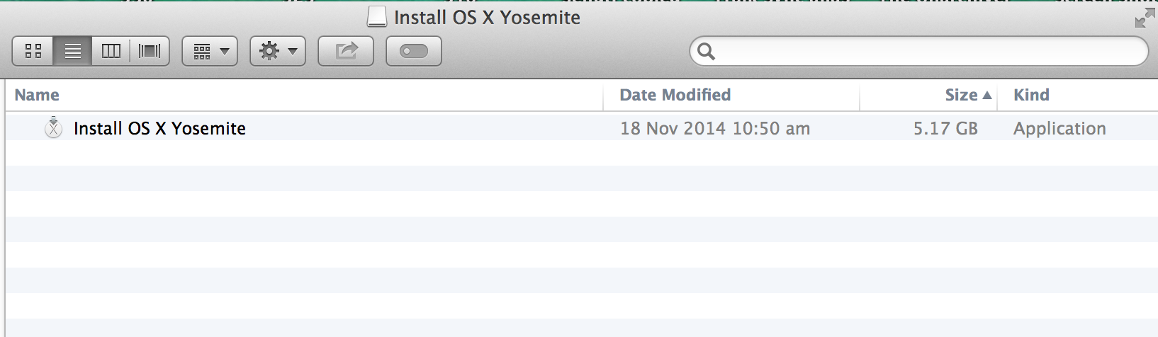

Boot up yosemite.
Just put your bootable usb into your computer but don't boot from it.
Open the drive called "Install OS X Yosemite"
All you should see inside is "Install OS X Yosemite"
attachment.php
That IS the installer app.
You may copy it out without having to redownload it.

Yes, I just figured it out.
I plugged my yosemite usb and checked its contents.
all i see was one application which was ..guess what...yosemite installer application (5.17 gb) .
I copied it . Maybe i will try to make another bootable usb with it to see its the same unmodified app which i had downloaded form the app store.
