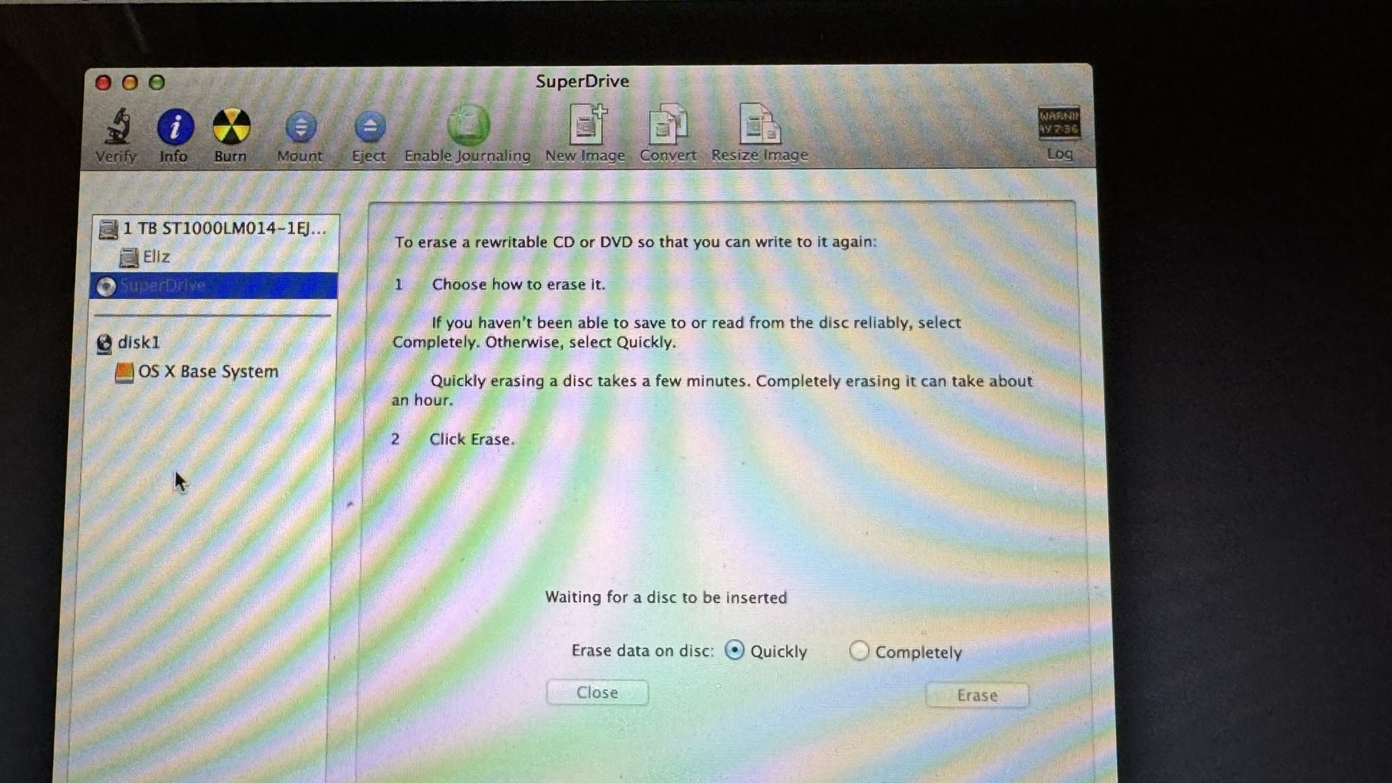

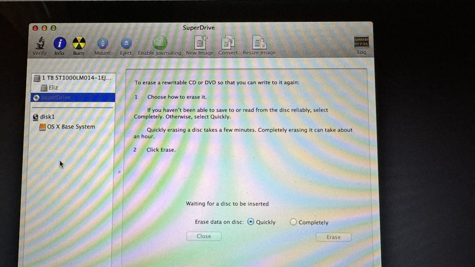

We have an older MacBook Pro and it was in great condition. I was trying to wipe the memory and get it back to the Mavericks system. I used the disk utility. Now when I try to open it, I see the 1 tb drive, and under disk 1 it shows OS X base system, but I can't seem to get it to open or boot up? Does anyone have a fix for this? I've tried doing internet recovery. Also, when I tried the reinstall, it did verify it, then takes me to sign into iTunes, but won't then says connection failed. Maybe this is because there is no app on iTunes or ap store anymore?
The picture you posted shows the CD-ROM drive. That has nothing to do with your ability to install Mavericks. After you are booted to internet recovery, you want to choose the Install OS X option.
Thanks, I have tried this, and I get the agreement page, and answer yes, it then asks for my iTunes or Apple ID, and I put that in, and then it says failure to connect. My assumption, is that the software for downloading the OS X Mavericks in no longer supported? I do have an internet connection, and it is the correct ID, in fact I have also tried my wife's, and same thing? The picture above shows the disk utility. It shows the 1 TB file and below that is the OS Base system. I don't have a CD or DVD in the computer.
