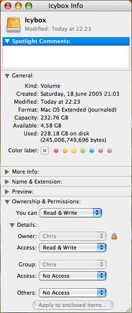

It has to be there..
Under Ownership & Permissions. It's a checkbox, (changed to) "Ignore ownership on this volume" in Tiger.
Here is a screenshot of the get info box:-
attachment.php

cblackburn said:
However when the user logs in over FTP all the files are suddenly owned by fileshare, and hence the remote user has complete access. Why do the files reflect the owner to be whoever is logged in rather than the correct file permissions?
By default OS X mounts external drives only when a user logs in at the console. These external drives are mounted such that the logged in user owns the files on the volume. In effect this means that the permissions stored on the external drive are ignored.
If you want OS X to honor the permissions on the external drive then you need to set up the mount options for the external drive using an entry in /etc/fstab.
