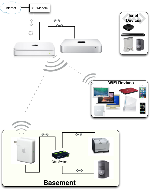

Here is a quick and crude diagram of my network layout as it is presently setup. I am not opposed to changing the layout/ setup or making reasonable purchases (within a few hundred dollars) to improve the network.

Yea, you can't look at the logs or anything useful anymore.
I was going to suggest that you could use the radius server in os x server. And you could if you were just going to use the TC. It's easy enough to setup in ML and probably the same in Mavericks, however it has a few caveats. Just like airport utility, they (Apple) have been trying to make os x server easier to setup, which I suppose is a good thing, however in the process they have taken out a ton of useful functionality (like the logs in AUtility )
In order to setup radius you HAVE to be running TC, or Airport Extreme as your primary gateway. If if isn't it won't show up on the server to be configured.
BUT............. in your setup with the airport express going wirelessly to the TC it just won't work. (I was trying to go to WPA2 Enterprise and radius on my bridged network in about the same setup) I tried this exact same setup a while ago and had no luck. I think the problem is the the airport express needs to get to the server to authenticate before it can gain access to the TC (in my case Airport Extreme)
If there is someone out there who knows how to make that work I hope they let us know.

You can't use the Airport Express - but you can use the Time Capsule device and enable RADIUS.
Basically, instead of having one password to log onto WiFi, you use your username/password that you log into the Mac.
This way, you can simply log into the server and disable the user from logging into the network. No more waiting to reboot the WAP and losing network connectivity.
If you need to extend your network, you need to use another Time Capsule or Airport Extreme.
You'll need to setup Server.app to get this going. It'll require one reboot of your TC to make changes.
If you have questions let me know over PM. I can guide you.
