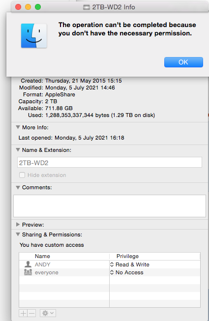

I have a mac mini running Server & all it is doing is publishing various external drives to network & performing scheduled backups back & forth (all data is stored on these externals).
Just recently the missus requested her account to be checked on the iMac (the account has laid dormant for a few years) as she would like to get back into 'Mac'.
The basic problem is thus:
Log in on my account, mount the various externals I want (from server) & all has been good.
Now switch to her account & when the same drives are mounted & switch back to my account the drives have become inaccessible as I now don't have permission to see its contents.
If I eject the drives & re-mount then the same happens the other way!
The server has the ACL's set up (even with 'everyone' to have full control) but when you get info on the drives on the iMac it only has 2x entries:
1. The user (that has last mounted them (either me or missus)) set to: Read & Write
2. everyone set to: No Access
I mean it does work by ejecting & re-mounting, but seems silly to keep having to do this 🙁
Thanks in advance for all replies 🙂
In the Server Application under File Sharing, try adding each user manually with Read & Write Access.
