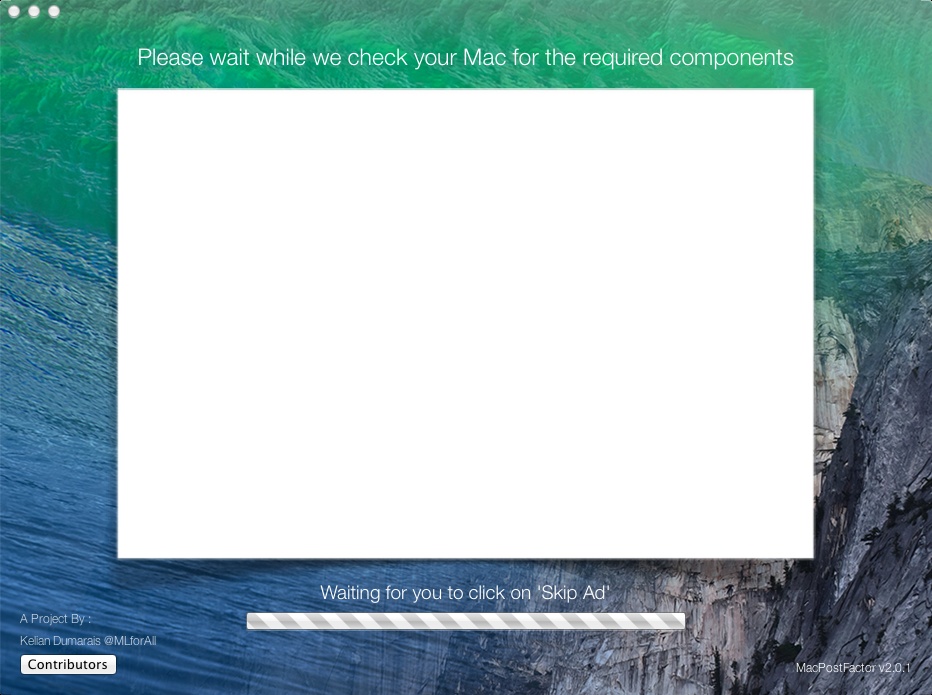

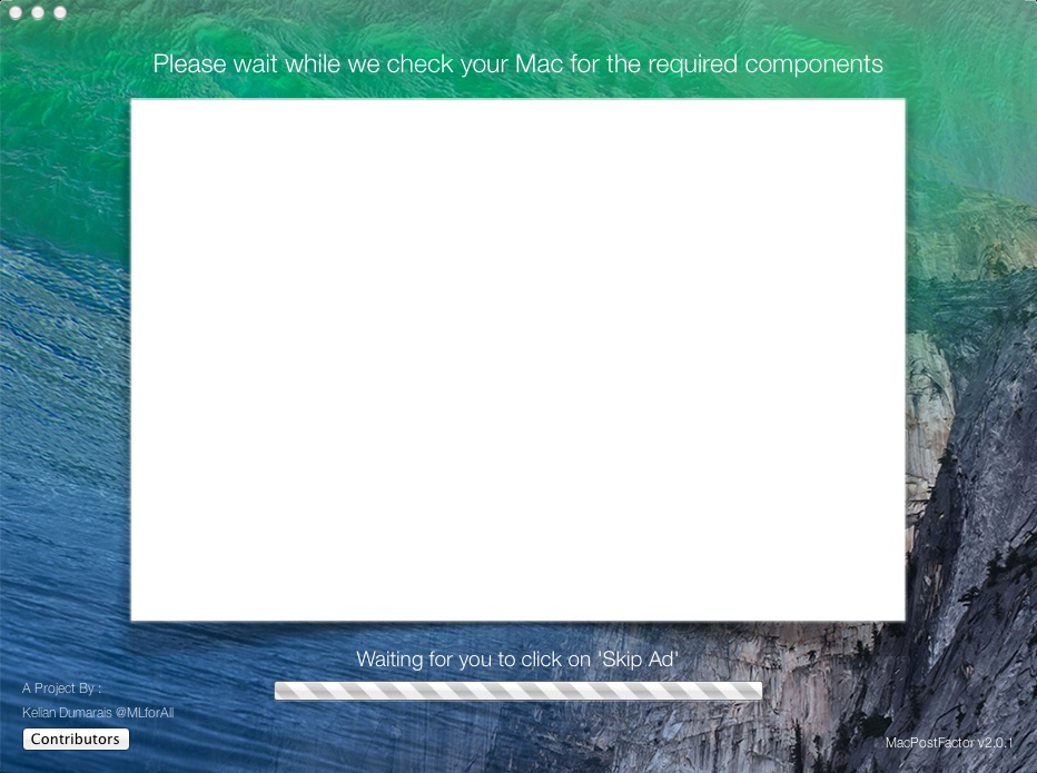

hello friends I am new here, I would like to welcome you all, I have a problem a few days because of a problem in advertising page can not proceed with the installation of Yosemite by MacpostFactor 2.0.1, someone can help me, or have any news about this topic, I am in touch with the developers of the program but not yet have a solution for it
hello friends I am new here, I would like to welcome you all, I have a problem a few days because of a problem in advertising page can not proceed with the installation of Yosemite by MacpostFactor 2.0.1, someone can help me, or have any news about this topic, I am in touch with the developers of the program but not yet have a solution for itView attachment 665793
I had to use a friend's machine (French laptop) with AdBlocker Plus in Firefox (seperately)... Disable it, then there's a menu under that with an arrow to the with two options... one is Java and Firfox, then another. untick both and reopen MacPF.
Im English and was using a French language laptop, so sorry if vague, but that got me past those steps...
I believe it's since been fixed...
