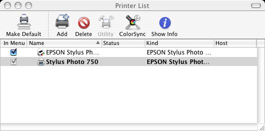

I have got it printing again from direct USB cable link. I now have 2 Epson Stylus Photos listed in the Printer List of the Printer Setup Utility (huh???).
And it still won't print from Airport Express. Grrrrr. Help??
