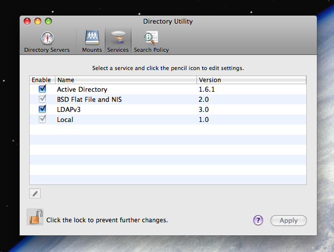

How do I correctly configure the windows servers in the Directory Utility Application?
These are the services that are showing on my Directory Utility Application:
I'm connecting to the network shares using AFP and SMB (these are both checked on file sharing config)

Go into each tab and click whatever options buttons there are. This should give you a clue as to what needs to be configured. If you don't know what to put in there, contact your Network administrator for guidance. Also use the Help Menu. i can't give you any more advice than that as I never needed this before.

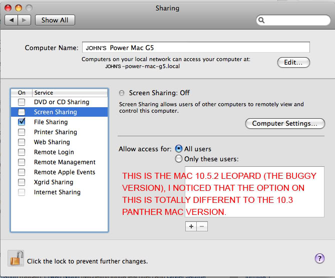

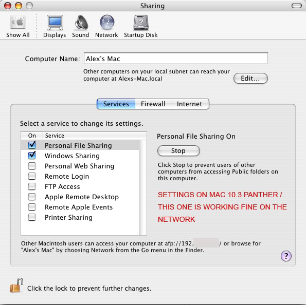

system preferences screenshot
Hi I was comparing the system preferences between the
- MAC 10.3 Panther Version which works fine with the network
and
- MAC 10.5.2 Leopard Version; the one that has trouble working correctly
I have uploaded the screenshots, hopefully this can help find the trouble.
and
I think you're getting confused. If you're connecting to a Windows server from OS X then these file sharing settings have nothing to do with it.
Do you know what version of Windows server you're trying to work with?
Without more info I can't really help.
Suffice to say I've been less than impressed with Leopard's Windows integration, so it may be that therein lies the problem, and roll on 10.5.3.
