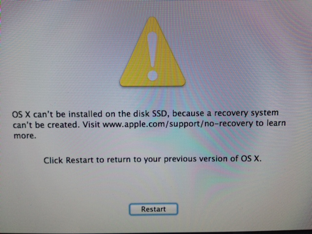

I'm getting this error trying to install ML. I'm installing to a 512GB SSD drive with 74GB free. The error message during install says to go to apple/com/support/no-recovery -- but that page doesn't seem to cover the issue at all?
I checked in Disk Utility and the disk is Mac OS Extended (Journaled).
I am not using RAID and do not have a Boot Camp partition installed... (since that support page references those as issues...)
Any tips?
Mac Pro 5,1
OSX 10.7.4
32GB RAM

I had the exact same issue with my mac mini 🙁 I'm stuck. I've tried various things, but now the installer is just stuck 🙁
quick fix
I had the same problem, it appears to be happening to people who have installed an SSD of their own. I simply had to resize my Mac HD partition (does not delete any of your data) by making it 1GB smaller. Then I ran the installer again and it worked fine. All this does is give the installer room to create a Recovery System during the install process. Writing this from Mountain Lion.

I Managed to fix the error by deleting the Lion Recovery partition using the instructions found here:
http://osxdaily.com/2011/06/30/deleting-the-mac-os-x-10-7-lion-recovery-hd-partition/
I have no idea if removing boot camp had any effect. But this worked for me.
Good luck, and have fun.
I can confirm that deleting the Lion recovery partition is how you fix this issue 😀

I've been trying to get Mountain Lion installed for the past 4 hours, with endless problems around the recovery disk. Long story short, I have an SSD installed in my early 2011 MBP running Lion, and the recovery partition must have somehow not been cloned over properly. Disk utility showed an Apple_Boot partition, but without any name (which should be Recovery_HD).
Deleting that partition and merging it with my main "Mac SSD" partition did the trick, following this guide http://osxdaily.com/2011/06/30/deleting-the-mac-os-x-10-7-lion-recovery-hd-partition/ , specifically the section "Deleting and merging a partition with diskutil from the command line".
After the delete and merge, Mountain Lion installed without any hassle at all. Hopefully others find this helpful as well!
