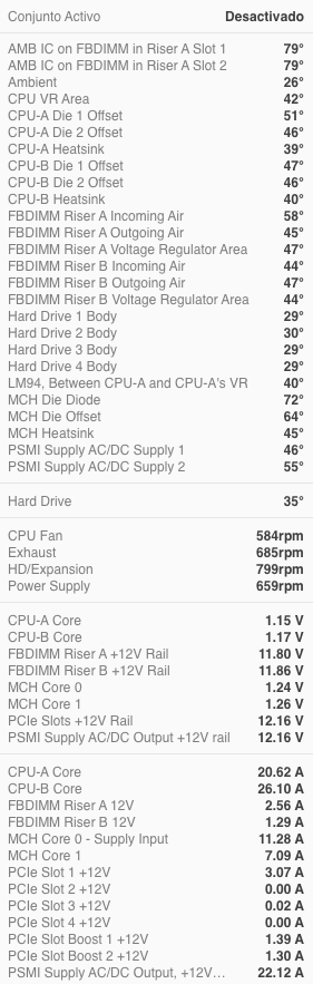

If i could monitor the temp of the gpu i could see if it's problem of temperature or voltage.
Voltage should not be a problem. Wattage may be. That's easy to monitor via iStat. All you need to know is the current, then you can calculate the total power consumption. However, an easier way is just to make sure the PCIe slot and cables current within 7A.
It's almost impossible to monitor the temperature in OSX, but in Windows is very easy to do.
The pcie slot 1 is now 3A, the slot 1 is the only one that i'm using now.
Maybe later i will go for a 8800GT to test things and make compares.
You have to check the PCIe slot boost as well if you do connect the mini 6pin.
Yes, it is conected the two 6 pin slots
And the pcie slot boost are
1 is 1.26A
2 is 1.25A
But them are changing 0.0X up and down, but are so stable
It's the reading under stress?
Nope, under stress at full screen the mac pro will shut down completely. The power on LED still on but the entire system is down, with no noises.
I can try to stress it without fullscreen and a low resolution, and the trying to increase it little by little.
