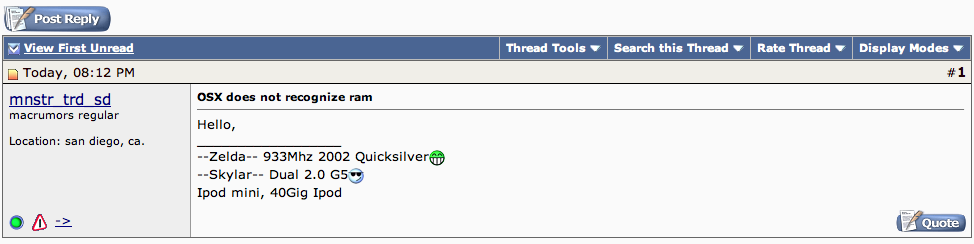

Fantastic, I'll get the pixie dust straight away.
EDIT: Sorry about the sarcastic comment, I saw the thread like this, and thought you'd given no information:
Did you just put new ram in? Or just do a software update? Or did you do nothing at all that you can recall recently and just noticed while idly looking in About This Mac, that it's less than you thought it out to be? Have you actually got any ram? Did you ramalamadingdong? So many questions.
i'm all out of pixie dust.
EDIT: likewise 🙂 - it's been a bit of a night for crank posts...
