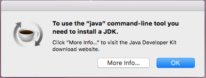

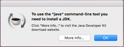

I just upgraded to El Capitan. After successfully installing it, the first thing I see is 'To use the"java" command line tool, you need to install a JDK' (Attached File 1)

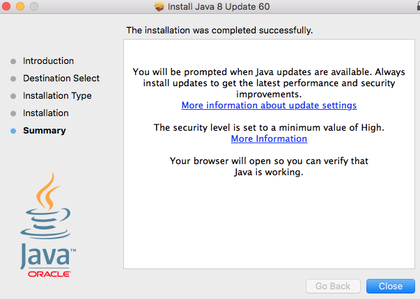

I then installed the java update. (Attached File 2)

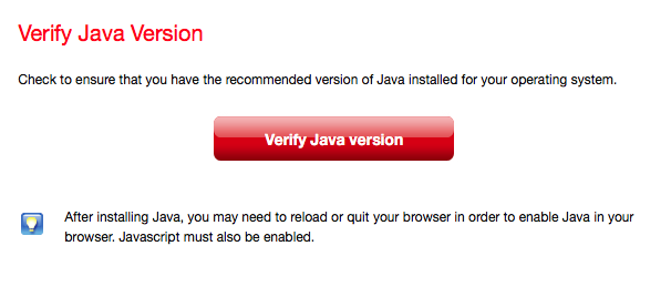

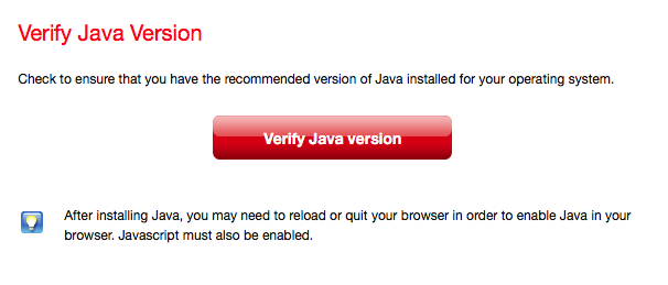

Next it prompted me to verify the java update. (Attached File 3)

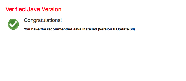

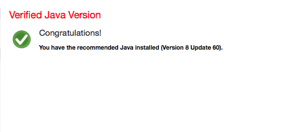

After that I successfully verified the Java version. (Attached File 4)
On restarting my computer, I got the same message as I did when I first installed the new OS X. I un installed and re installed the java update 3 times, and it still gave me the same error each time. (Attached File 5)

The JDK (Java Development Kit) is available on Oracle's website. Java website only gives you the JRE (Java Runtime Environment).

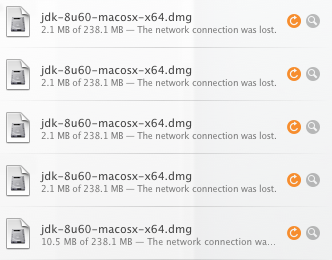

Thank you for your reply. I have no idea why the error dialog box would lead me to download JRE when it clearly says I need to download the JDK. Anyway, thanks to your tip I have been trying to download the dmg file from Oracles' website. For some reason the connection times out after downloading about 10 mb of 227 mb file. I tried downloading on 2 different macs (10.9.5 and El Capitan), using 2 different browsers (Safari and Chrome) on 2 different networks but end up with the same results each time. Anyone else experiencing this issue?

I have a MacBook Pro, also running El Capitan and I updated the most recent version of Java, which is Java 8, update 91 and I get the same message you are getting. My system shows I have the latest Java update, but I keep getting this message popping up very often. If anyone can help it would sure be appreciated.
treekram
