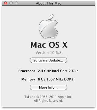

You COULD do this with a Snow Leopard commercial installer. The problem is that your 2010 mini originally shipped with version 10.6.3 -- but was a special build. The commercial installer with the same 10.6.3 version won't boot or install on your mini. BUT, you can do this, with the commercial 10.6.3 installer, if you have another Mac that is slightly older than your 2010 mini. For example, a 2009 mini. Connect the two Macs with a FireWire cable. Boot your 2010 mini to Target Disk Mode. Then, with a Snow Leopard installer DVD in the older Mac, boot the older Mac to the Snow Leopard installer. Install Snow Leopard on the drive in the older Mac. Let the installer complete, set a user up, and then run Software Update, so it will then be updated to 10.6.8. That updated system will now boot the 2010 successfully in 10.6.8 (or it should)
The 10.6.7 version that startergo suggested might work, but would be a copy of the special build of Snow Leopard used on a different Mac, and may not work in every case on another Mac. Apple never sold a full installer later than version 10.6.3, so unknown if that 10.6.7 will work correctly on a Mac that is not part of that specific install set. So, might be worth a try. I wish you luck with that version.

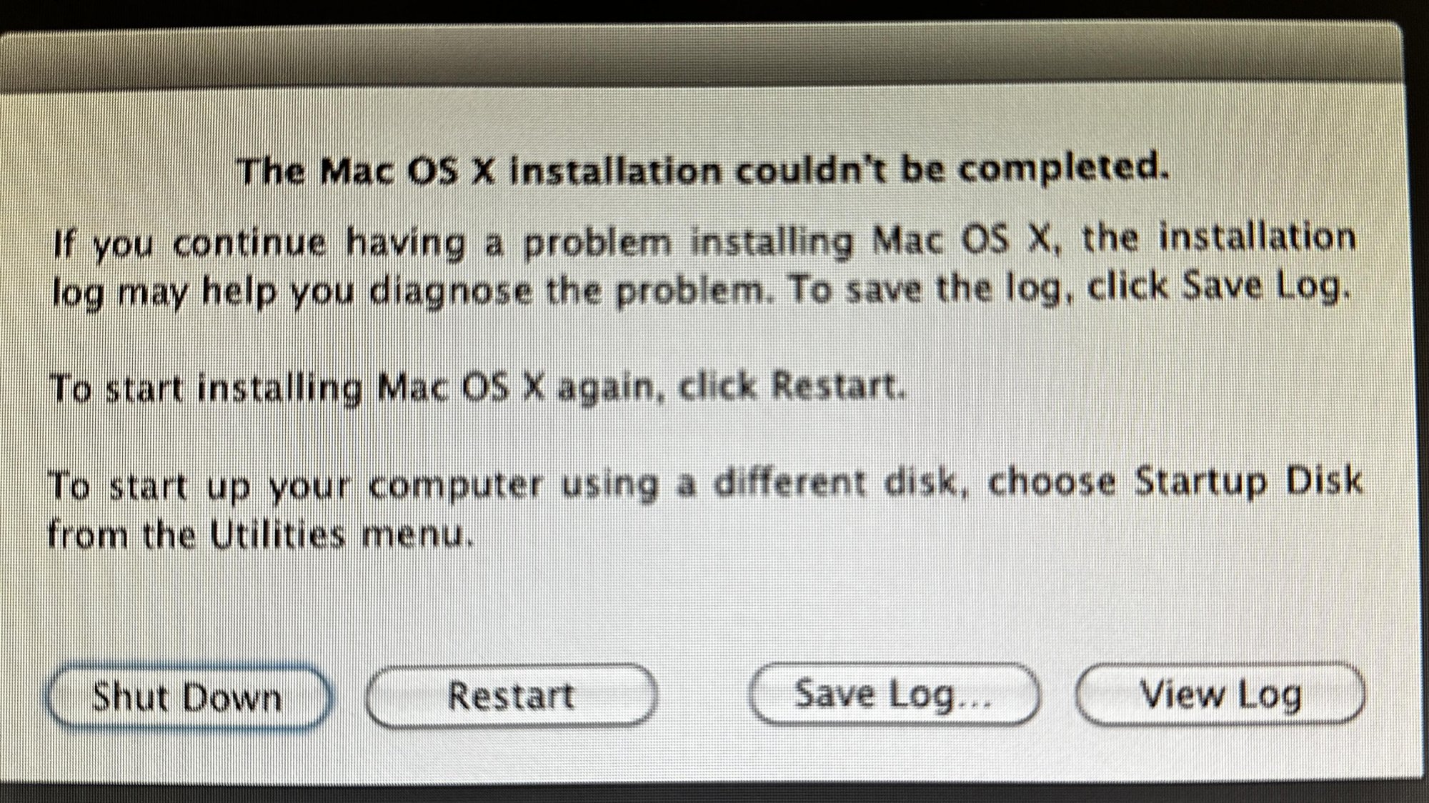

I have found several .iso and .dmg files from the links and info provided above. Thanks to all for that. However, all attempts at restoring/installing Snow Leopard have failed.
I've created a couple USB boot disks (flash drives), but not been able to restore successfully from any. And absolutely no clue what to do with the .dmg files, as the Mac mini is already running High Sierra and will not install an older version.

Hopefully you will get a response from somebody who knows what is wrong. I can only guess. What I can see from the log is:
It doesn't get past checking your internal disk called "Mini2 HD" at 20:07:45 to 58.
The "2024-05-28 20:07:45.858 Mac OS X Installer[150:6413] staging failure request 'crash on OSVolumeFsckQueueElement at 0." is first sign something is not right.
So maybe something wrong with your Mini2 HD disk. Did you erase and format the disk after booting from the USB immediately before starting the install?

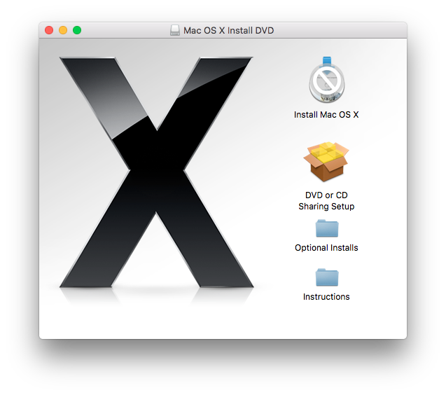

I have not wiped the hard drive on the mini... that Mini2 HD disk is the only disk in the mini... not sure who/what/why it is... also noticed this when I created the USB boot disk... not sure if the circle-slash on the install icon is significant:
I am surmising that you are having trouble because the HFS+ format on the internal disk is more recent than Snow Leopard. I can't remember how much HFS+ changed between OS X versions. You should erase the whole disk and format it with the Snow Leopard boot USB. (Save anything important on another disk.)
The icon with the circle-slash is because you are viewing it on a more recent version of OS X (or macOS) which can't run that installer.
