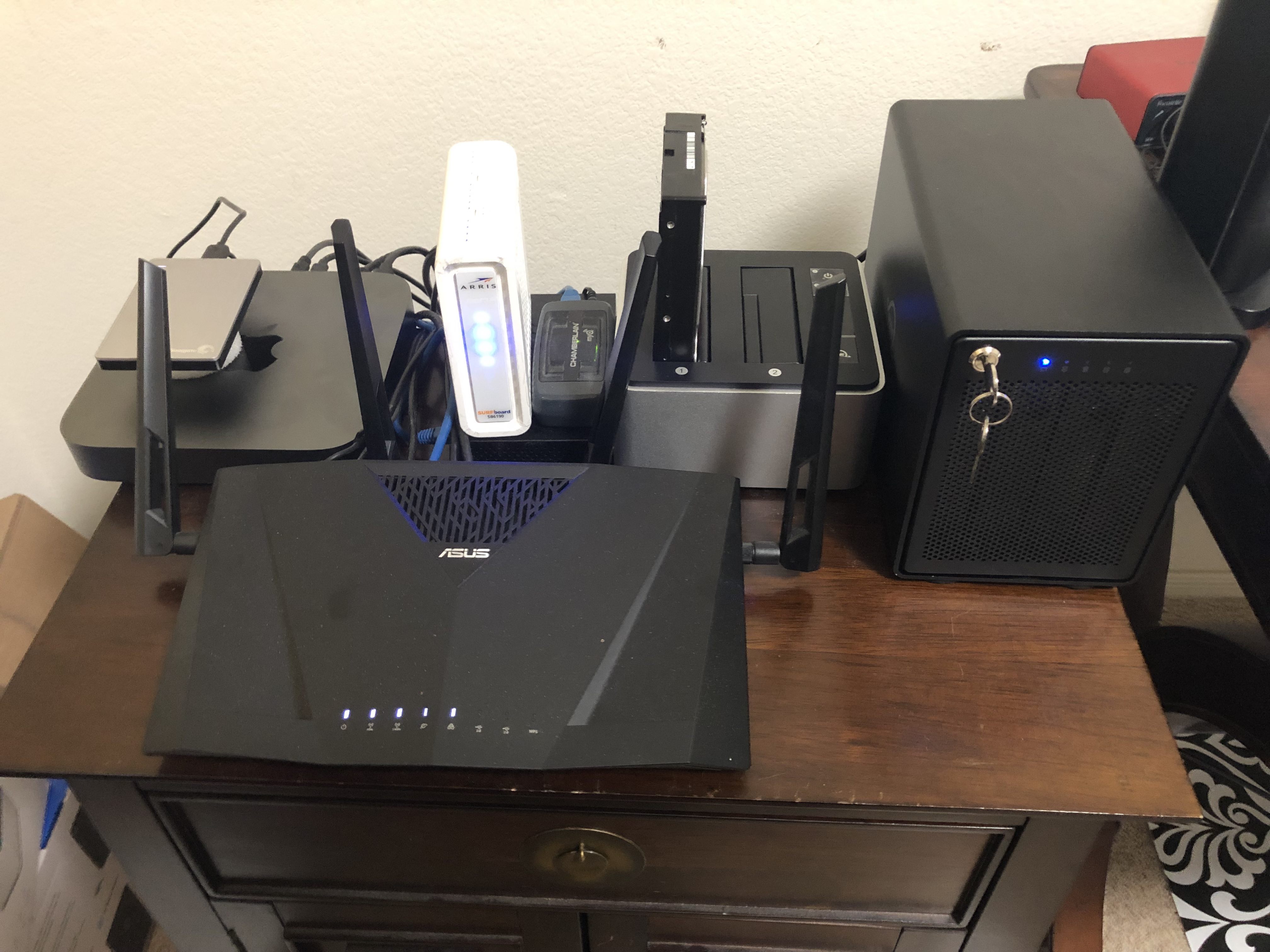

Here is a URL for you on Plex server for MacOS: https://www.plex.tv/media-server-downloads/ . BTW. Here is photograph of my set-up.
Don
