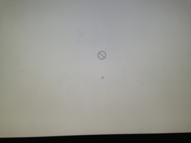

I have Windows 7 on a Bootcamp partition, and ended up running out of space; so I figured I'd us Gparted to resize the partitions.
When I booted GParted off of my disk drive, it wouldn't even let me resize my OSX partition because it didn't recognize the file format...so I shut down and attempted to log into OSX, only to get the prohibitory sign.
I had to use the disk repair utility when I booted into Windows.
I attempted to start OSX in safe mode, but it didn't work.
This is my first Mac computer, and I just bought it a couple weeks ago (new 27")

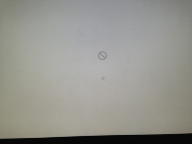

SOMEONE PLEASE HELP! View attachment 393816

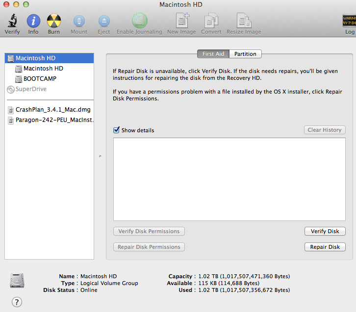

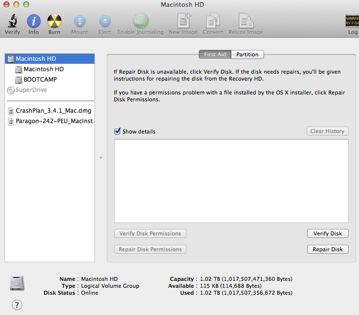

Okay, all I know is that I have the following partitions now:
Macintosh HD: Capacity 1.02TB, 115KB Available
Macintosh HD: Capacity 1.01TB, 975GB Available
BOOTCAMP: Capacity 102GB, 4.25GB Available
I'm very confused at this point, and I just wish I could figure out how to get my hard drive back to the way it was. It used to say that my OSX partition had like over 800GB available, and that made sense because I allocated 100GB to the Bootcamp partition.

Don't have a clue, I'm afraid. GParted probably has no idea how to handle a fusion drive which would explain a lot, but not having one myself I couldn't say how to fix this :(
Don't confuse the disk Macintosh HD: Capacity 1.02TB, 115KB Available
With the partition Macintosh HD: Capacity 1.01TB, 975GB Available
also the hidden recovery partition takes some space...
it could mean the partition tables are borked
have you tried verify disk?
