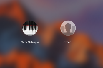

It happened again just now. My Mac closed unexpectedly and my log on and ""Other login" appeared. I turned off guest login. Wonder why "other login" appears?

That the menu is there usually indicates that there is another account you can log into. There are many reasons why that menu might be shown there and there is no quick way to find out why.
If this happens to be the root user, then it is a potential security risk. You can exclude this possibility by opening Directory Utility (just type this into Spotlight) and in the ‘Edit’ menu there should be an option that says ‘Enable root user’. It it states ‘Disable root user’, then you should disable it.
There may be another user account present on your system that you don’t see. This doesn’t have to be unusual, some programs create additional users to manage tasks. For example, MacPorts does this. However, there is also malware that creates accounts, so it is perhaps not a bad idea to find the cause of the problem.
You can get a list of users with the following Terminal command:
Code:
dscl . -list /Users
You can cross-reference it with this list: https://pastebin.com/raw/fTQm1qDA.

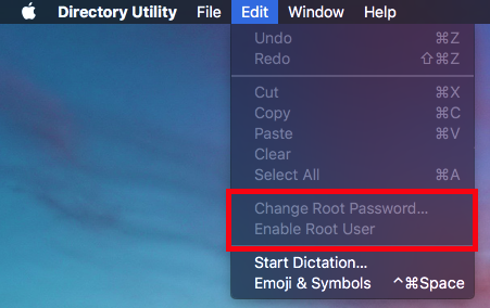

OK, so I went into Directory Utility. In edit "Enable Root User" is not highlighted so I can't open it.
You say: "You can exclude this possibility by opening Directory Utility (just type this into Spotlight) and in the ‘Edit’ menu there should be an option that says ‘Enable root user’. It it states ‘Disable root user’, then you should disable it."
No where do I see "Disable root user".
So that means it is OK, correct?
[doublepost=1496772904][/doublepost]Looks like I am OK with the root user issue, correct?
