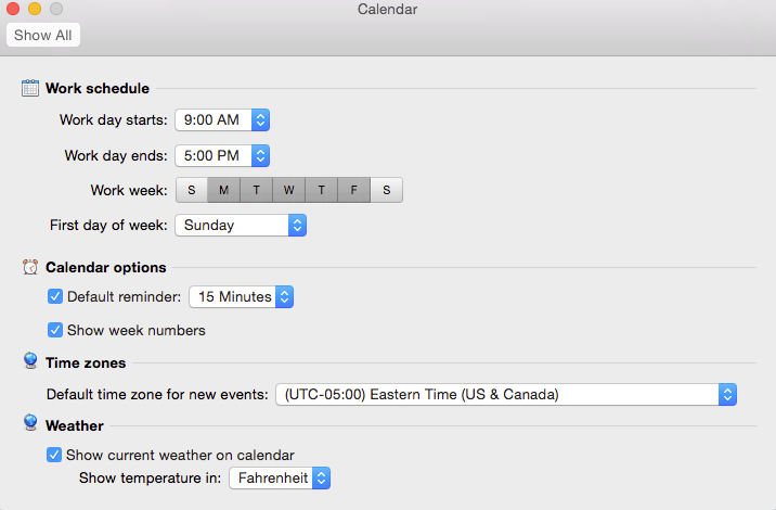

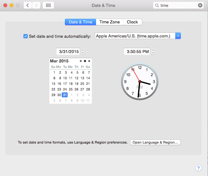

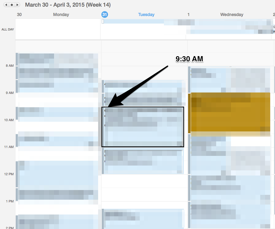

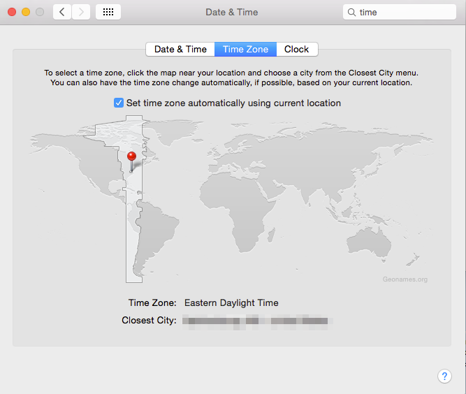

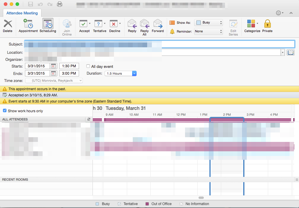

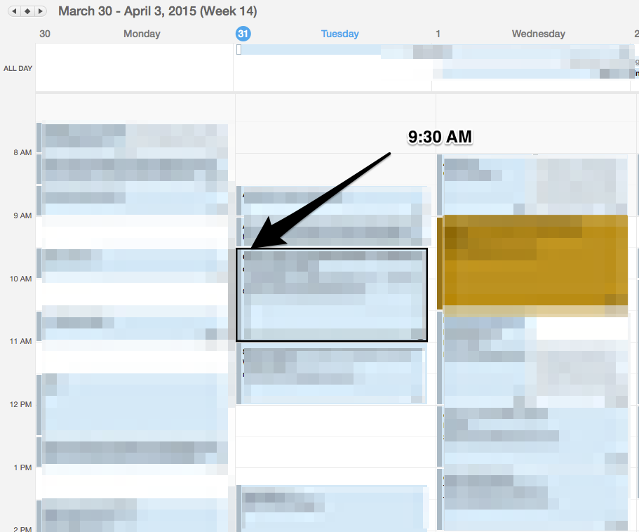

I've been using Outlook 2016 (Outlook for Mac) since it was released not long ago. The version I have installed should be the latest, 15.8.1 (150311). Let me describe my problem.
I have a meeting on my calendar. It took place today March 31st at 9:30 AM EST. Yes, that was the actual time of the meeting. It is showing on my calendar in the week view (same for day view) as 9:30 AM EST on the correct day. This meeting was sent from someone located in the UK and the time for them would be 1:30 PM UTC. I should note that right now it is only a 4 hour difference (not 5 hours) as their daylight savings time takes place on a different day.
So far everything checks out.
When I open the meeting notice it lists the start time as 1:30 PM and end time as 3:00 PM. Below that it says the time zone is UTC. Outlook even gives me a warning that the meeting starts at 9:30 AM in my computer's timezone [See attachment].
I don't understand why Outlook displays the meeting in the scheduled time zone versus mine. Is anyone else having this problem? Any ideas of how to solve this? I've tried searching google and I generally get links related to Outlook 2011. If figured I'd give one of my favorite Mac site's forums a try. I also tried searching here and didn't find anything related.

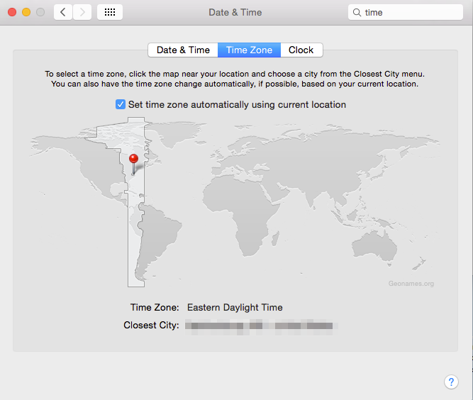

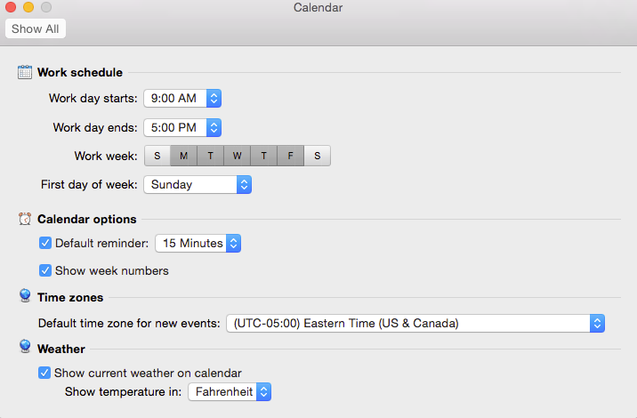

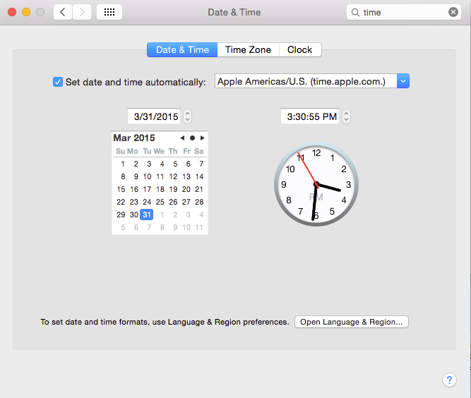

I should also clarify the following facts:
- I all of my meetings scheduled from the UK are displaying this way
- I opened outlook 2011 for Mac and everything is just fine
- I opened outlook on my windows machine and everything is just fine
- I am on OS X 10.10.2

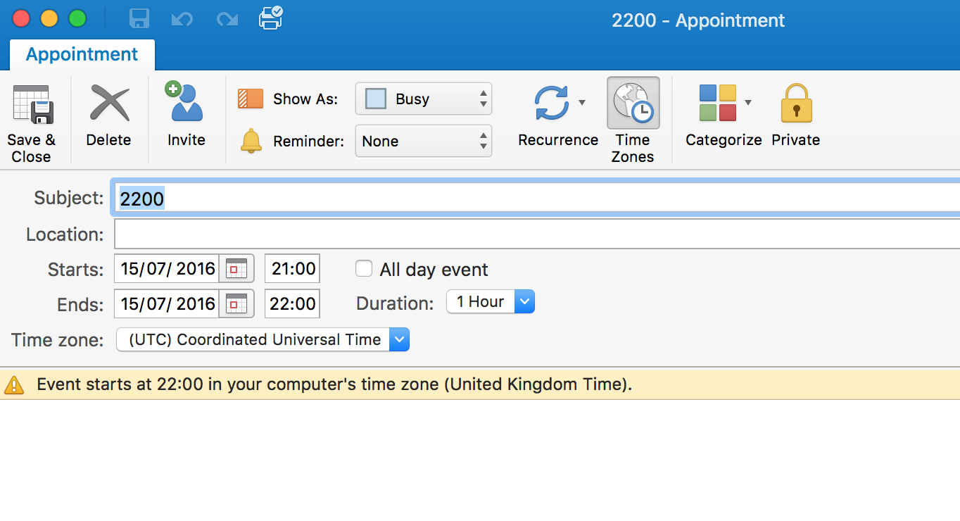

I am seeing the same problem today and have been tackling it since March. I work in the IT Dept for my company and have spent many hours on the issue. This will be a long post so here's the
SHORT VERSION:
- create appointment on the iphone, it shows correctly on the phone and in the "day" view of Outlook 2016 BUT when you open the appointment in Outlook it tells you the appointment starts at a different time.
LONG VERSION
The symptoms are:
·Create appointment on user's iPhone (or user's PA's iPhone in user's calendar)
·The appointment seems to show in Outlook Mac at the correct time (and in OWA)
·When you open the appointment in Outlook Mac it shows the message in the attached screenshot AND changes the time by an hour
·Thus if the user updates or saves it, it changes the time of the apt
·If you create the appointment in Outlook, the Time Zone is UTC Dublin, Edinburgh, Lisbon, London
·If it comes from the phone it always changes to UTC (Coordinated Universal Time) and that seems to be what causes the problem
I cannot replicate on my own iPhone and Mac – mine always works fine.
Here’s what I’ve done so far:
·Reinstalled Mac Office to the latest build 15.24 (was 15.18 – mine is 15.23)
·Updated the iphone to 9.3.2 (Mine is iOS 10 Beta)
·Updated the Mac to 10.11.5 (mine is 10.11.6 Beta)
·Checked the Time Zone settings in
-Outlook Web App
- User's Microsoft Account that Mac Office uses to sign in
·Reconfirmed all the timezone settings are set to UTC Dublin, Edinburgh, Lisbon, London
- On the iPhone (in SETTINGS, GENERAL, DATE & TIME and also in SETTINGS, MAIL, CALENDAR, TIMEZONE OVERRIDE)
- On the Mac
- In Outlook
·Removed the calendar from user's iPhone and resynced it
·I checked my iCloud account to see if there are any Time Zone settings in there – there are, but even when I changed mine I couldn’t replicate the issue
·Checked the built in Mac Calendar (which the user doesn’t use) to see if there were Time Zone settings in there (there are and I turned them on but it made no difference so I turned them off again)
Finally I called Apple who helped but said they believe it to be a bug in Office and gave me a link to this forum and the contact number for MS.
