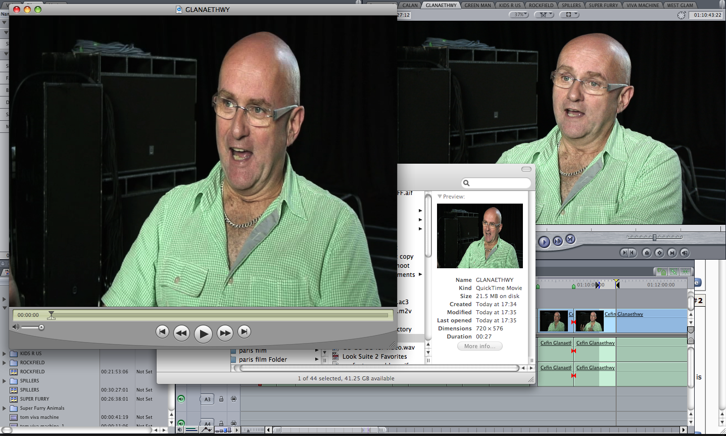

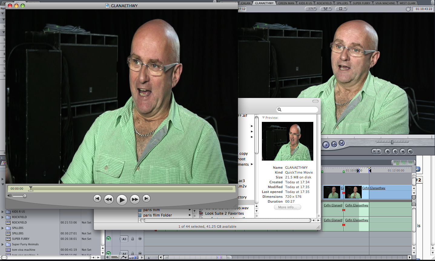

I got a chance to try LethalWolfe's suggestion, but to no avail.
I went: Export > Quicktime Converstion > MPEG4-Video... Then, Size > PAL 720 x 576 4:3 > Preserve Aspect Ratio using (Pulldown menu) > Crop
This is the result:

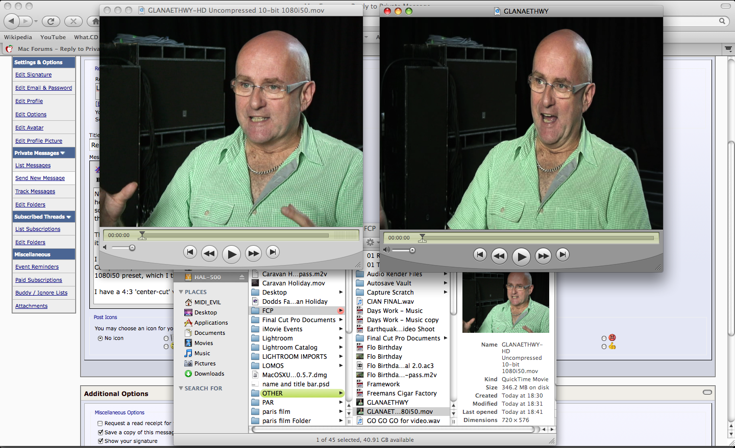

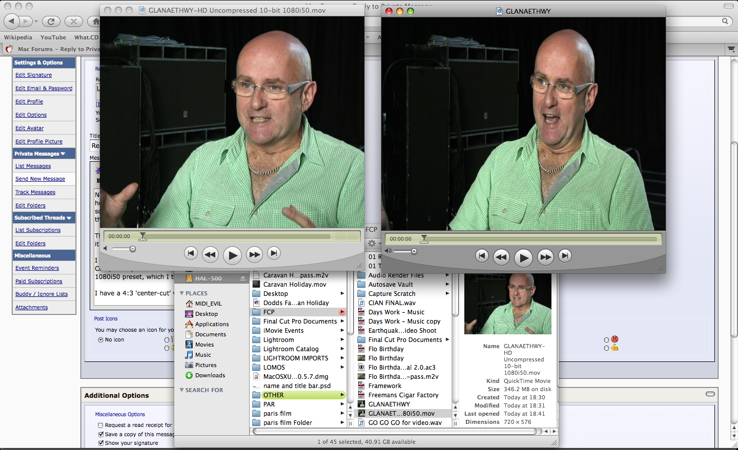

I did it.
I exported some of the timeline from FCP to Compressor, then used the 10-Bit Uncompressed 1080i50 preset, which I then cropped to 4:3...
I have a 4:3 'center-cut' video file.
