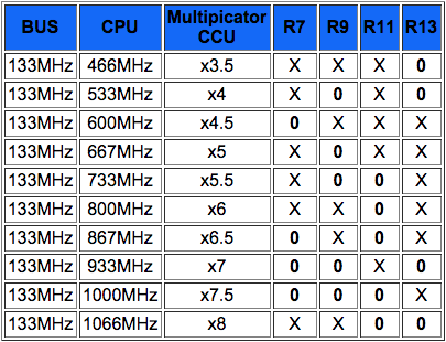

My DA has a 466MHz 7400 G4, not 7410 or 7450. So it may or may not overclock well, right?
Attached is the chart
So I could probably overclock the machine to 533MHz, but not 600MHz or higher, right?
