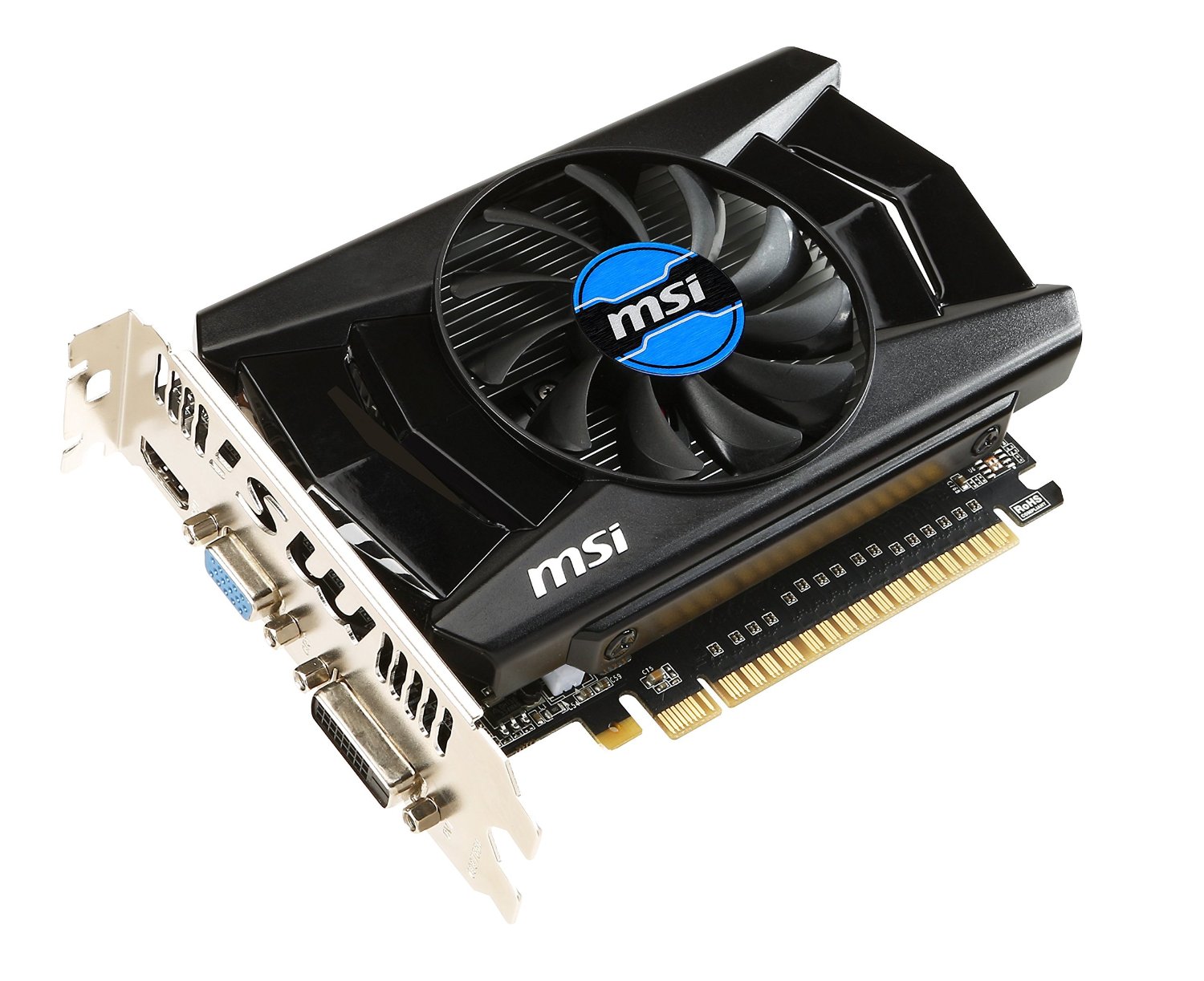

Okay. By the way, the graphics card I might overclock is a desktop card, the GT 740.

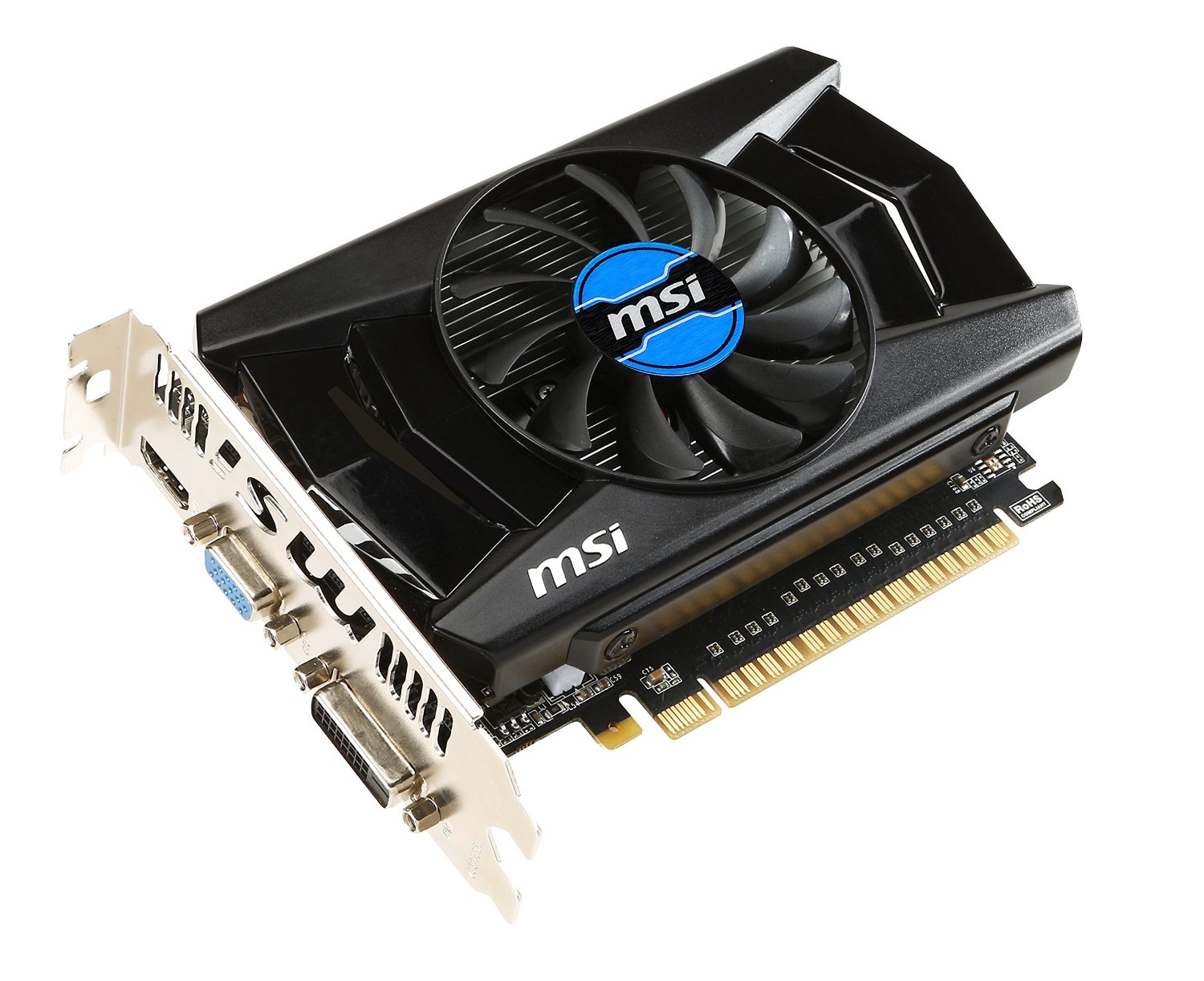

OK then. I am not an expert for that card. However, it's possible if the card is flash-able.

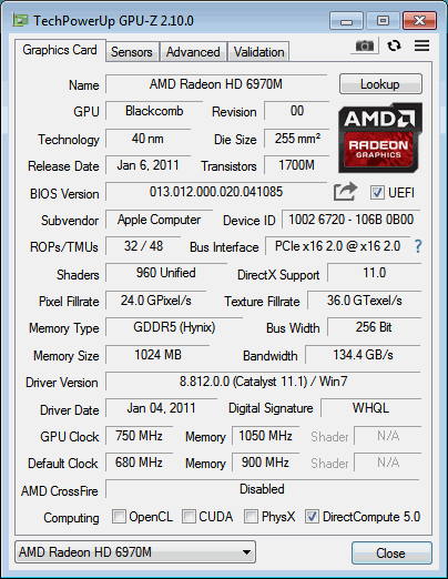

I'm pretty sure I managed to OC my 6970M from 680/900 to 750/1050
I used MSI Afterburner to save the modified bios then used ATIFlash 274 to flash the card (version 284 wouldn't do the trick).
Before doing all that I replaced the thermal paste with MX-4 and got better thermal pads on the memory chips + thermal pads on the adjacent MOSFETS as well.
Also used thermal pads to stick a couple copper shins on the back of the card - not sure if it helps but I had those shins to spare so…
And I have Macs Fan Control on OSX to take care of the temps - past 50C on the GPU and the fan starts to go faster. So far managed to keep temps between 50C-65C.
The thing is: temps to indicate the OC was successful but is there a app similar to GPUZ I can use to verify the GPU's clocks under OSX?
And I couldn't change the voltage at all, does it means I missed something or this particular card doesn't allow voltage mods?
Here's the modded bios I used if anyone's interested (you'll have to change the extension to 'rom' - no quotes):

You mean you OC the GPU in afterburner? Then save the VBIOS?
Or you use another way to mod the dump VBIOS?
For me, it looks like you only OC the card in Windows (via Afterburner), then dump the ROM.
If this is true, then your ROM is NOT OCed.

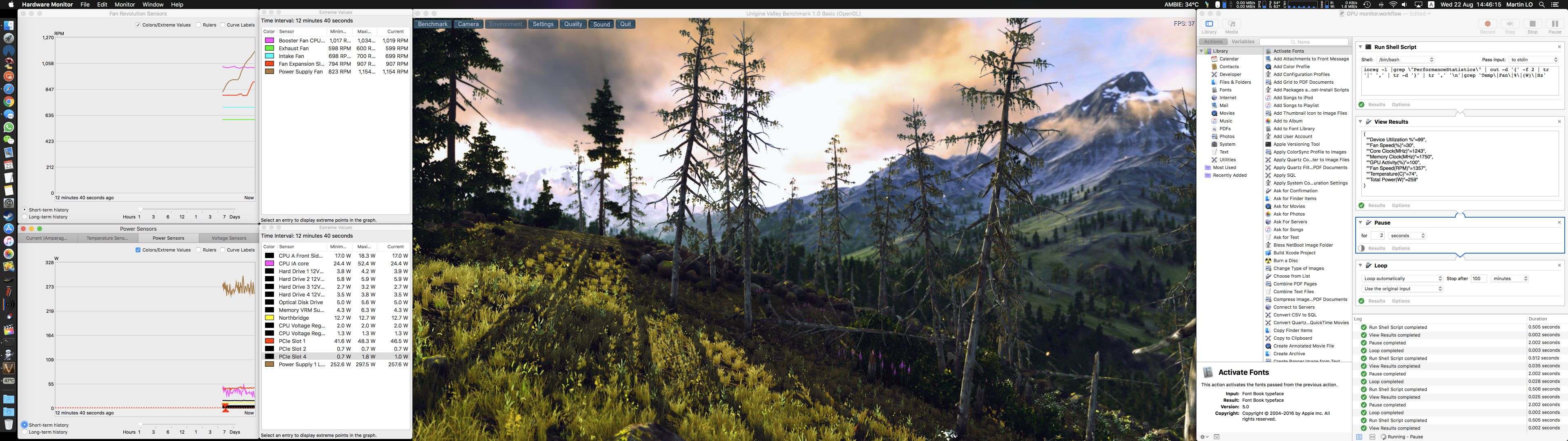

[doublepost=1536804400][/doublepost]Not sure which OS version you use now. But you may try this in terminal
Code:
ioreg -l |grep \"PerformanceStatistics\" | cut -d '{' -f 2 | tr '|' ',' | tr -d '}' | tr ',' '\n'|grep 'Temp\|Fan\|%\|(W)\|Hz'
to monitor the GPU parameter
You can use this command in automator to monitor the GPU. e.g. I make it refresh every 2 seconds.

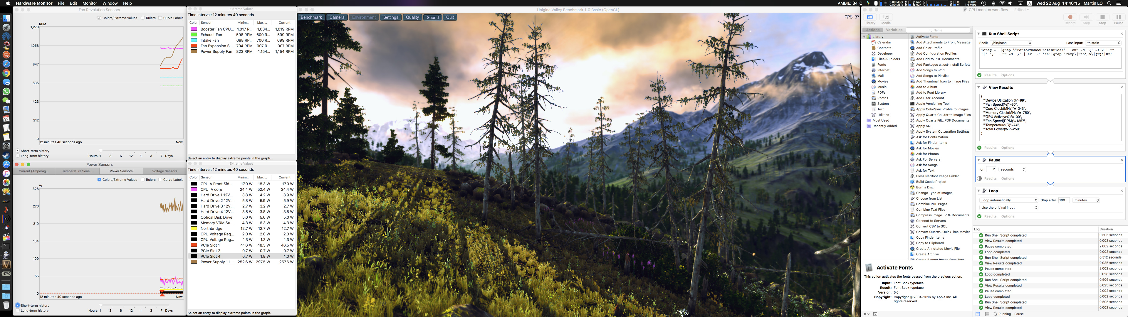

Code:
Thanks for the reply 🙂
I OCed under MSI Afterburner then used GPUZ to dump the bios and ATIFlash to flash the card.
I use MacFansControl under OSX and it shows higher temps so I assumed it went ok.
Then I tried something different just for kicks: underclock it to see what happens.
And after that I only managed to get back to stock clocks, unable to OC again - ATIFlash says 'VBIOS already installed'… Bummer…
Also it seems the vCore is locked, is it possible to change it on this card?
The idea is to OC and undervolt slightly. Read somewhere else this might keep temps at bay…

The card won’t OC in MacOS because of that.
That “higher temperature” most likely just a coincidence after your first attempt, not really because the GPU is OCed.
Afterburner CANNOT alter the VBIOS. IF it can alter the VBIOS, when a user accidentally set some "wrong" (or extreme) parameter cause a crash, the computer will never able to boot again (because those "wrong" parameter already written into the VBIOS, and the GPU will go direct back to that "crash state" on the next boot. Therefore, Afterburner won't (and cannot) write the VBIOS.
So, as long as it won't alter the VBIOS, no matter what you set in Afterburner. When you dump the ROM, you are always dumping the original unmodded VBIOS.
