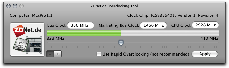

In the article it says the program is "boot proof". Does that mean you'll have to under clock it through the program? I brought it back to normal settings because I didn't wanna screw up my Mac Pro 🙂.
"boot proof" only applies to a warm reboot without shutting down or turning off the machine. After a power off, your Mac Pro will always run at stock speed until you run ZDNet Clock again.

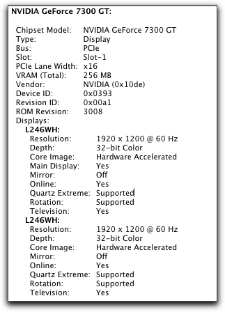

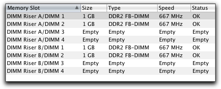

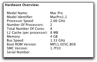

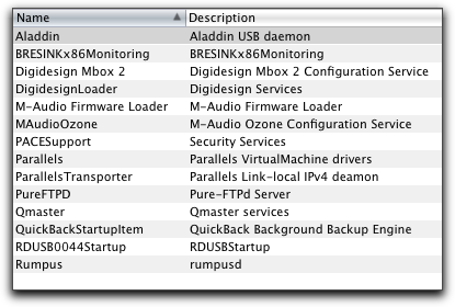

But the good news is that the ZDNet utility works well! I've got a MacPro 1.1 I've upgraded to with a pair of X5355 quads. Here's some system specs:
Additionally I was streaming The Alex Jones Show and running Hardware Monitor with a large window graphing 25 or 30 sensor states. The ZDNet OverClocker looked like this on my system:

Me thinks PhotoShop is not very good for profiling CPUs. 😉 The speed bar in ZDNet OC changed from green to yellow at 2.968 GHz (2.97 GHz) thus the colors in the list above. I guess farther up it turns red but I didn't go there! 😱
