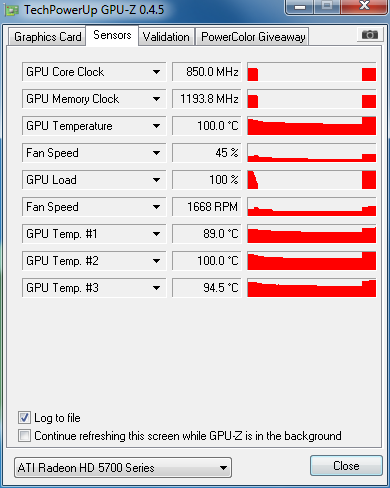

About the temp, it's at least to my limited knowledge about new gpu's really high 🙁
100C is about 212F - Way to hi. The GPU fan is runnit a bit slow also imho.
Anyone else has two 5770 and experience the same issue.
Yes - Crossfire works fine, Im getting about 2x performance in 3Dmark etc 🙂
Your GPU fan shouldn't be running at only 45% with a 100% load on it. Something is messed up there.
You should be able to adjust the fan speed in the Catalyst Control Center though. You can (if memory serves me correctly) set up a 2D profile and a 3D profile, so that when the card enters 3D mode, the fan setting you have designated for 3D mode will start.
I totally agree with you. Im not sure its 100% load but it must be dam close. Normally the GPU fan's sound like a Boeing taking off while at 100% load.
CCC has disabled the Performance section in the drivers for the Mac 5770 (the only reason i can think of) - Im almost sure the same situation existed in my XT1900 card but was "sorted" after a while with new catalyst drivers. That suxx as I cant run the fans manually at 100% or lover the clock or similar to decrease heat issues.
Assuming your ambient temps are reasonable, perhaps you have a bad card... perhaps the TIM was incorrectly applied, the heat sink isn't installed properly, the fan or fan controller is bunged, or it's just running way too hot.
Yea, Im going to swap them to use the other one as the "master" to see If I get the same temperature. Also going try just one card. If one of the card is malfunctioning that would be the easiest thing to fix — just have to call Apple.
But if it's a construction problem I don't believe apple will do anything to fix it quickly. 😕
