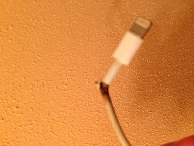

From what I gather, the genius offered to replace the cable but he refused (need it for "evidence"), probably since he wanted a new phone.

Without seeing the actual kernel panic, we cannot make a decision as to what went wrong - that is exactly what the log is for. A kernel panic itself won't cause any damage. A kernel panic is basically the kernel (low level software on the phone) saying "Hey, something's gone wrong that we can't recover from, so we're going to instantly die". It's basically like a blue screen on Windows. If you give us a photo of the kernel panic log, we can tell you more.

Given where the case of the cable has melted, my 2c (based on seeing something similar to this in the past) is just a dodgy/poor solder point on the cable. If the solder point is bad (could be a manufacturing defect, or just down to being an old cable (pulling in and out over time will loosen the connection)), it causes the width of the connection (cable wise) to be incredibly thin. Putting the same amount of power through an incredibly thin piece of wire (or solder point) will cause excessive heat. This could then result in erratic voltage being supplied to the phone, which could cause the PMU driver to crash (and thus the kernel panic you received - driver crash = instant panic).
If the phone is working fine, I don't see why you want a new phone. If you can show us the kernel panic log, we can give you a bit more of an insight as to what happened.

The cable doesn't work anymore. The phone went from unresponsive to intermittently shutting off. When charging it will appear in the red, but then it jumps to 45% and turns on then shuts off. Do I want them to replace the phone? If it's the cables fault, yes. PSA was for apple confirming twice that kernel panics, that happen often, will cause wires to melt which is crazy. Just want them to take ownership for misinformation. It was just that it seems this was just said to blame the phone instead of the wire. I guess I'm the only one that would be upset that I'm being fed false info to place blame on a kernel panic. Maybe people like you can take that info and just walk away, but since you say "we" like you work for the Genius Bar, I wouldn't be surprised. You guys need to be educated and reeducated. Get your act together seriously. Tech support that doesn't understand what kernel panics should have no place makin decisions in anything tech. Read your own manuals for God sakes.

I actually had something similar to my cable a few months back. I had my iPhone 5 since launch and used the same cable to charge it every night. Well just below the connector there is a little piece of overlapping plastic, used to prevent the cable from being bent sharply, but surprise surprise, it still happens. At this point on my cable, you could feel the wires gradually getting weaker to the point the phone stopped charging one day unless the cable was angled just right. Well one day I put my phone on to charge, went out for a bit, and came back to the strong smell of burning plastic, as well as a burn on the cable itself at this point. Naturally, Apple swapped it out with no problems, but still, being that it's electrical, shorts can happen. Your case is different from mine, I just felt this was the appropriate place to put this.

Highly doubt a phone problem could damage the wire unless it is physical problem with the pins at the iPhone end. Power only travels in one direction. While I'm not an engineer I suspect the 'genius' is not quite correct.
[doublepost=1496182893][/doublepost]I threw in the towel early, no time to ******** with customer service reps from Apple about my iPhone 6s. AT&T referred me to an iPhone repair shop. The guy says that my charging cable shorted it out. He is going to check if it is the charging port, the battery, or the motherboard. I told him to go ahead and fix it if its not the motherboard. Should be under 200. It needed a new battery anyways. I already bought an iPhone 7 but the s6 will make a nice gift if they can fix it!
