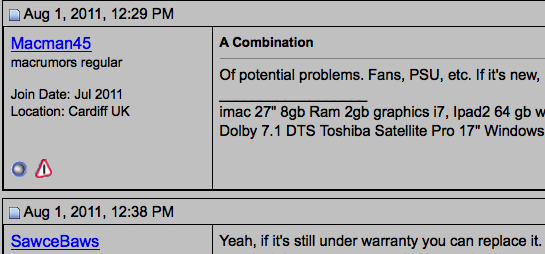

A Combination
Of potential problems. Fans, PSU, etc. If it's new, its a no brainer, return and replace.
Yeah, if it's still under warranty you can replace it. They'll probably end up giving you a low end 2011 i5 Model if you're lucky. I *think* if you don't have warranty you'd have to just buy a new computer, don't think it's fixable. Don't quote me on that though, i'm just thinking out loud.

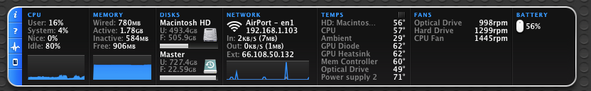

I've been mixing some music in Ableton Live on mine. Here's how hot its getting

Wow!!!! Your iMac's internal temps are much higher. Your iMac's internal fan speeds are much lower. re: Compare iStats Pro of my iMac against your iMac. I would agree. Your iMac is running hot. Especially its Power Supply and internal HD comparisons.
As a suggestion, remove its memory cover (located at bottom of screen - to allow more air entry) & install 3rd party fan control software (like SMC Fan control) and "turn up" the fan speeds. For example http://i178.photobucket.com/albums/w251/Spike99-Pictures/New iMac system/FanSpeedJune25-2011.png
Works for my iMac (that is same size / model as yours).
