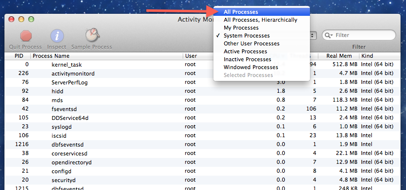

Hi Chazz
I recommend you to take a look at the Activity Monitor (just type it in in spotlight)
  • Make sure you set it to show "All Processes"
  • order them by CPU (click on the column)
probably you will see the process which is heating up your mac (a blind guess would be, that it could be spotlight --> mdworker)
