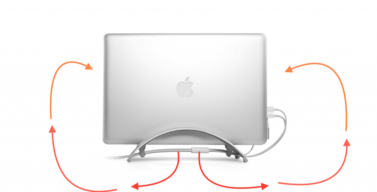

I have a question regarding the BookArc and i don't think it deserves its own thread.
Do many people use the BookArc? and if you reply please state if you use/used a BookArc.
Isn't the BookArc a total construction failure?
The Macbook has the air intakes on the side and the hot air goes out through the Display Hinge.
Doesn't this stress the Macbook more than normal, because hot air travels up and if you use the BookArc and Macbook in the correct orientation (like in the marketing photos) it works against the thermal design of Apple?
Cant we use it upside down? As in the Mac.
Reactions: sauria and bhodinut
You could, except with the Macbook Air insert.
If you use it as designed (apple logo in correct orientation), the bookArc design works against the thermal design of the macbook. Atleast thats what i think will happen:

Late to the thread. I've used this device for four plus years. I edit video almost every day, and yes, the fans run as designed. I use it UPSIDE down, so the heat can leave normally.
Ignore the stupid Marketing images. It makes NO SENSE to use it with the vents facing down.

Great advice, seems better this way on the 2019 MBP 16" -- no blocked vent areas this way.

I would say that area on a MBP has always gotten incredibly hot (at least my 2009 did as well) I've been using the book arc on 16" for about seven months. I do video rendering in Adobe Premiere frequently get an intense workload running for renders that last over an hour. Definitely gets quite hot, per usual under heavy loads in general, but everything fine so far. Can't say the degree to which the MBP throttles the CPU vs if it was flat and open, but certainly churns out the renders.
This makes no sense. How is the BookArc blocking the vents? There are are only two points of contact with the hinge vent and each are less than .5 inches. The rest of the vent is wide open, and whenever I place my hand under it I feel free-flowing warm air (or hot air, when the processor is working really hard).
Plus, placing the MacBook Pro "upside down" not only makes the cable connections ergonomically difficult, but also ugly as hell.
