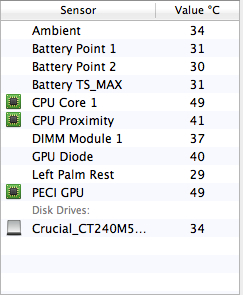

Similar problem here on my MBP mid 2012, i am using Macs Fan Control to monitor temps, and on all versions of Yosemite Beta i could see a 10 degree jump in temperature under idle.
Have not tried beta 5 yet to see if the problem is still there.

Sorry my bad, forgot to add Celsius! I live in Europe , where mostly Celsius is used.
These are roughly my regular temps under light usage with Mavericks ( image attached )
Yosemite on the other hand had a bump by 10 degrees Celsius under the same circumstances.
Your OS X 10.9 Mavericks temperatures are well within the limits, the additional 10° C you experience in OS X 10.10 Yosemite are also well within those limits.

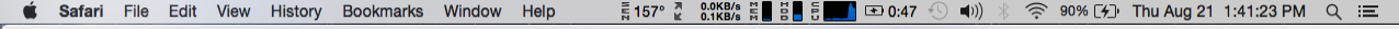

Overheating problem
This never happen before but apple has to solve this problem fast before peoples laptops and desktops start exploding! this is my experience with Yosemite Beta 6. :apple:
Yes, they surely gonna explode with 157° C, which is over 50° C over the limit they are designed for (105° C), but then again, you probably still use that Fahrenheit scale, which then means, that your computer is warm, not hot, as 157° F are a lousy 69.44° C (that is why there is the Dashboard, to convert all those stupid imperial units to logic).
As you haven't read the thread yet, here it comes again: Those Macs in their heat - a sine of over-heating? - a short story by Mister GGJstudios
