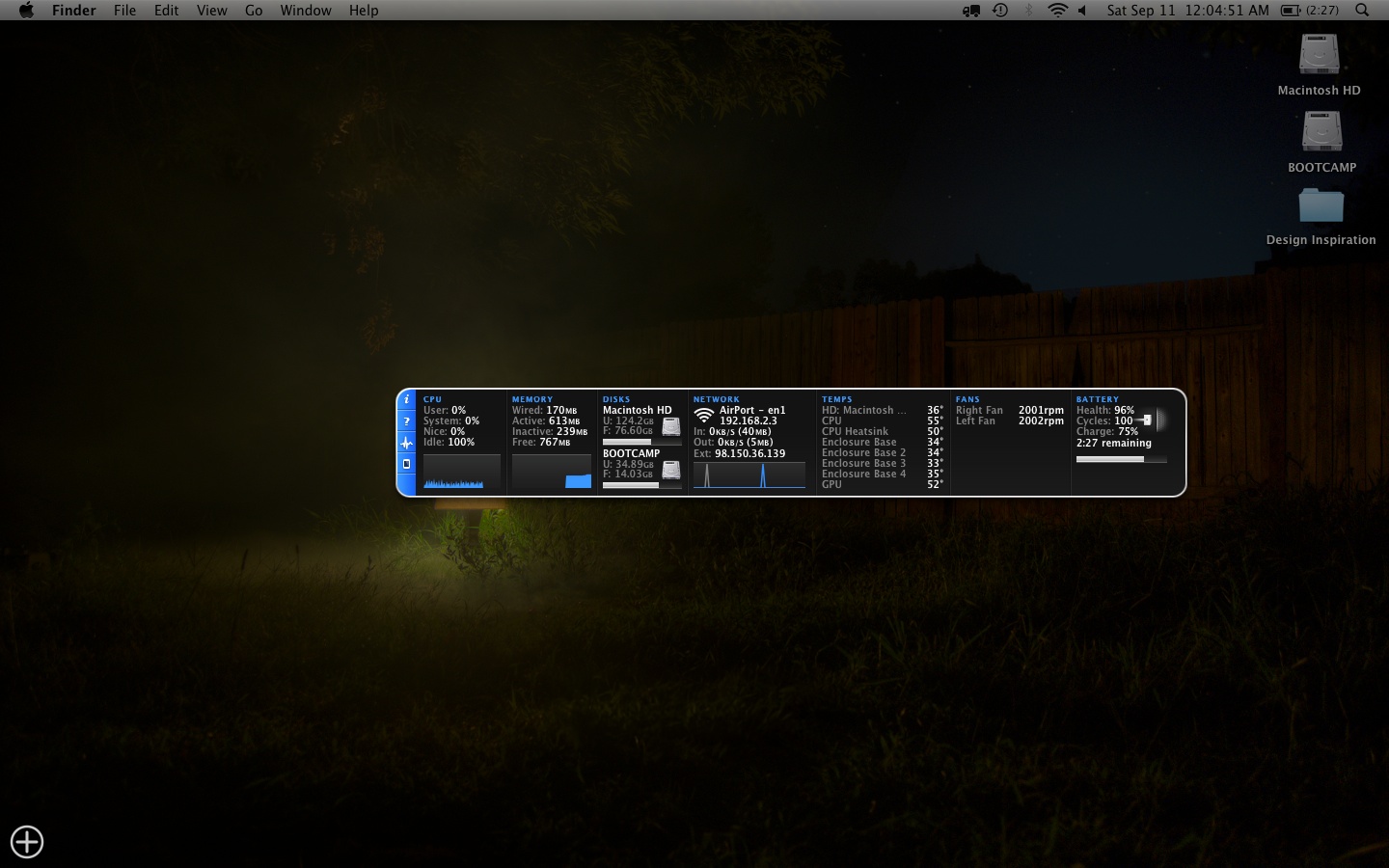

I've attached a screenshot of my iStat Pro results. They seem reasonable?

Thanks for the iStat posting. A couple of questions & comments
- what surface was the Mac on at the time (pillow, desk etc)?
- was the ambient temperature room temp normal (say 20 C / 68-70 F)?
If your Mac was idle on a desk at 20 C ambient I would say your temps are normal to high. My 2009 Core2Duo idles at mid 40s C in similar circumstances - quite a lot cooler, but there is a little variation from machine to machine.
You may have some dust buildup in your fan. Particularly if you use it on bed IMHO it's quite likely. you can try blowing it out with compressed air, or taking the back off and vacuuming it out. Only if you are confident in what you are doing!
Another test you might try is to fully load the CPU in OS X. Easy to do:- just open Terminal, type the following minus the quote characters:- "yes > /dev/null". Hit enter, then hit Ctrl-T to open another Terminal tab, and enter the same text. This will start 2x endless loops, one on each CPU core. You should see the following:- CPU temperature rises over a couple of minutes to a bit over 100 C. Fans stay at 2000 rpm. Then when CPU is around 100 C fans start to rise over a few minutes. CPU might touch 105 C before increasing fan speed slowly brings CPU down to about 95 C. Ultimately fans at about 4000-5000 rpm (depends on model).
If your Mac doesn't show this behaviour, in particular if it shuts down, or if the fan speed is much greater than 5000 rpm, you have a cooling system problem. Dust probably.
A comment on my earlier post about using on a pillow: not much heat escapes through the base, so pillow use should be OK. But your Mac sucks air in through the side ports and Superdrive slot as well as the keyboard. If these are blocked by your pillow cooling might struggle a bit. Worth experimenting with different arrangements?

I think those temperatures are too high - I've read about this in other forums. The fans just wake up too late, and if the computer is doing something really heavy and CPU is at 105 C, the temperature produced by GPU might increase it so much that the computer shuts down.
OP: You can always try to use smcFanControl to get the fans running at higher rpm immediately, but the machine_should_be able to keep itself cool enough. I'd recommend cleaning dust and maybe even reapplying thermal paste - but that might void your warranty.
I think you should try running those tho yes processes and keep the computer on table. Watch temperatures through smcFanControl and see if it shuts down - if it does, you do have a problem with heating.
I can't get my 2010 13" MBP over 90 C with the yes-processes.

In that case your cooling system is probably working just fine.
It would be worth running the yes > /dev/null x 2 test anyway, that will just make sure you don't have a problem. It will only take you 15 mins, you can use the Mac for other things at the same time. Suggest doing the test on a hard surface though.
