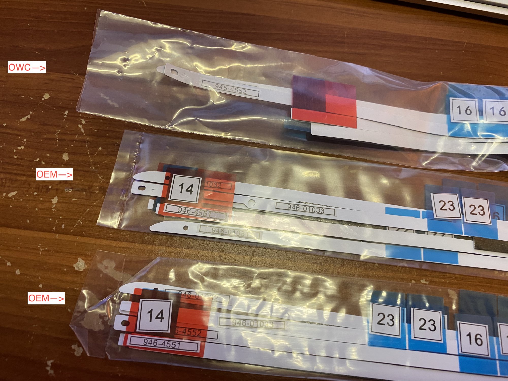

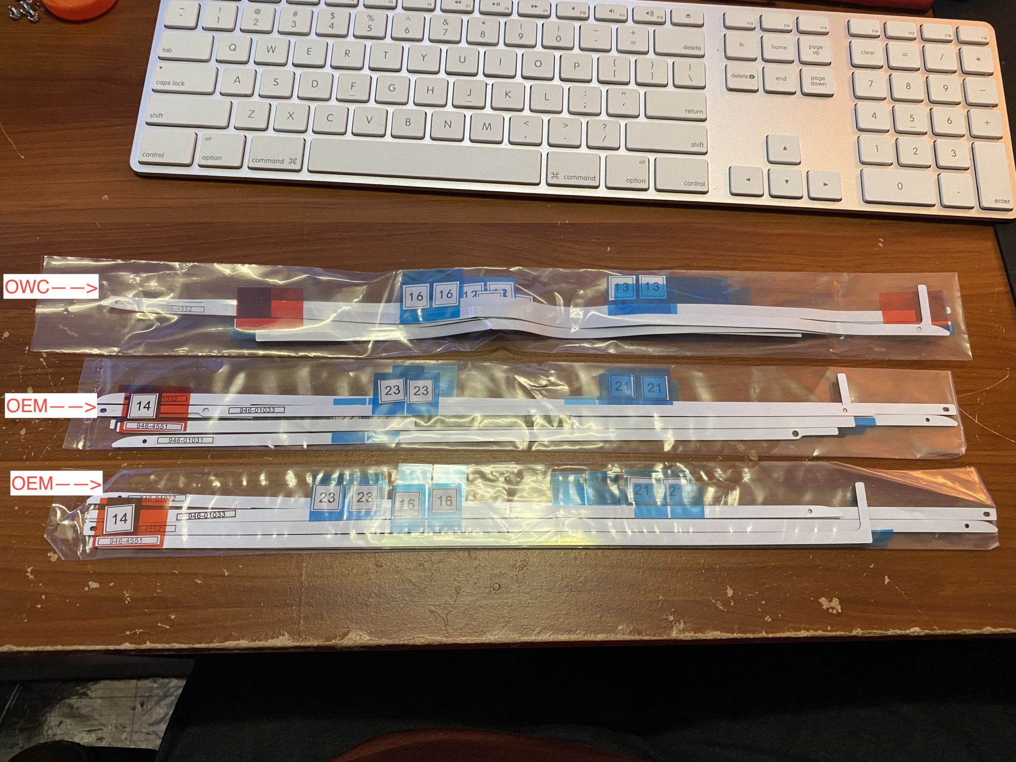

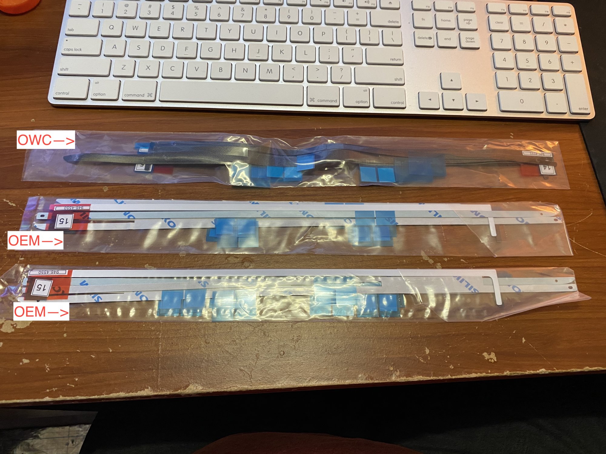

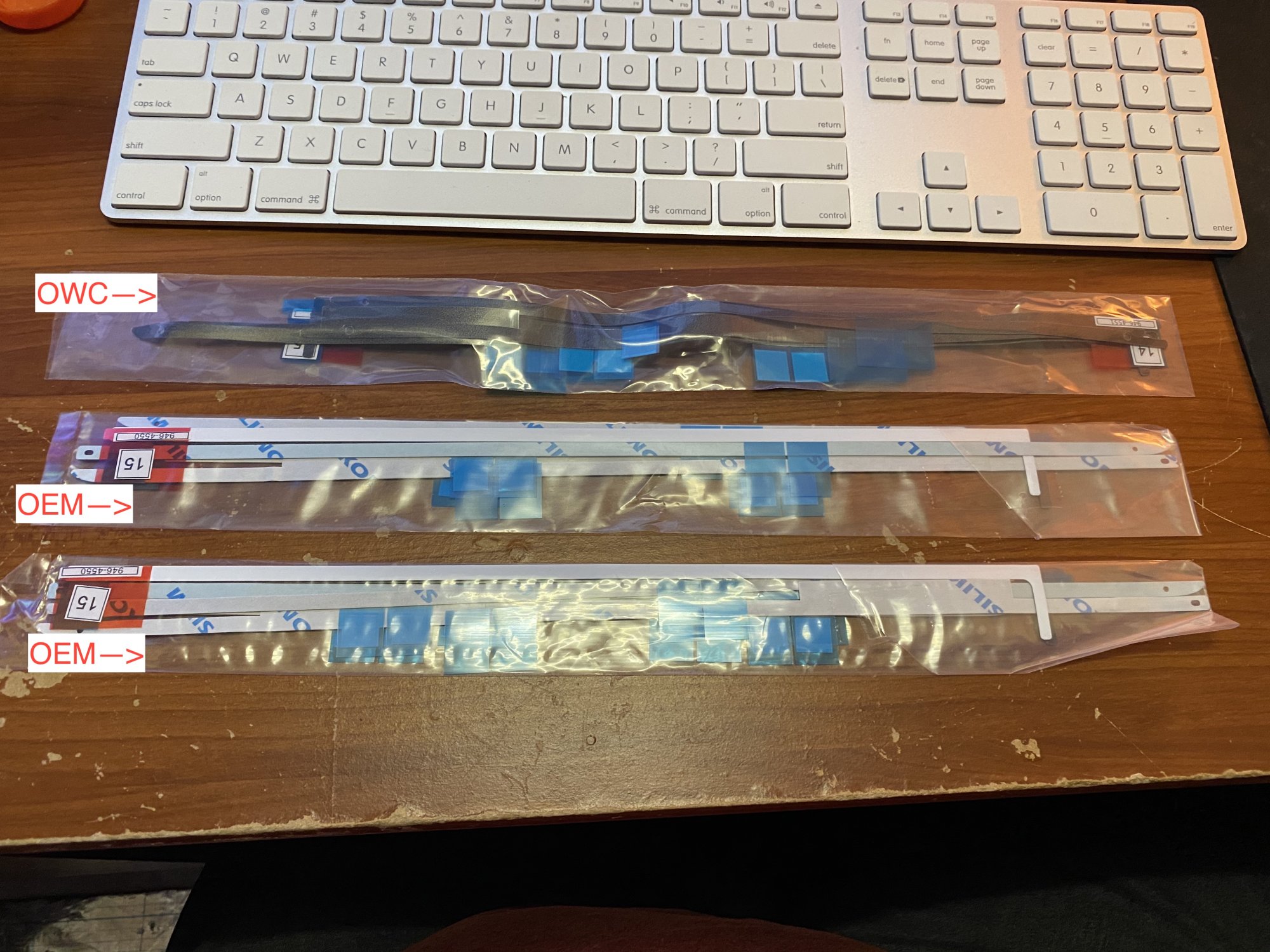

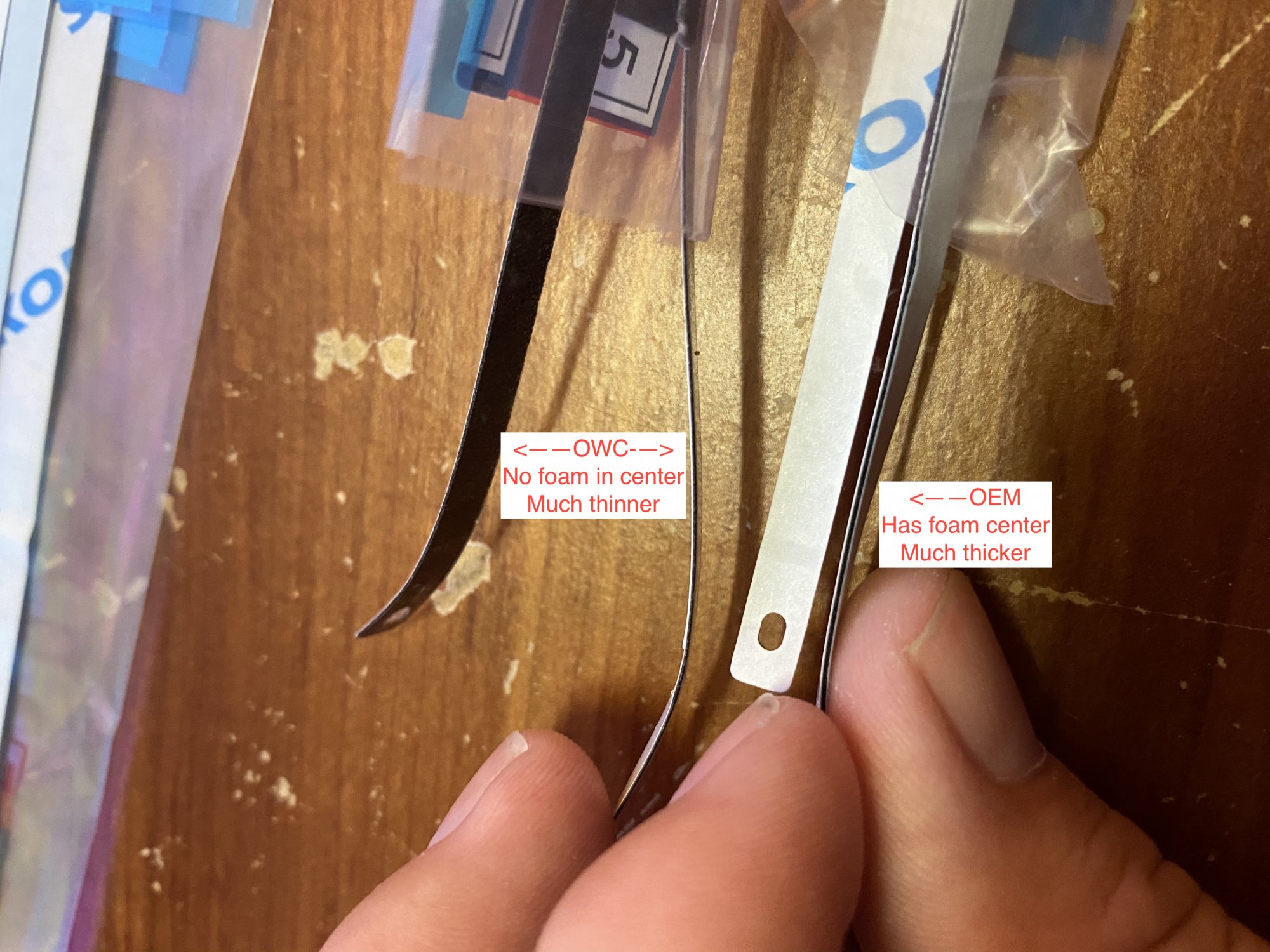

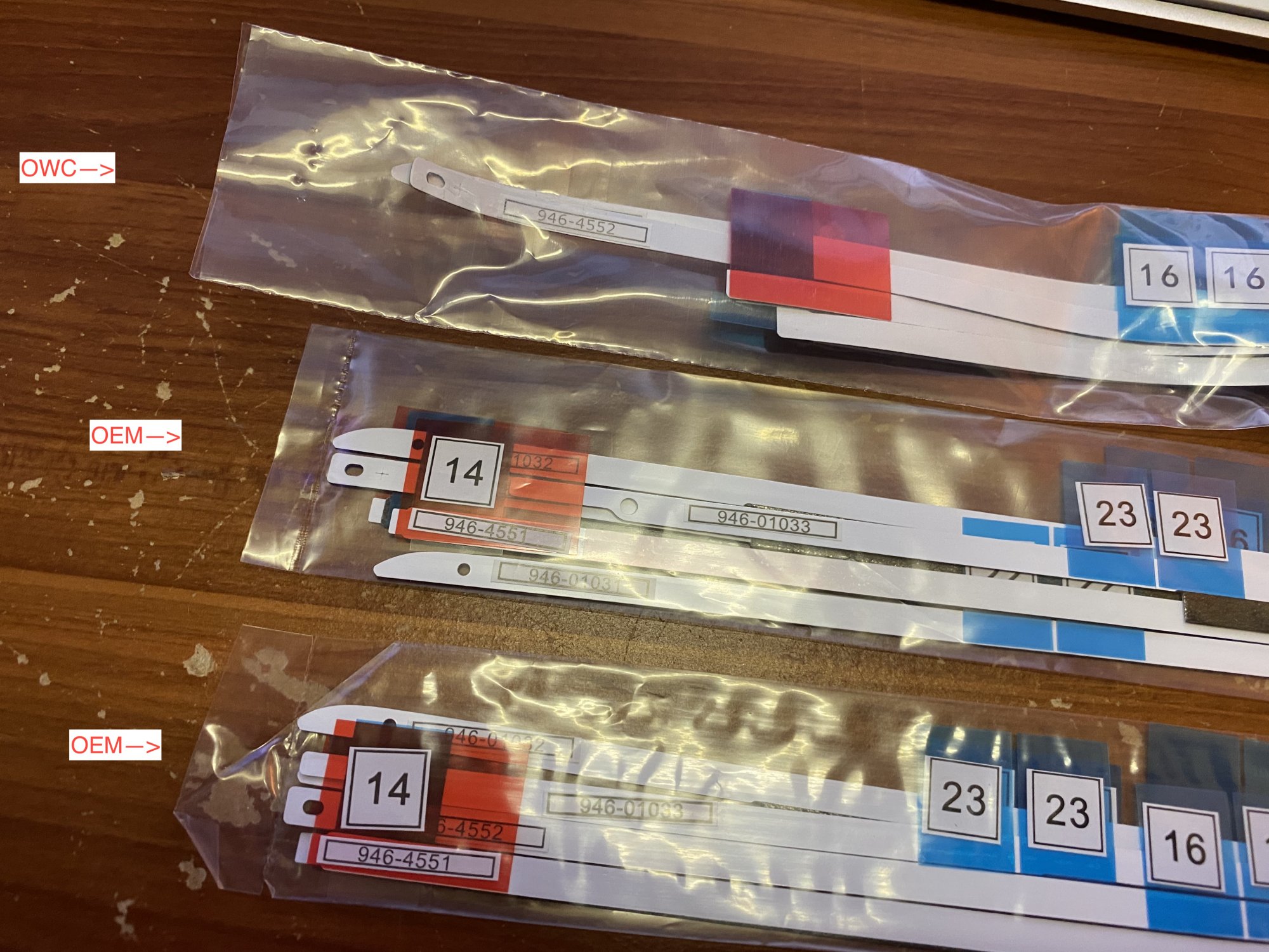

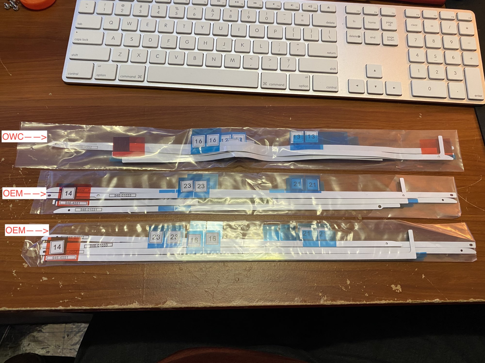

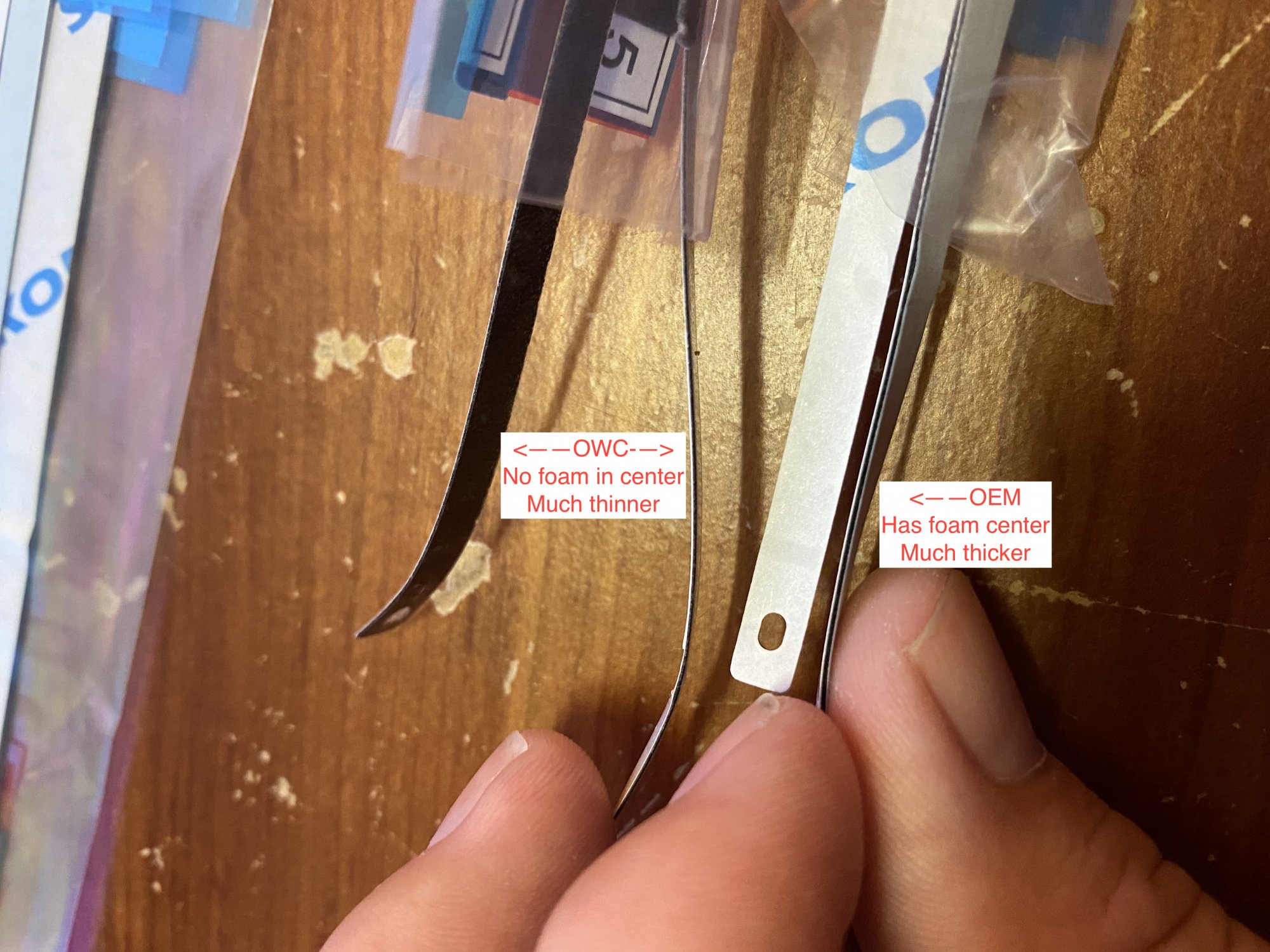

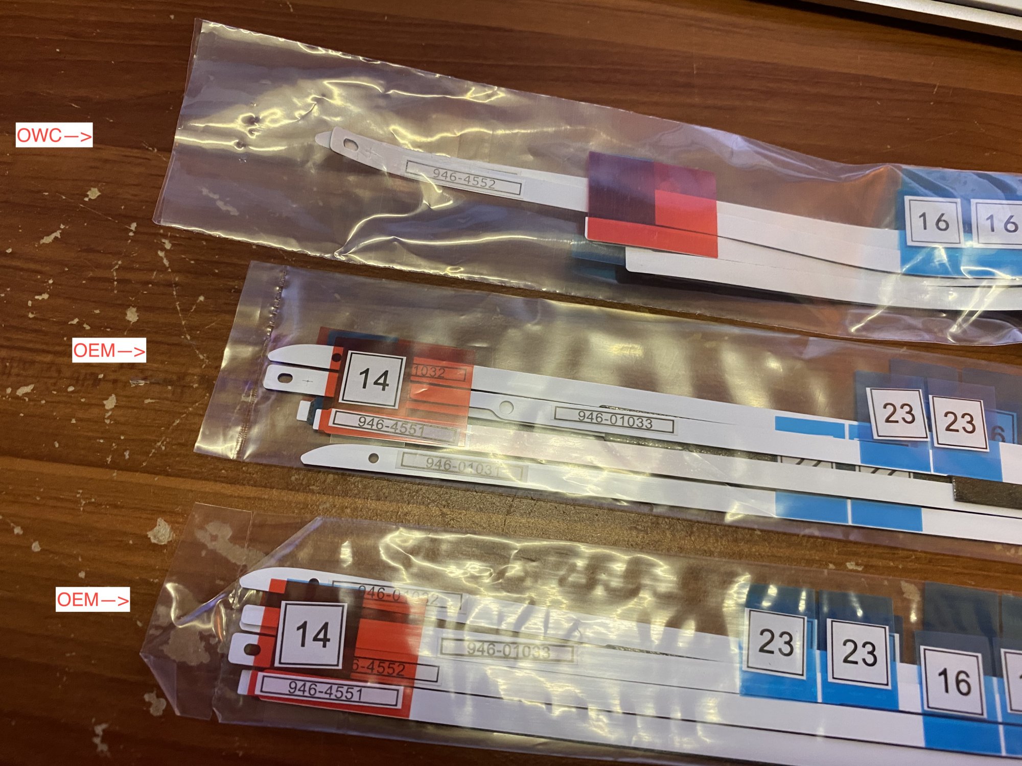

Hello all,
I've been lurking in this site and wanted to share some photos comparing [alleged] OEM screen adhesive strips to the ones offered by OWC.
I have read several horror stories about OWC strips failing after installation, either within a day or even a year. The OWC strips are CLEARLY inferior in quality and I believe the issue is the lack of a "foam" center in-between the adhesive sides. OWC should be ashamed for not fixing their adhesive strips that have cost Mac owners and small businesses that perform upgrades several hundreds of dollars in damage. Since they won't acknowledge the issue to date and chalk up all the iMac screens that fall off to "installer" error, behold the below pictures.
I purchased [alleged] OEM screen strips on eBay from two separate sellers in different parts of the US in hopes to receive an OEM part. The items received are identical in every way including the wrapping. You might not be able to see it in the pictures, but the packaging is higher quality and the manufacturer takes the time to fold over the open end of the bag and tape it shut to prevent the strips from falling out. Additionally, both sellers packed their strips in a rigid FedEx envelope to ensure the strips don't bend.

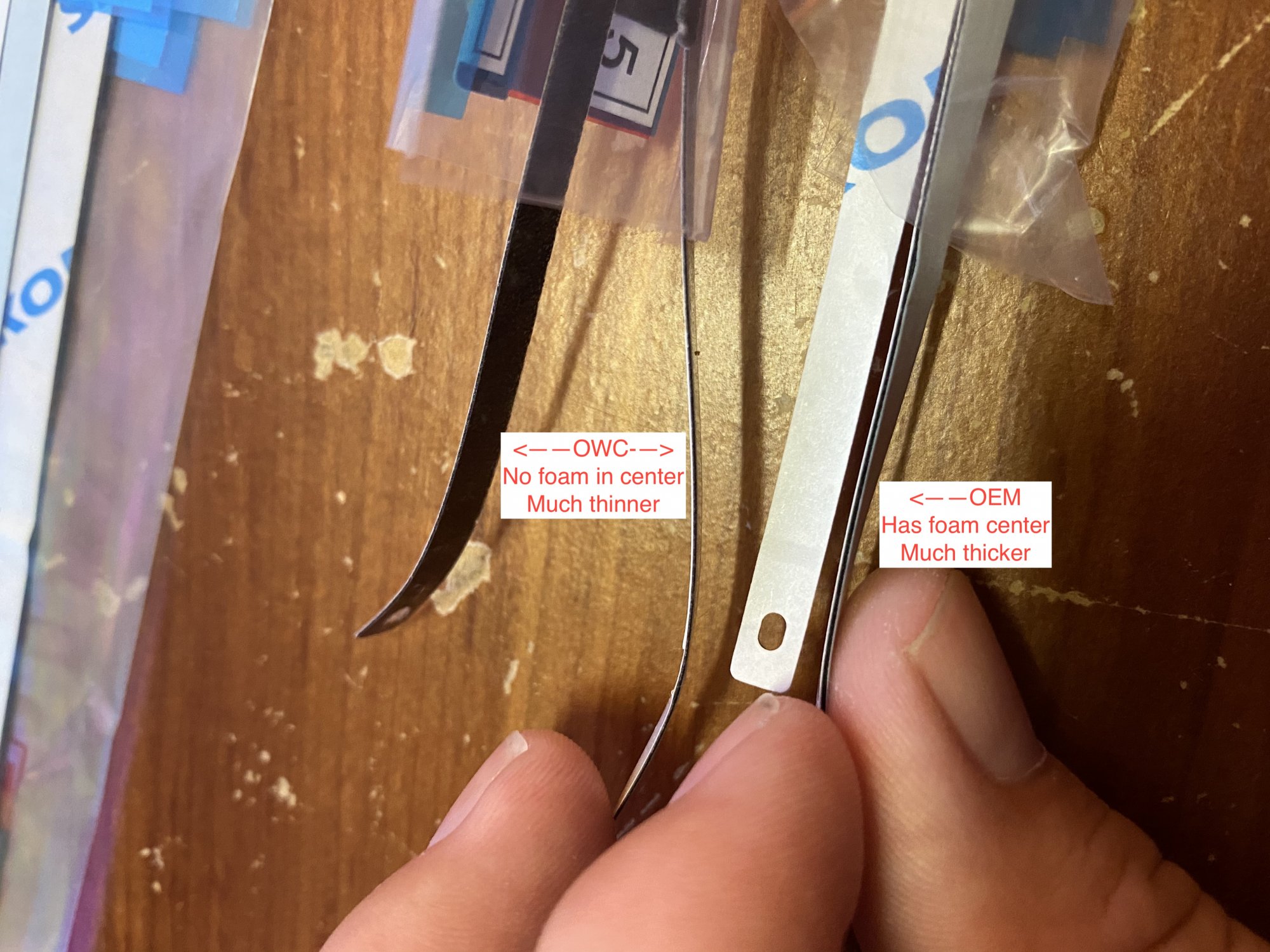

The OWC screens trips came folded up in a small box. The adhesive strips did not have the end of their bag folded over and taped closed, though the strips weren't exactly easy to remove from the packaging. The packaging for the OWC strips is shorter by approximately 4 inches due to the lack of a fold.
It's hard to tell by the picture as well, but the OWC screen adhesive strips are much thinner than the OEM ones and I believe the strips fail to retain the screen not because of the adhesive, but because of the lack of ability to contact both surfaces fully due to the thinness of the strips.
I am not here to represent a company but because I'd like to provide info that nobody else has really done on Reddit or here, if they have it's buried in threads with dozens of pages. I hope this helps anybody doing an upgrade on one of their 27" iMacs out!

View attachment 936485View attachment 936486View attachment 936487View attachment 936488From where can I purchase original adhesive with foam center? Any link or store?
I bought the foam ones off eBay. The official Apple P/N for the 27” Mac is: 076-00009. I don’t want to Link to any specific seller but I paid approx $5.49 and $8.49 each (I bought from two different sellers). Look at the rating of the sellers and ensure you buy the correct strips for your model and year.
Don’t buy OEM equivalent and make sure that the item you receive has foam in between both sides of adhesive and is not plastic thin.

I work for an independent service centre so here's a gist.
Although OEM means original equipment manufacturer and should be original, in the industry, especially in countries outside of US, sellers usually use OEM to mean third-party.
The OEM one that poster bought is actually original from Apple (there's a blue logo behind the strips). As far as I know, there are only 2 sellers on ebay (tecknic-lee, macpremiumparts) that sells original Apple iMac adhesives. They are the kinds that come as service parts for Apple Genius Bars and Authorised Service Providers.
These come in a brown box with the iconic green transparent seal, with the original white Apple cutter and 20 wheels.
The third-party ones which the market likes to call OEM can actually be extremely sticky, but the QC and quality varies. Some all so non-sticky that your LCD will drop off. Others are extremely sticky.
The bad thing is once you stick back the LCD, it is extremely hard to remove as it is a single layered tape.
OWC, iFixit, both sells adhesives without foam in the middle.
There are also third-party OEM factory tape (not by Apple) adhesives with foam in the middle. The difference between these so-called OEM factory ones and Apple, is that Apple uses tape that has several layers.
Original Apple tape: Has a thin layer, double-foamed, has adhesive on both sides, and is non-stretch. The thin layer allows you to peel off the entire adhesive without breakage and the foam allows the cutting wheel to slice through easily for removal.
OEM Foam Factory tape: Single foamed, adhesive on both sides, but stretches. The foam allows the cutting wheel to slice through easily as well, but harder to peel off in one piece should you need to remove the LCD again.
With both original and good quality third-party (you can tell by testing the stickiness with your finger), there is no need to clamp. As long as you press down hard and slide your fingers across the top, sides, AND bottom, there's no risk that the LCD will fall off. Just don't press too hard until you crack the glass.
I will attach photos once the original boxed one of 20 pcs arrives!
